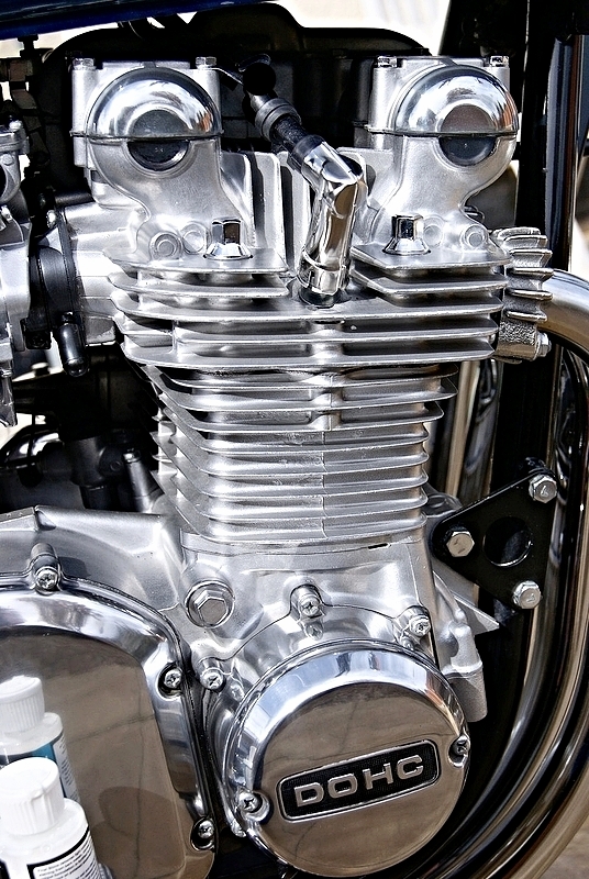

My Z650 engine ws done by Steve Smethurst nearly 10 years ago and still looks like new. He also does carbs.
He ain't cheap !!

steve smethurst.wont use anyone else.first class

+1 for Steve Smethurst - after years of use (including some winter jaunts) - the finish is still perfect. :up

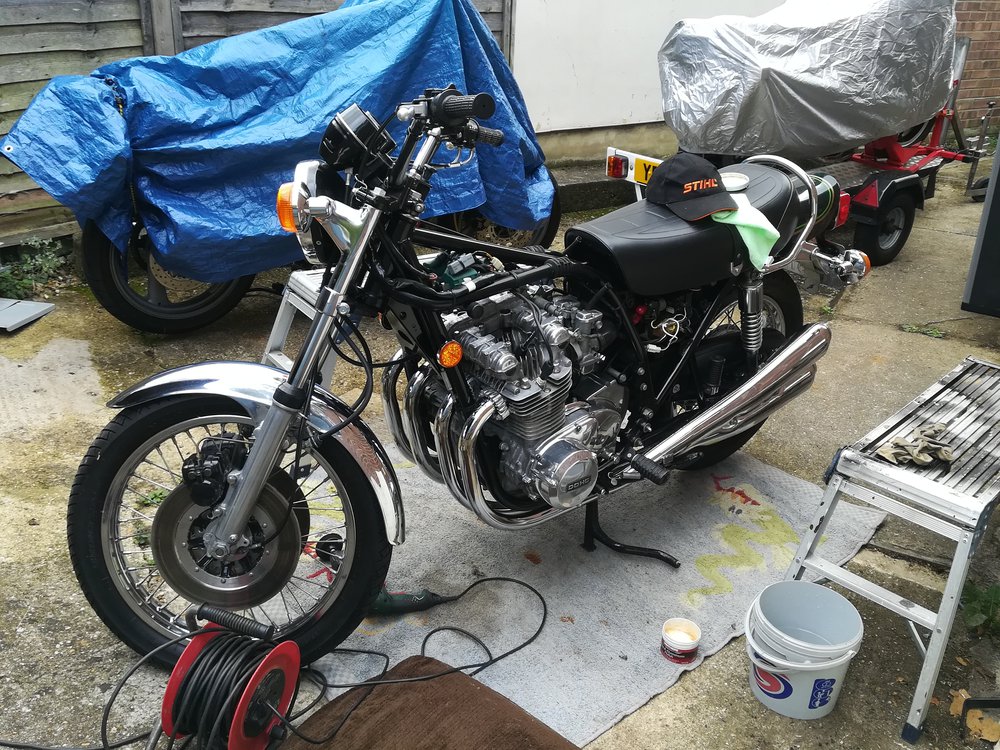

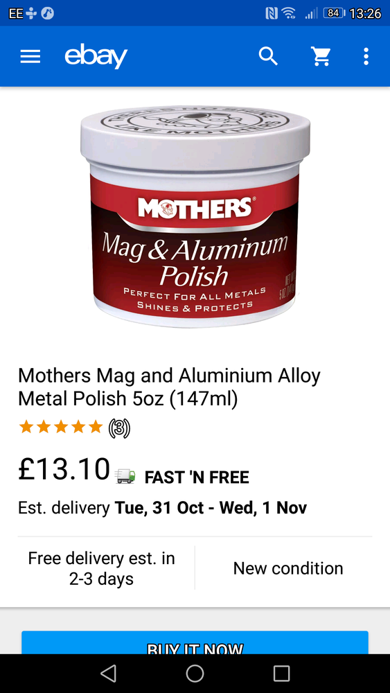

That sounds like tinnie talk... Get the beers in, and your be surprised who turns up.. :lol: but... Mothers mag & aluminium Polish, Is better.. I used it on my zed, day before the show, electric drill with polishing mop, and a bucket if water.. Job done.. Smells nicer... Pissssted you can use it on chrome too..

Thanks mate , shes looking sweet !!! Will give that stuff a go !!!!

Steve Smethurst did my casings 11 yrs ago and still look mint but only use bike on dry days, beware, clean casings with plenty of hot soapy water and blow out all threads and oilways as residue is left behind after the cleaning process, I was meticulous with mine but at next oil change a small metal ball plopped out from the burnishing process :eek , christ knows how it was still in there and thankfully no damage done but could have been catsatrophic.
For polishing our very own club member Mikey is your man, great job and much cheaper than Mr Smethurst.
