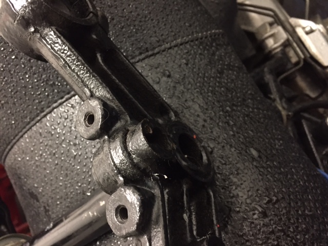

If its of any help I have owned several UK Z1bs inc current one since 1975 and all have had folding foot rests and a Stanley 001=0771 front lens fitted.

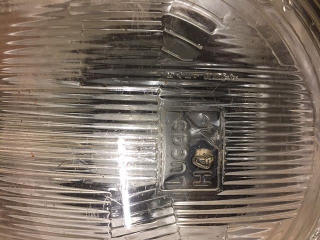

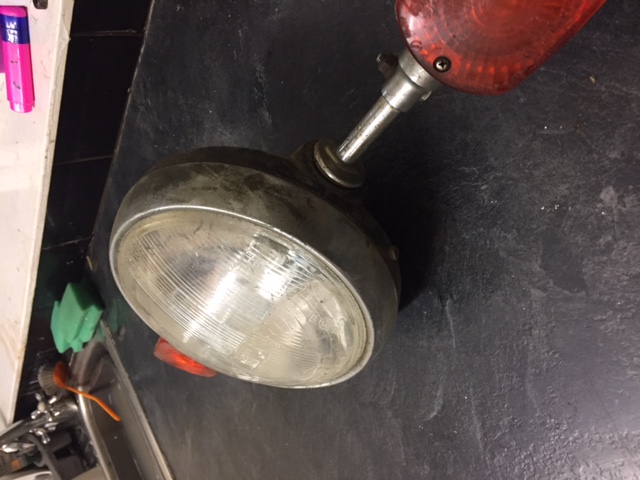

Looking at my parts again I seem to have the correct yoke but it has the steering lock cover missing
The headlight is a Stanley 001-0799 fitted with a lucas domed headlamp glass which I am guessing is wrong

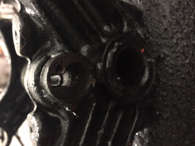

On another point the bracing under the headstock does not have the holes in as I have seen on other Z1Bs ...... maybe they have been filled in at some stage ?
