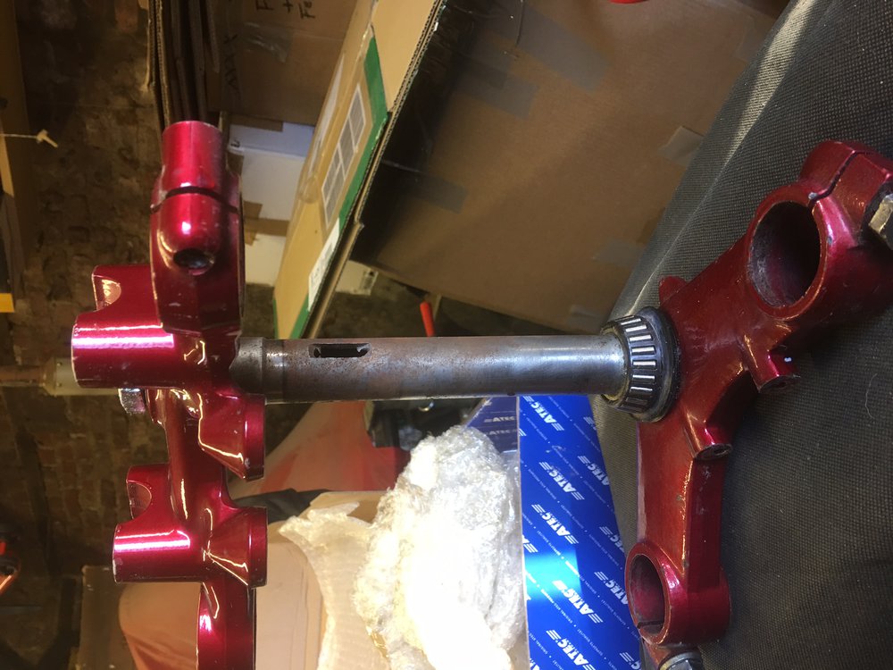

Does anyone know the differences between D1 and D3 tree's, they have different parts numbers?
Perhaps change of rake to suit the 18/19" wheels?
It's the Ozzie one's, the type with steering lock thru the frame on the RHS into stem tube.
Thanks in advance.

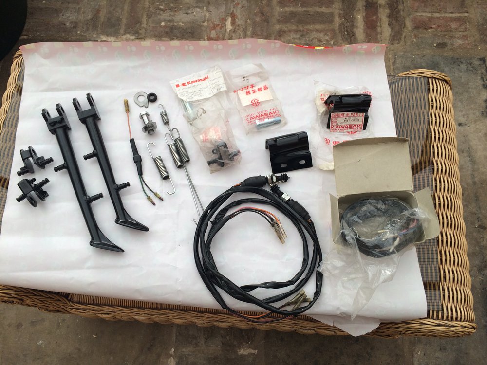

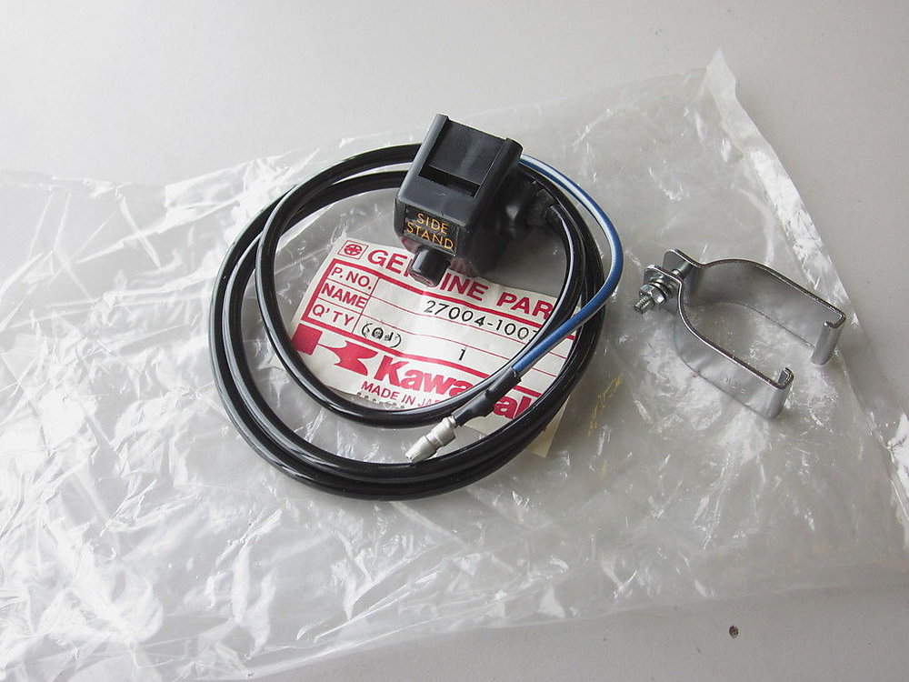

Is all the extra parts in 3rd pic the dreaded side stand switch bits?

Is all the extra parts in 3rd pic the dreaded side stand switch bits?[/quote]
yes it is ross and there's a few other bits missing from that photo and the like

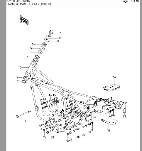

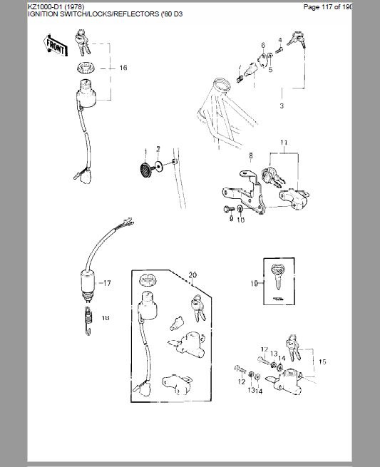

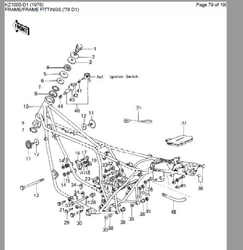

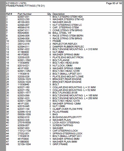

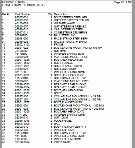

Just a thought Ross but the D3 frame has no provision for a steering lock ( or at least one is not shown on the fiche) and one is not listed in the parts inventory, so just mebe the tree has no cutout to facilitate one which could explain the part number. I cannot see any other difference
Keith
mistaken.
Phil Churchett winner 2013
mistaken.
Re: Z1R TRIPPPLE TREE'S
Thanks Keith, my Aust compliance D3 has the lock thru frame and it's shown in Aust genuine 1979 D2 parts book, lock is same part number as D3, but not D1 (probably due to key number range), l don't have books for D1 or D3 but online shows this. l thought all bikes wood have a steering lock in these years, maybe a case of different markets get different bits, maybe another great Zed mystery never to be resolved.

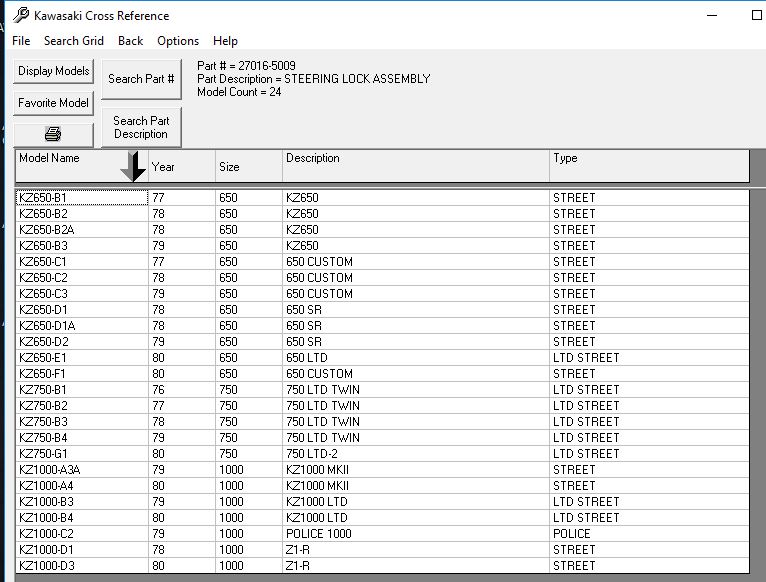

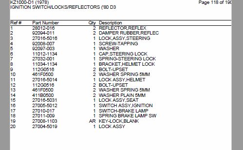

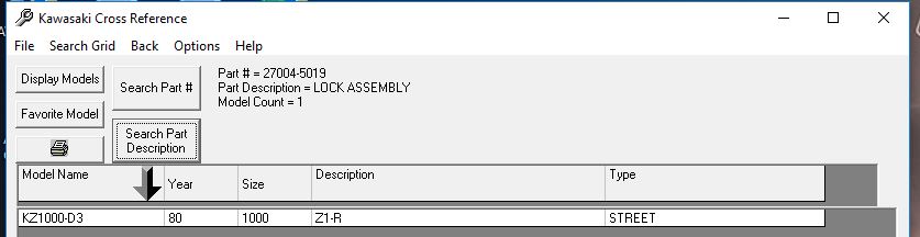

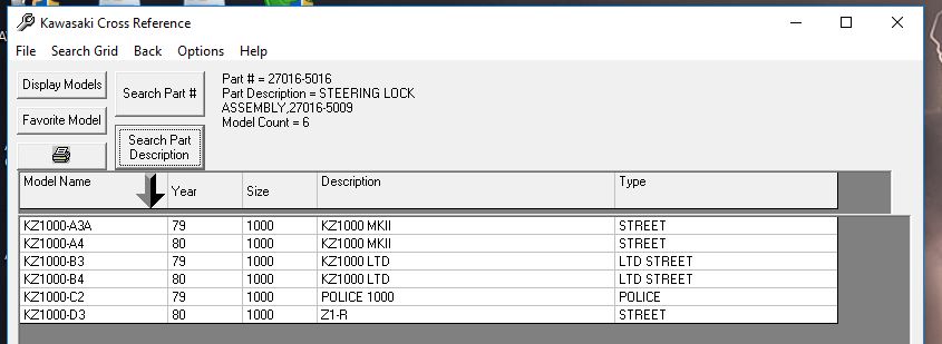

the same lock is fitted to these models including the d3 but it isnt shown on the frame schematics in the parts book its shown in the ignition switch & locks section
lock assembly part no 27016-5009
