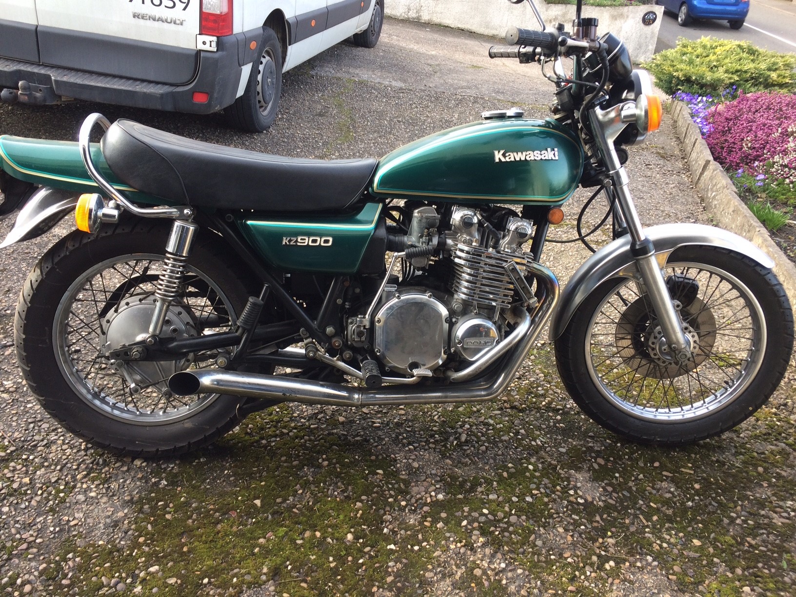

Ok, so well underway with the strip down.
2 Questions :??

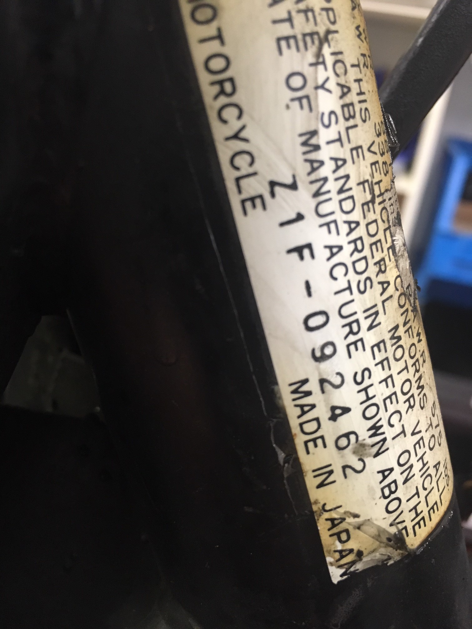

I read somewhere that all the Z900A4 for the US market were manufactured in Nebraska US.
Is this correct as mine is a US import but the sticker says Made in Japan :?: .
Date stamps are -
Wheels 5H & 5G
Swing arm 5.07
Switches 5.08
June - Aug
Shocks have a single F on them, is this a date stamp :?:

#3 PostAuthor: Garry.L » Tue Apr 10, 2018 8:26 pm
All date codes look good.
Genuine shocks have a small hole below the top mount for a dowel pin (pattern don't).
Your front mudguard is on back-to-front.

#4 PostAuthor: BigZCas » Tue Apr 10, 2018 8:40 pm
Yes there is a dowel pin.
Don't worry the front mudguard will go back on the correct way when I put the bike back together :lol:
So, the bike was manufactured in Japan for the US market :?:

#5 PostAuthor: Pigford » Wed Apr 11, 2018 12:04 pm
USA bikes frame numbers start with a 5xxxxx

#6 PostAuthor: BigZCas » Wed Apr 11, 2018 12:12 pm
I guess Kawasaki must have been manufacturing A4's for the US market in Japan and in the US. :??

#7 PostAuthor: Philippe » Wed Apr 11, 2018 2:48 pm
Hi BigZCas
don't worry about your bike, it seems to be OK and very original
It was manufactured in August '75 in Japan. It was imported in the US and then exported to the UK.
It was not manufactured in the US but destined for the US market hence the KZ nomination, one front disk brake rotor, short rear mudguard and the orange reflector.
All the date codes look OK so you have a great Z900A4 congratulations!!
Take the "bird cage" off and replace the exhaust by a beautifull 4 in 4 and it 'll be a stunning bike.

Pigford wrote:USA bikes frame numbers start with a 5xxxxx
Correct answer. :D
