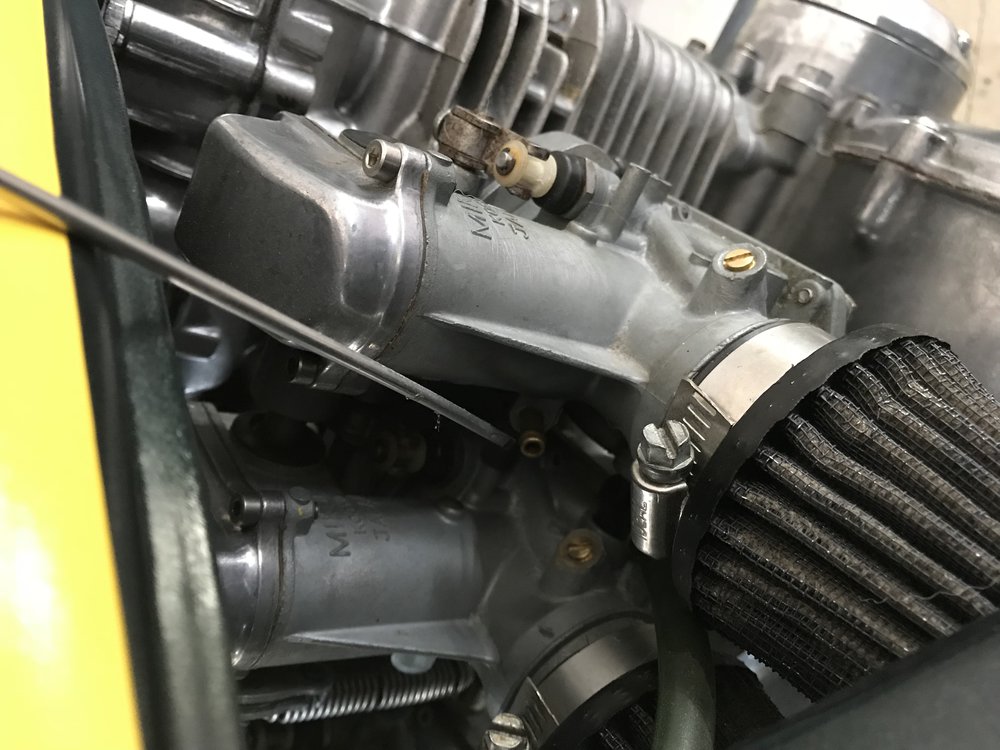

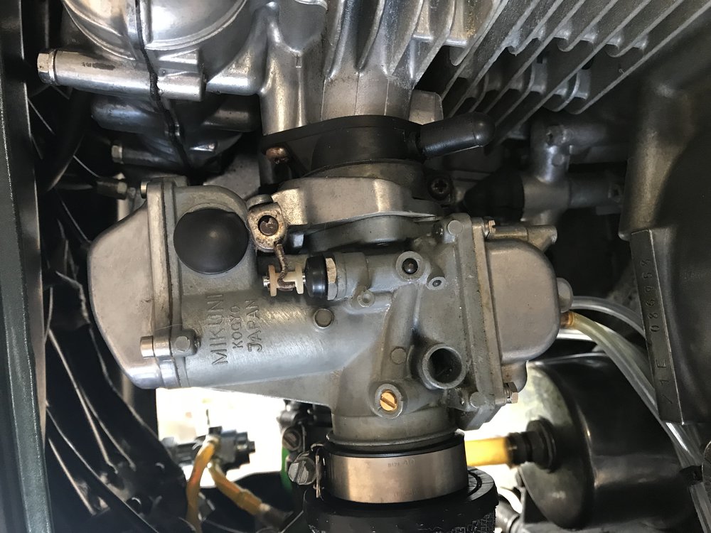

Depending on which model carbs you have one of the stubbs may be a vacuum take off for a vac operated petrol tap, for non vac taps they are just breathers, the bung makes me think you have later A2 carbs.

#7 PostAuthor: PAULJAC47 » Thu Apr 26, 2018 5:01 pm
We need a pic to see what carbs these are!

#8 PostAuthor: Trad 1 » Thu Apr 26, 2018 5:25 pm
Thanks everyone,,, I’ll try and put a pic on here,

#9 PostAuthor: kev edwards » Thu Apr 26, 2018 8:45 pm
They look like 28mm, does the bike run fine with the stubbs open, if so they are breathers, just stick your finger over the stubbs when running to check for vacuum.

#10 PostAuthor: Philippe » Fri Apr 27, 2018 5:09 am
Hi Trad1
the two pipes serve to let air get out of the float chamber. You can keep them short and bend them so they end after the carbs but make sure they point downwards in order to prevent water getting in. You can allso keep them long and then you guide them to the airfilterbox lid ( I don't think you still have one according to the pics) and let them end under the seat.
Anyway don't let them get clogged or the air won't get out of the float chambers.
