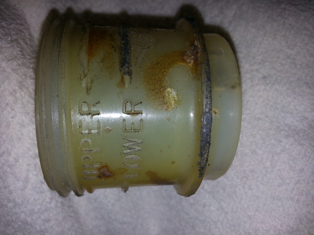

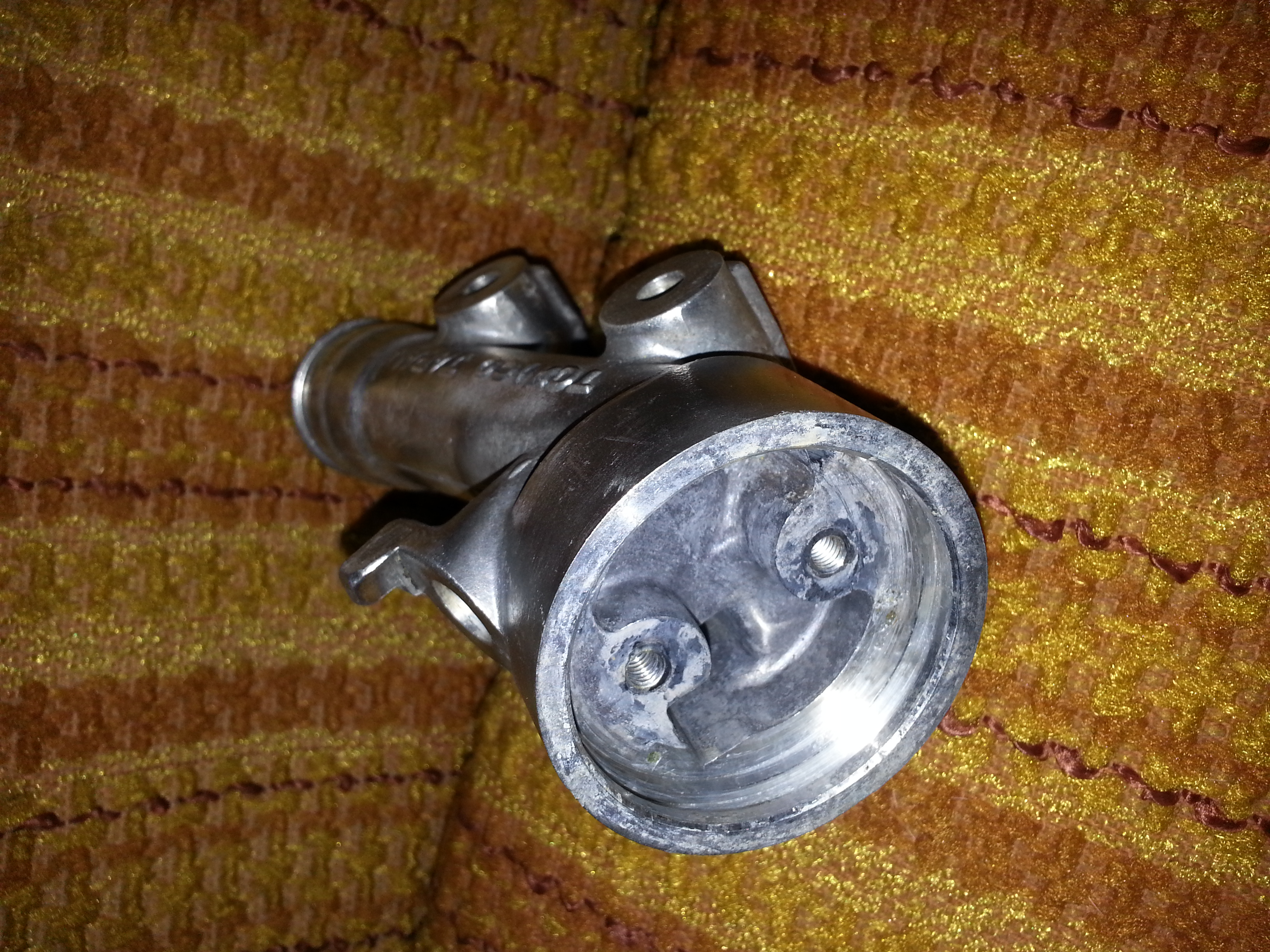

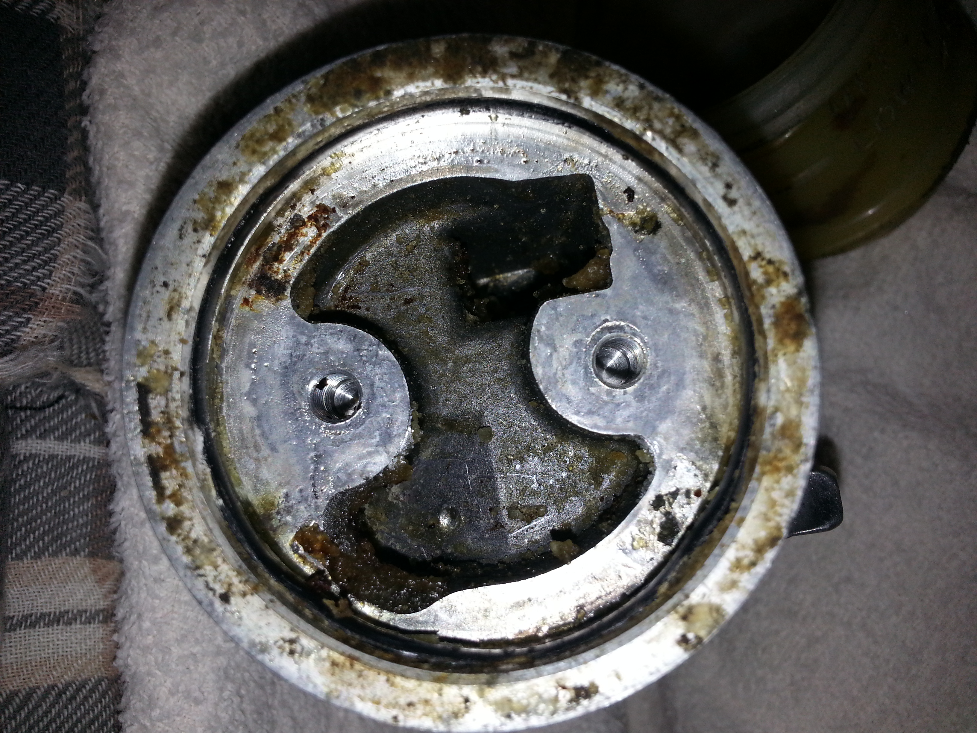

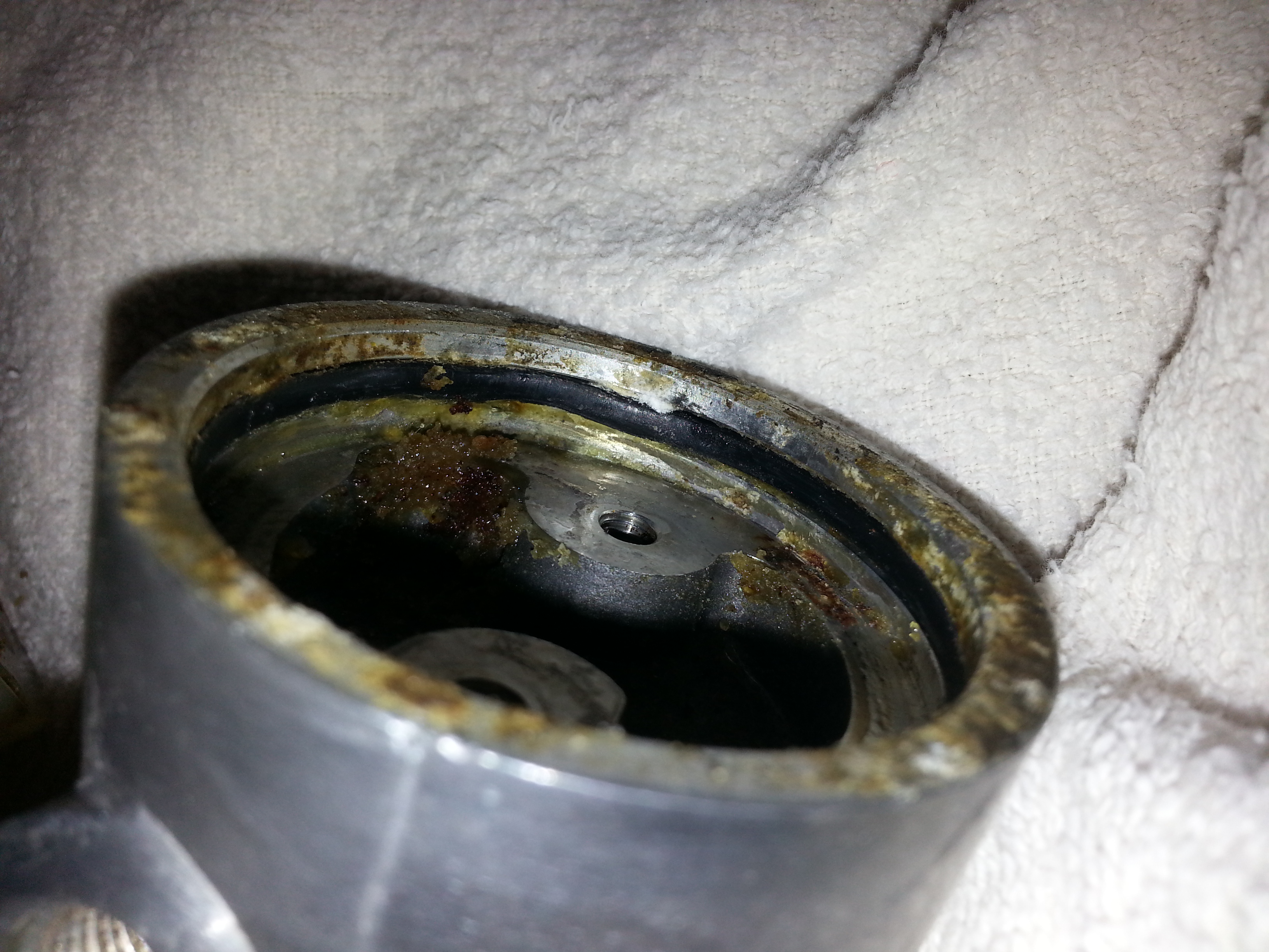

Hiya guys, a few questions to the more knowledgeable;
1, is the plastic reservoir available for sale anywhere
Or can this plastic be cleaned up?
2, is the 'o' ring available that sits inside?
3, what's the best way to clean out all the old brake fluid/crud?
cheers freddy

pm your address and i'll send you the o ring.
Cleaned mine out with a dremel and elbow grease !

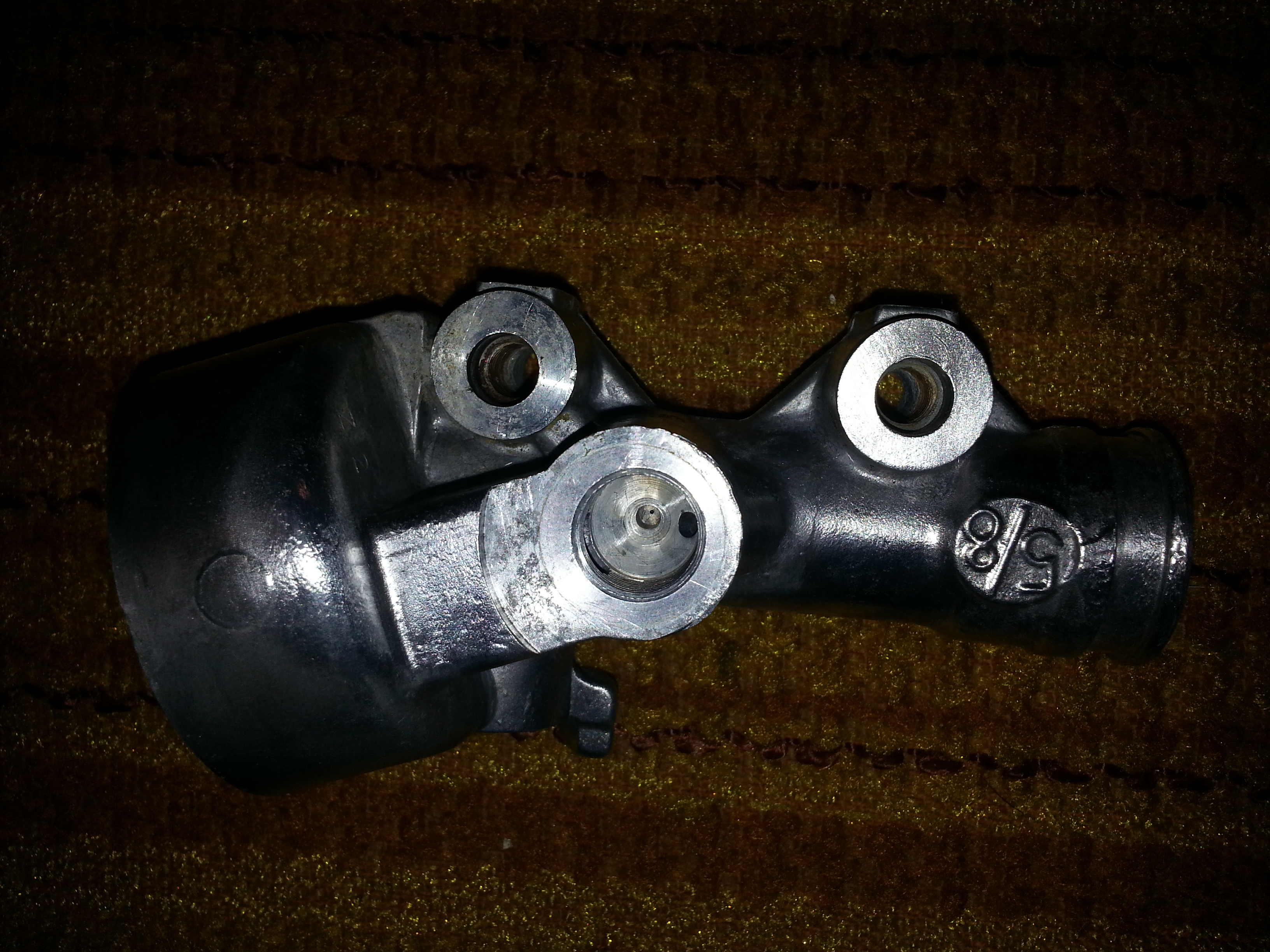

#5 PostAuthor: freddyz1r » Tue May 08, 2018 8:21 am
Thanks for the reply chaps :D
Steve, the o ring arrived safe and sound, thanks very much.
cleaned up nice (especially after a couple of dips into the ultrasonic cleaner :) ).
The fluid reservoir won't clean up properly :cry:
Cheers freddy

freddyz1r wrote:The fluid reservoir won't clean up properly :cry:
Cheers freddy
yes it will u need a chemical called M.E.K its a band substance used in pvcu window repair and manufacture if u can get hold of it ive not got any now :shock:

I put mine in the ultrasonic cleaner then in the dishwasher some come up like new some not so good but always better
hope that helps

hope u know how to use it its for cleaning and melting scratches out of plastic window frames it melts plastic if left too long :shock: :D :D

This MEK stuff, do you use it neat on the plastic reservoirs ?

Yes neat but its how much u use and how long its on the plastic
