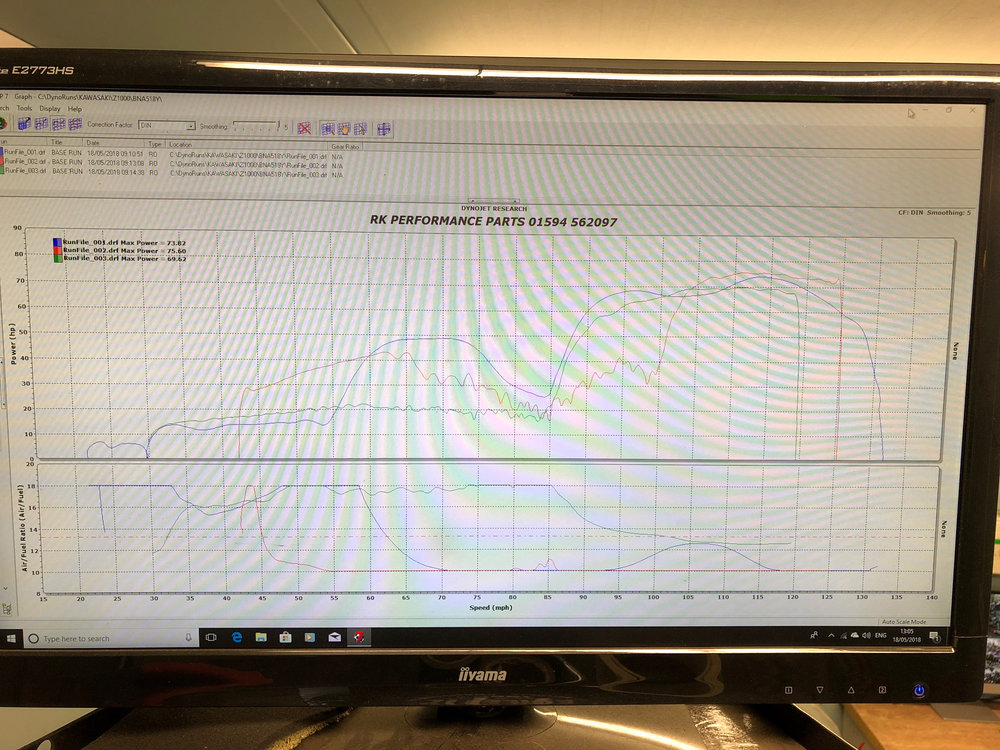

The bike is at the dyno currently and the guy there says it's absolutely miles out. I balanced the carbs up when I fitted them with my electronic vacuum gauges and didn't have any issues; easier than Mikuni flat slides to be honest. I don't like bell mouths for road bikes as they suck all manner of crap in

You could talk to Ray Debben @ Debben performance. He set my CR31 up. But they are fitted with velocity stacks and mesh.
