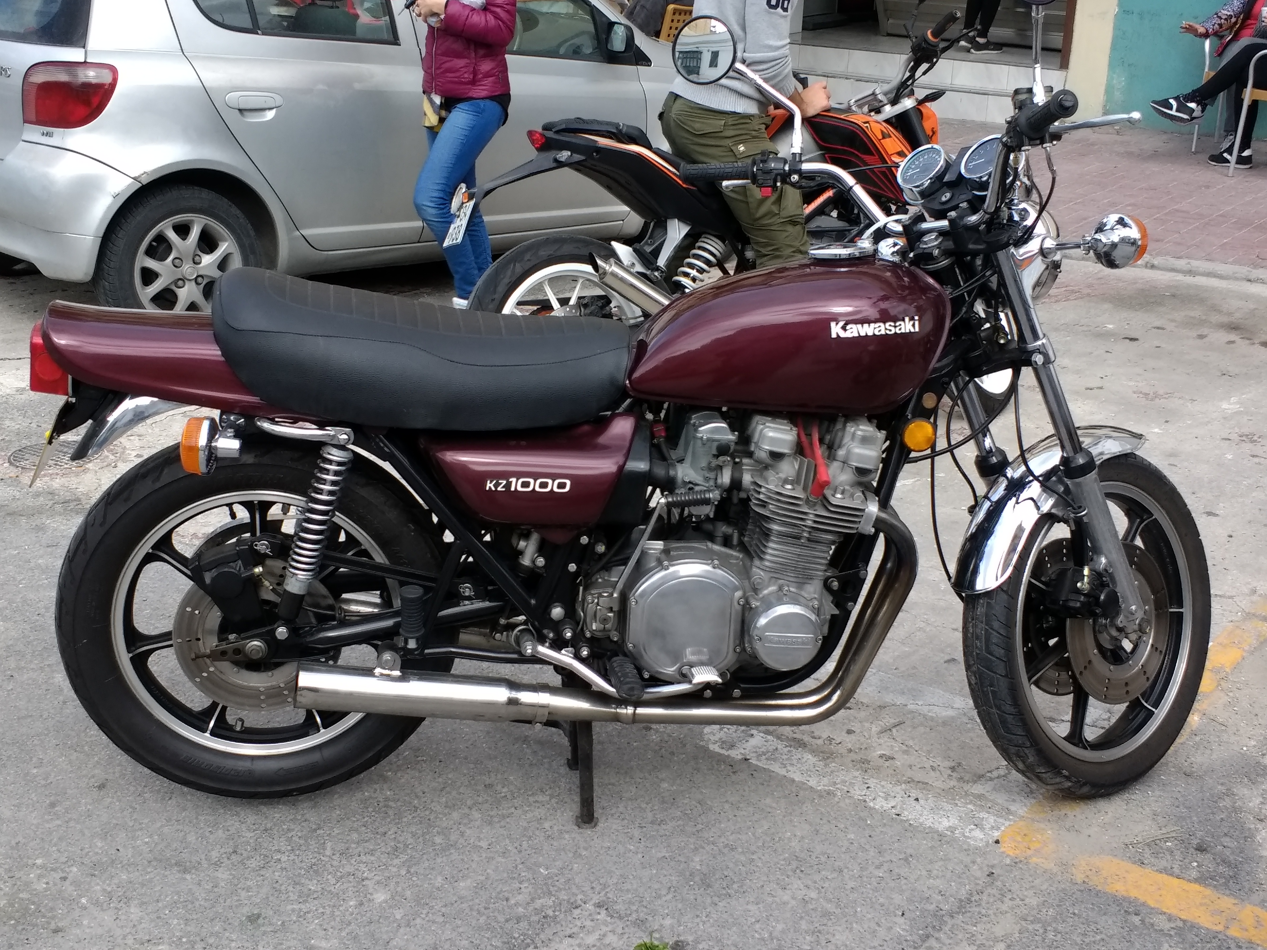

Hi long time not here anyway got a 1980 KZ1000 B2 with alloy wheels can I put spoked wheels on.

I would imagine the spoked wheels from the 1978 kZ1000 A2 would be your best bet.

spoked wheels will fit perfectly but you will have to change some of the collars/ spacers. also the rear wheel from the z1000 a1 is hard to source

You will also need the sprocket carrier and cush drive :!:
