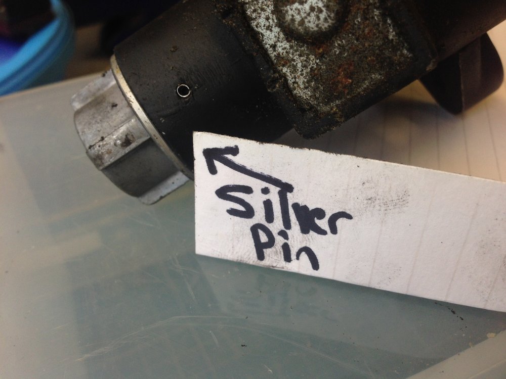

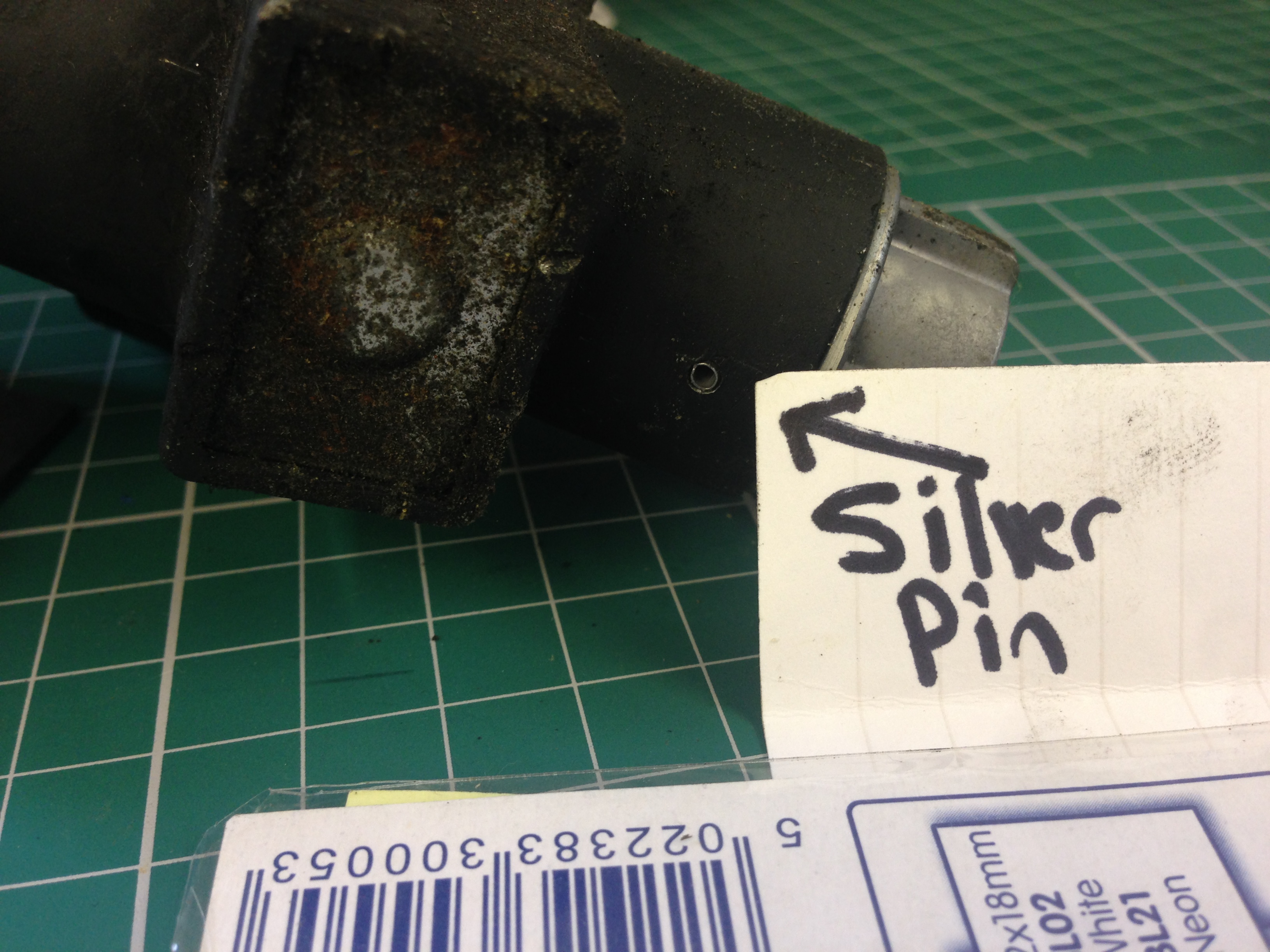

Trying to get into an ignition barrel, but these little pins are causing me trouble.
I've tried drilling them out, that failed!
So, before destroying another barrel, can anyone give me pointers on how to deal with these wee pins?
These switches are from an 81 Z400.
Cheers,
Davy

That appears to be a roll pin and they usually are just driven in or out with a punch.

use a self tapping screw & pull it out holding the screw in a vice

I agree with z1bman using a hardened self tapping screw or a small threading tap - although the latter is difficult to grasp to extract.

Soak with penetrating oil and then I selected a suitable diameter drill bit and tapped it out with that as a drift.
Obviously a vice or similar to hold it good and steady helps.
I also found the pins were more inclined to tap out from one side - so try both sides and see which moves first/ best then go for it.
