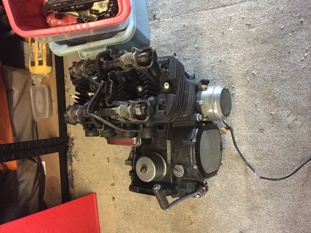

The engine was taken out to paint it as far as I can remember it was running spot on, the engine turns with the kickstart no problem, the bike has 62,500 on the clock, when I had it 20 yrs ago it had 57,000,
the black on the engine is less than good and it appears that it has had a brush paint at some point or 3 or 4 by the looks,
As I plan to strip the engine down to sort the paint out and considering the mileage should I think about having the bores honed and new rings or go for a rebore and oversize pistons/rings

hi, gavin, your original post never clearly stated that you knew the bike. i pictured a crusty, dusty clunker covered in dust but looks like a GEM mate :lol: :lol: a de-coke, hone and new rings might suffice if the bores look ok upon inspection, or 1st over at worst. I'd advise taking the sump pan off to clear any residual sludge out n check the oil pump n pick-up too.should be a great asset for 2019. m

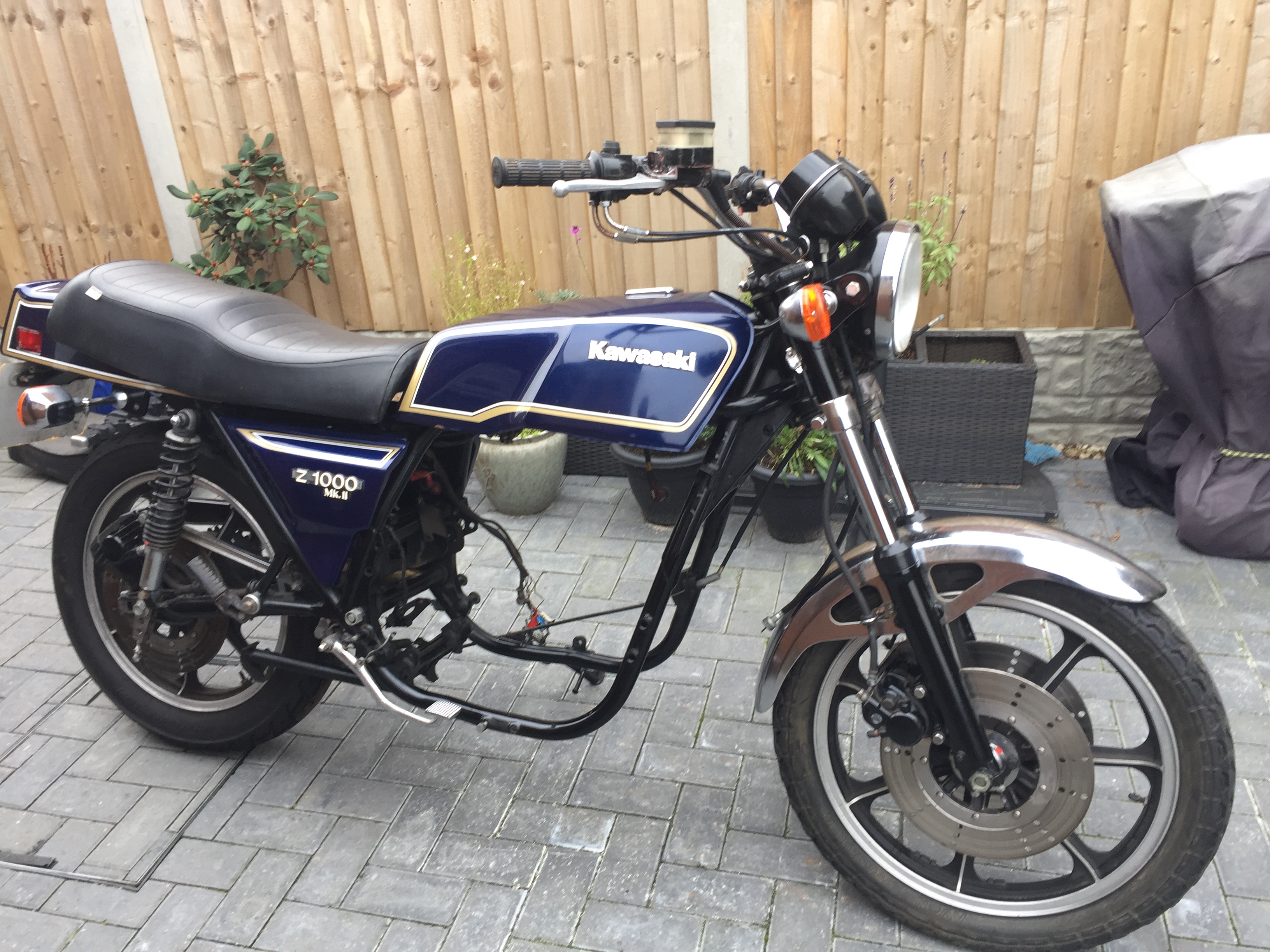

Bit more than 2 brass farthings, however it’s home
Z1000 MK2
Z1300 DFI
Re: Engine standing 9 years
#11 PostAuthor: ADRIAN H » Wed Dec 19, 2018 5:34 pm
That is a result. Paintwork does not look too bad, mostly complete. Good luck with the project.

Awww the fabled MkII is that Luminous Blue? I bid on one of these, And lost out to a Japanese bidder, I always liked the angular look, and kinda proud to own the first, the Z1R, but you don't see so many MkII's . :cry:

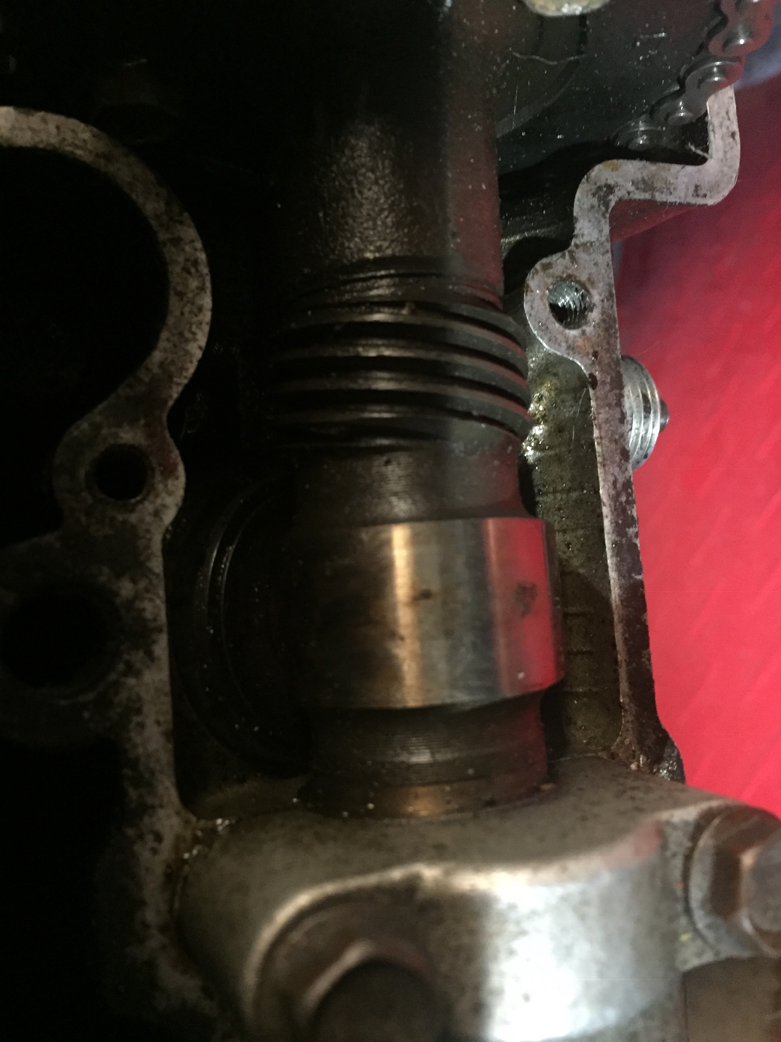

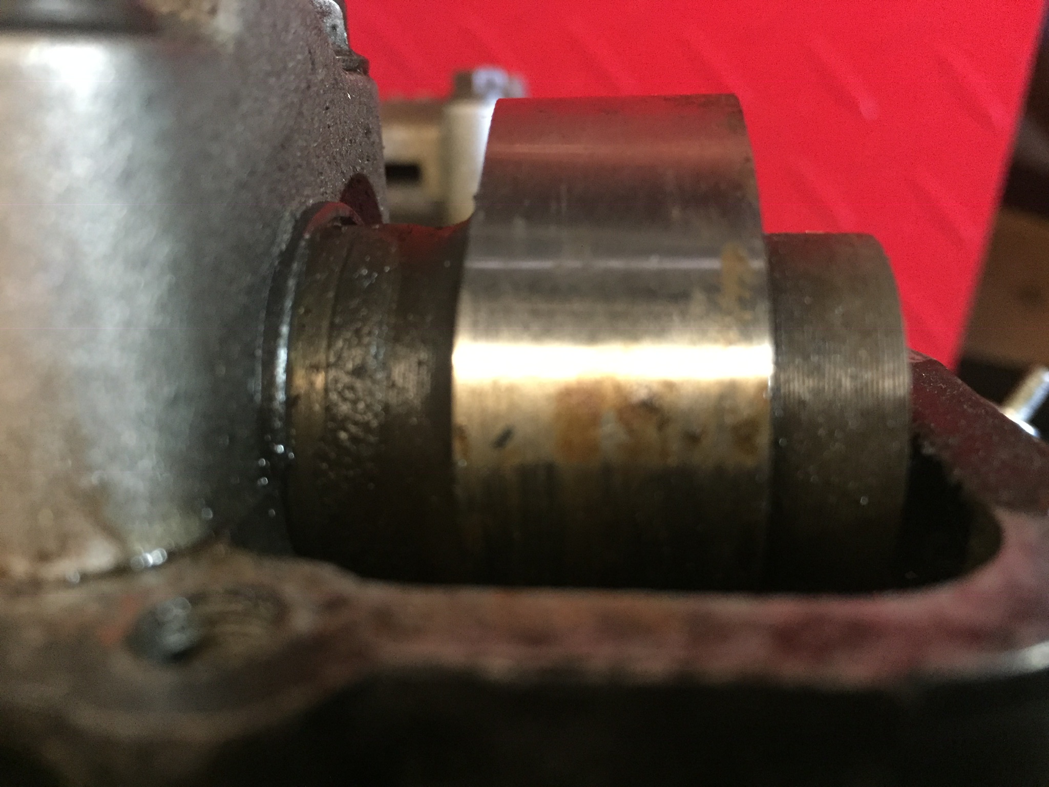

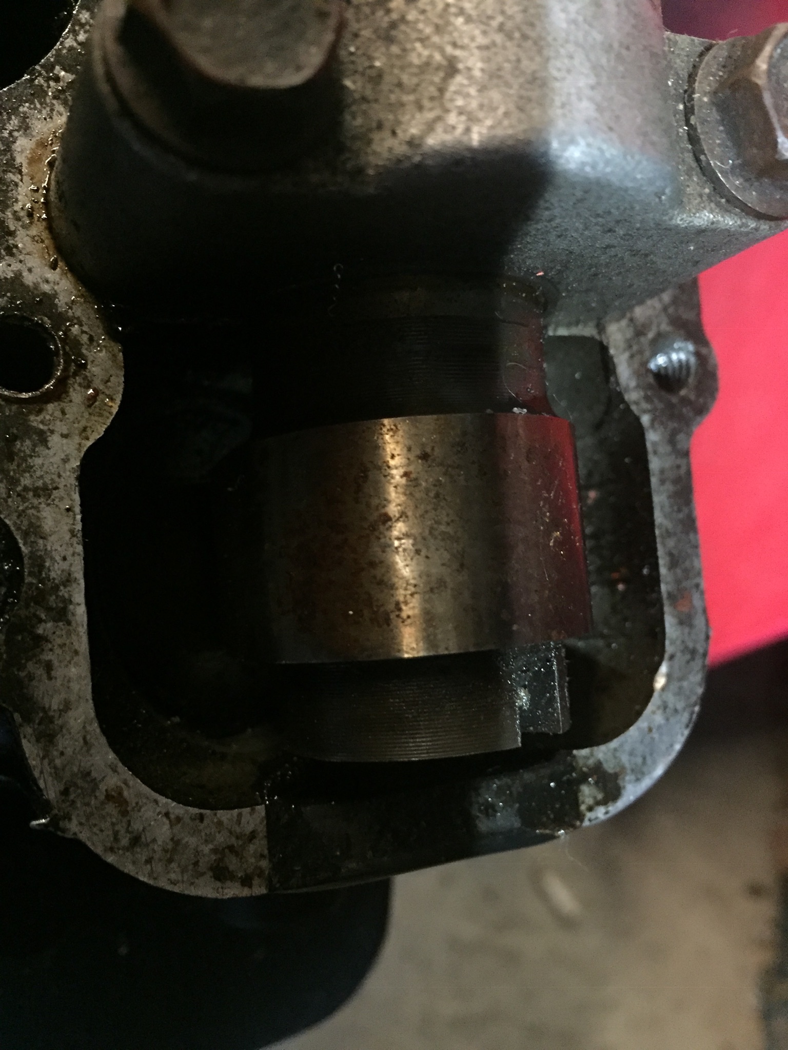

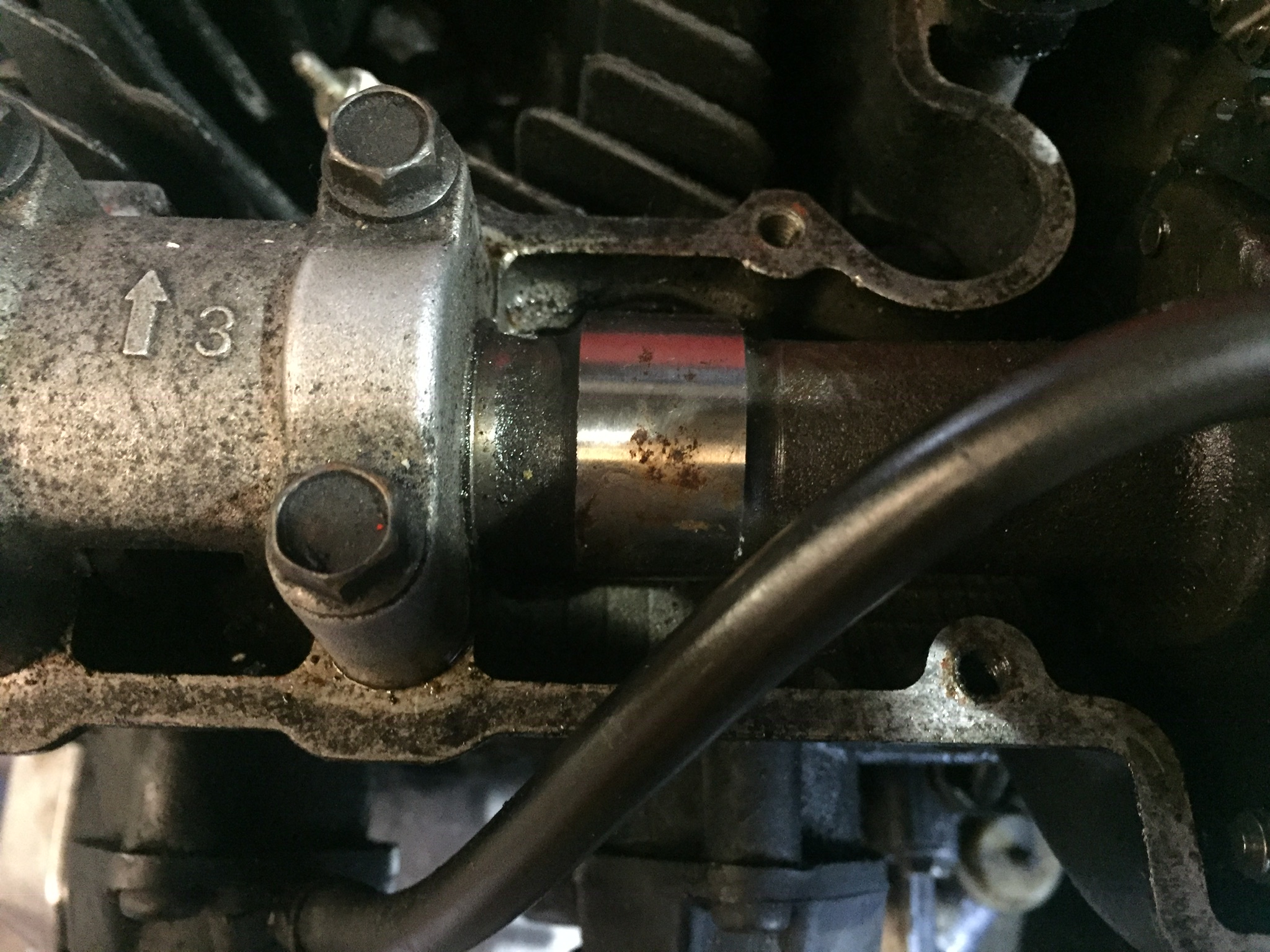

Right guys need some advice on this project, most of the bike is pretty good, however, the first thing I have seen are the cams, will these be ok to reuse or do I need to find replacements or can they be refurbished somehow.
These are the worse of the corrosion

Hi Gavin, the lobes are case hardened, I got away with polishing an XT500 cam, I wouldn't have them built up, it's a no no, D&K break motors, but it would have to be out of 3rd gen motor, bear in mind though the other place that would suffer corrosion is the crank, if you've any corossion on the hyvo it would be wise to full strip and refurb, better safe than sorry. :D
