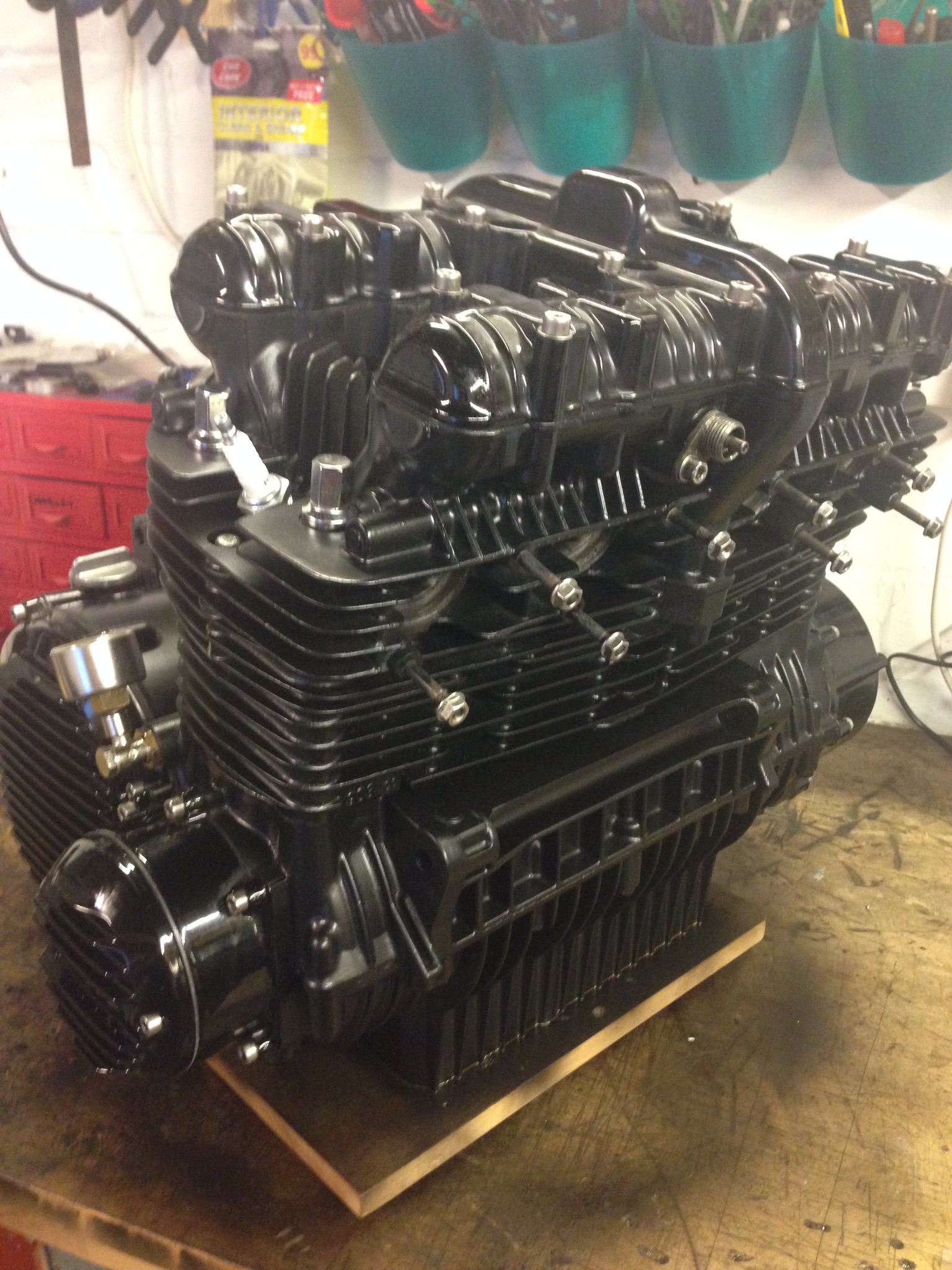

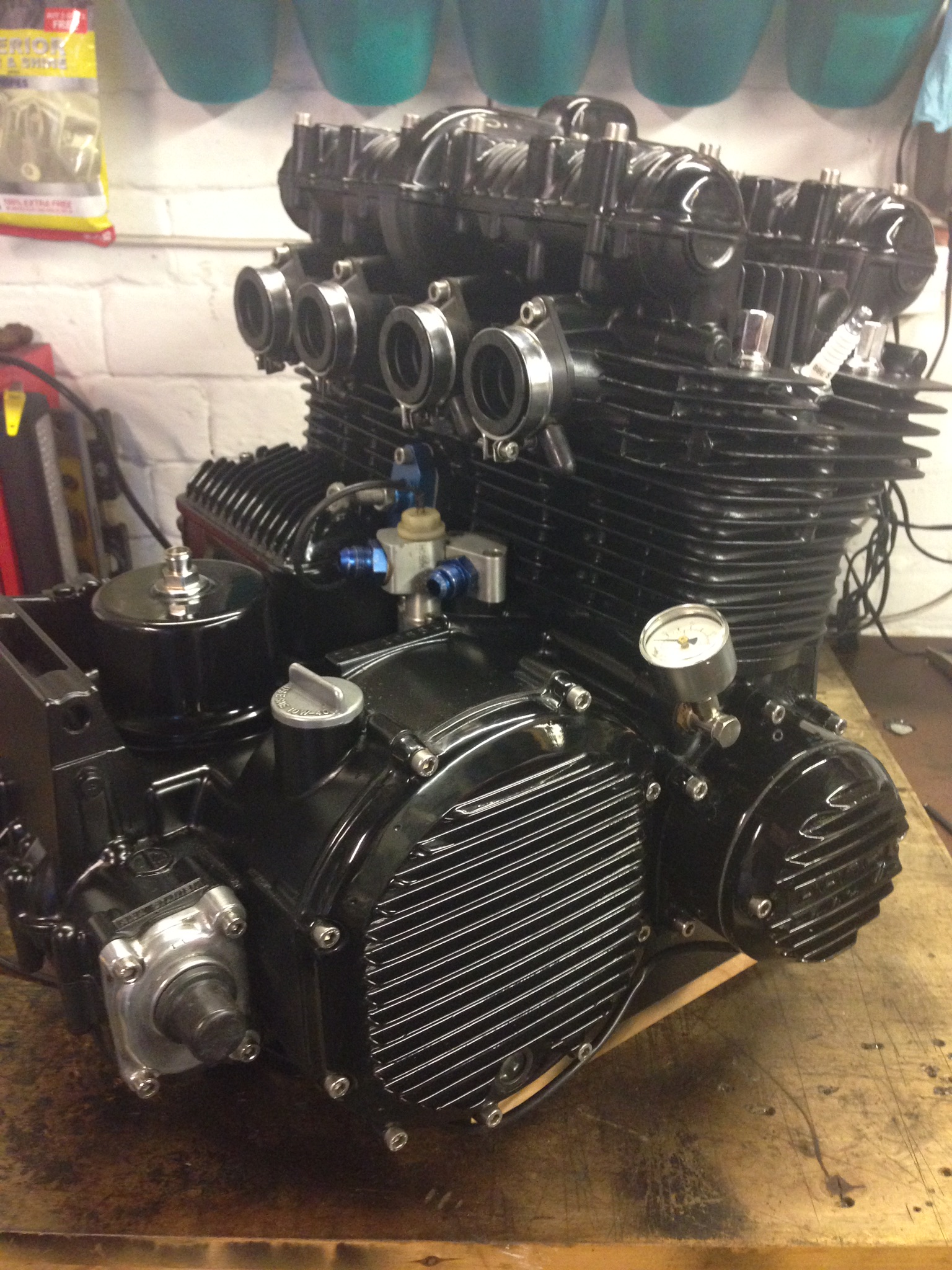

I have always used Simoniz tough black as Rob says the more coats you use the shinier you can make it. Engine in the photo was painted with this paint and the cases powdercoated.

Looks proper tidy.
