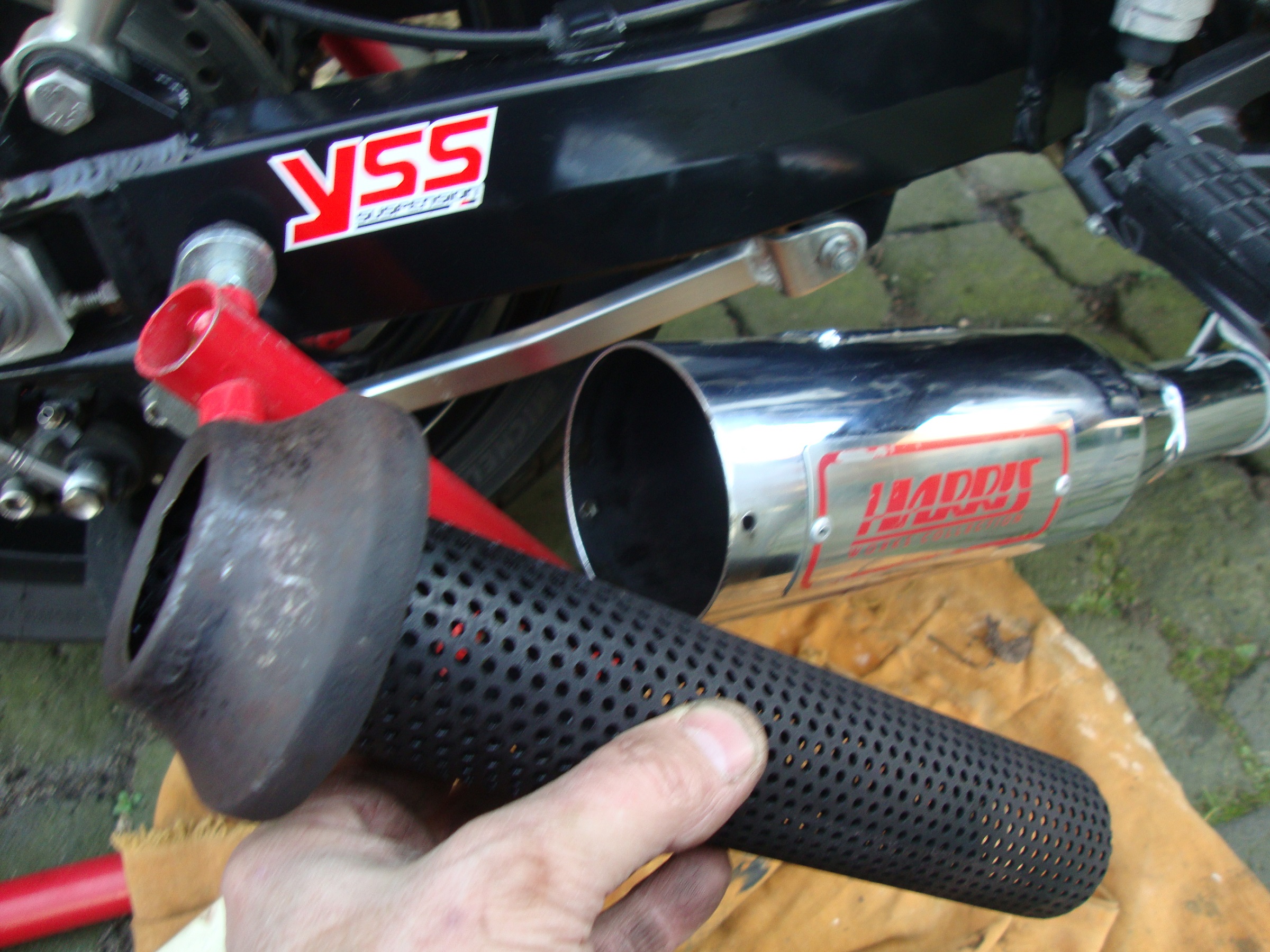

I have a Harris exhaust with a race baffle. A straight perforated tube with no baffling material around it. If I wrap some glass cladding (?) around it, will this quieten things down a bit? Would I need to retune the carbs?

#2 PostAuthor: chrisNI » Mon Feb 18, 2019 5:50 pm
Yes a bit and possibly? :shock:
Re: Exhausted
#3 PostAuthor: ADRIAN H » Mon Feb 18, 2019 8:45 pm
If you mean this - https://www.bikermart.co.uk/Motorcycle- ... ing-Sheets
the answer is yes.

Re: Exhausted
#4 PostAuthor: KWACKERZ1 » Mon Feb 18, 2019 9:00 pm
I have swapped from Harris race baffles and to the street versions on the same jetting without much if any detrimental affects (on a standard engine with std jetting though).
My advice would be do it and run it, at worse it will run a little rich, which wont cause any damage.

Re: Exhausted
#5 PostAuthor: davido » Mon Feb 18, 2019 9:51 pm
Ok, Ill do dat den. Thanks.

Re: Exhausted
#6 PostAuthor: Mr Bump » Tue Feb 19, 2019 1:55 pm
I’d assumed that the race baffles are supposed to be be packed with fibreglass, like a dirt bike baffle. They sound much nicer with packing, booming without being too raucous.
Having run with road and race baffles with and without packing I prefer race baffle plus fibreglass packing myself.

Re: Exhausted
#7 PostAuthor: ADRIAN H » Tue Feb 19, 2019 4:31 pm
Mr Bump wrote: I prefer race baffle plus fibreglass packing myself.
That is odd, or am I misreading this ?
Posts: 3845
Re: Exhausted
#8 PostAuthor: chrisNI » Tue Feb 19, 2019 6:25 pm
No the race baffle is straight through but the tube is perforated you can wrap that, restricts it a bit from no packing and will quieten it a bit. The road baffle is a completely different bit of engineering which restricts the exhaust somewhat more and quietens it quite considerably.

Re: Exhausted
#9 PostAuthor: davido » Tue Feb 19, 2019 8:50 pm
This is what needs baffling. I ordered some material today. Hopefully here by the weekend. Ha ha ha ha! I kill me sometimes.

Re: Exhausted
#11 PostAuthor: davido » Sat Feb 23, 2019 6:24 pm
So, I wrapped the baffle today. I would say it has taken the edge off the sound. Nothing more. A bit less harsh,maybe warmer ( as someone said). Cant say more than that. Ill run it like this for a while and see if I get used to it. (Couldnt get used to the un-wrapped baffle.).
Ill let you know.
