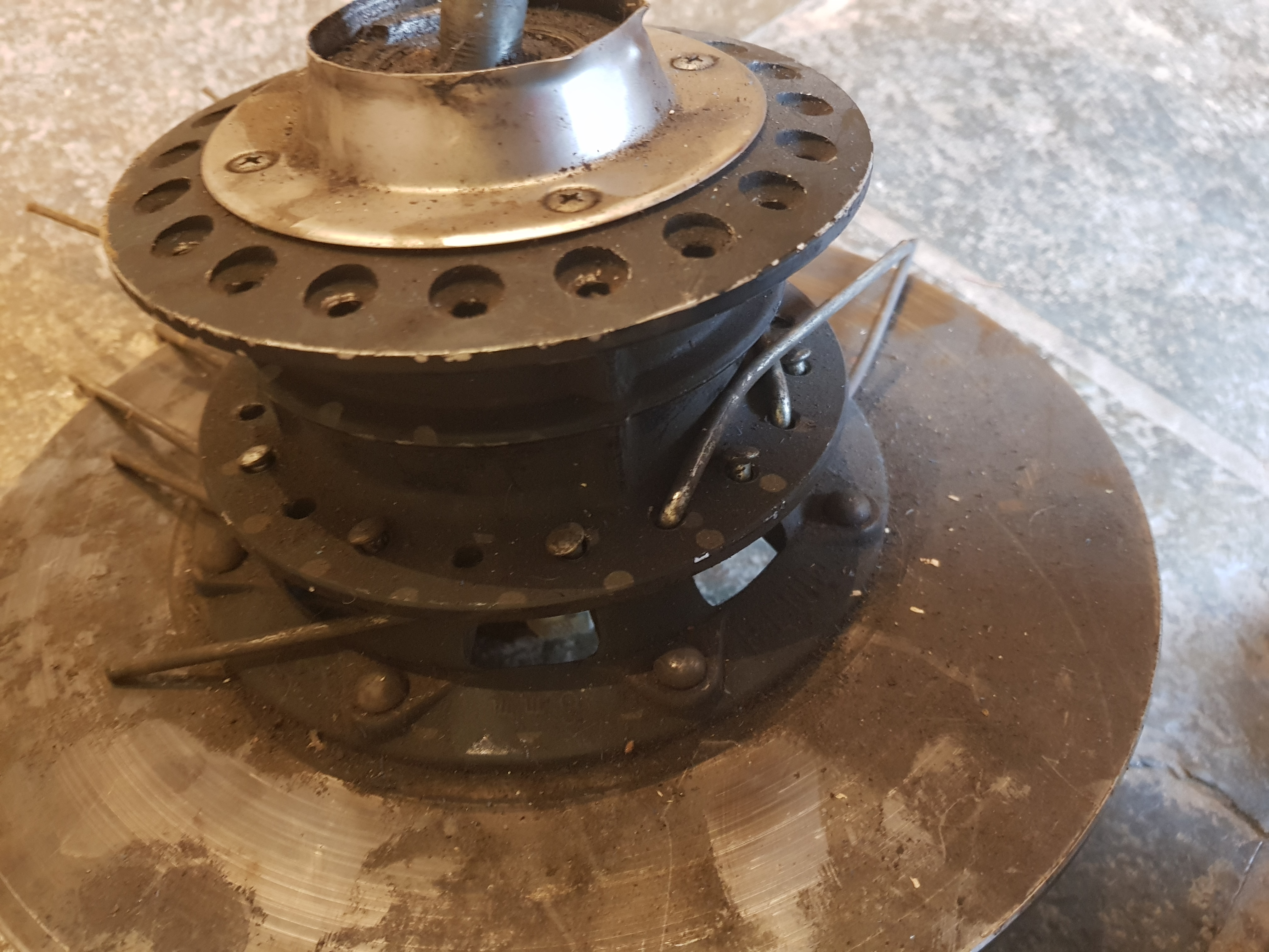

Help sorting a quandary,
I have a front wheel hub, it appears to be an early black one and the reliable source (Grubby from MTC Reading) clearly remembers it coming from a crashed Z1-A.
BUT, it has a 4 bolt disc, not 6.
Is there a cross-over? Were Z1-B hubs 6 or 4 bolt?
Incidentally, I haven't yet removed the disc to see if maybe it was re-drilled for a 4 bolt disc?? I will do that tomorrow.
Cheers,
Mark.

all the Z1, Z1A and Z1B front wheel hubs had a 6 bolt disc. The 6 bolt hubs are larger in diameter than the 4 bolt hubs.
To my knowledge there were no 4 bolt hubs in those days (73 -74 - 75) for the Z1A.
Perhaps it wasn't the original hub in that Z1A .

the kh500a8 & z900a4 where the first models to have a 4 bolt hole hub but they where bare aluminium not black

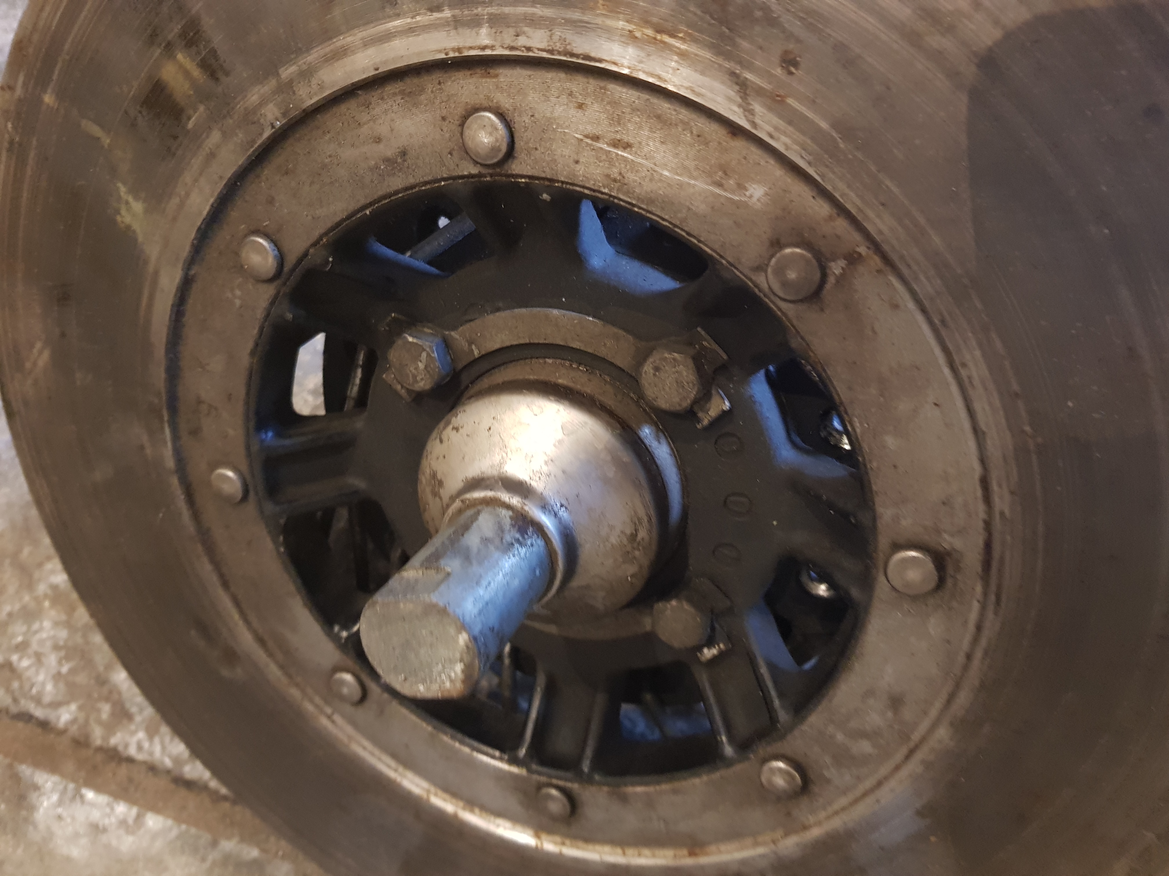

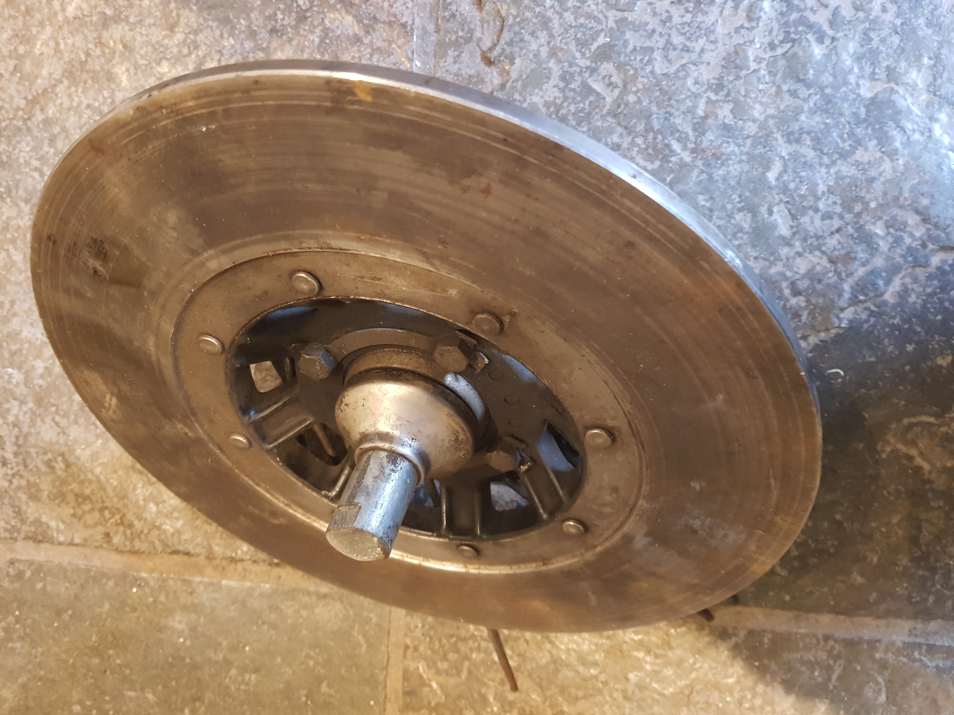

280mm disc, original black finish, M8 boltsx4, 9K date code ie 1974.
I am thinking Adrain's H1 suggestion may be correct.
