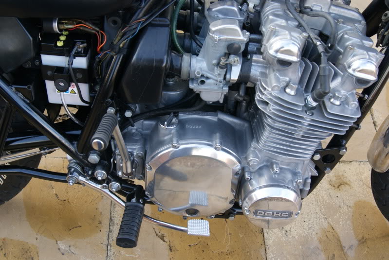

    Firstly remove the RH side panel and lift the seat up for access.
    Next remove the fixing and disconnect the earth terminal on the battery.
    Next remove the fixing securing the hinged bracket, then partially slide the battery out.
    Disconnect the vent pipe (if fitted), remove the fixing and disconnect the positive terminal on the battery.
Job done.

Eventually got this done - that picture was very useful thank you. My battery was in a plastic box, unlike the one in the pic.
