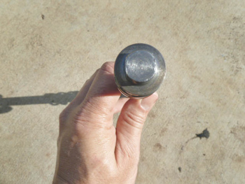

Hi
On my Z1000-A1 the fork damper rods are the almost round variety and no-one appears to do a tool for these - or do they? Or do I have to make my own :(
Oops - I see that someone in the States does one. Anyone in the UK?
A photo of a similar damper is attached.
