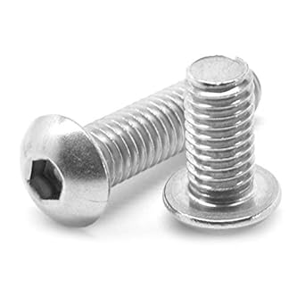

Tyre stoppers/tyre grabbers/rim locks/wheel grabbers - multiple names for the same things :wink:
I used some M8 button head screws and nuts on my alloy wheel. There is no need for rim locks fitting anyway, the old Zeds would struggle to remove rice pudding skin, let alone tear valves out of tubes :)
When these are fitted though, they look like rim locks ARE fitted and you dont leave unsightly holes in the rim. A rim tape or similar neatly covers the head inside the wheel
