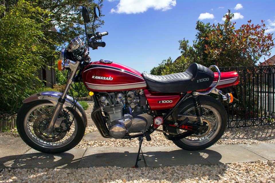

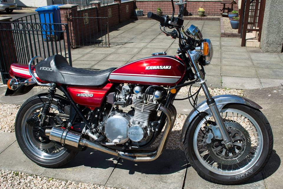

Hi ZedHead, thanks for the info over the past few emails I've posted. Any ideas what would be a fair price? I'd rather sell to a good home than make a profit.
Owned by myself since 1992, hundreds of receipts kept over the years.
Engine is 1075 Wiseco, HD valve springs, APE valve spring retainers, crank rebuild by Debben with new rods / bearings, etc, other head work done valves reground new seats etc (about 4000 / 5000 miles since the rebuild), APE HD crank case / cylinder studs, main bearing studs etc, roller clutch push rod conversion, HD clutch springs, VM 29mm Smoothbores (£300 + spent on new internal from Allens Performance), brand new genuine K&N filters, Dyna Ignition, coils, Taylor leads, billet manual cam chain tensioner, HD Tsubaki race cam chain, Billet cam end plugs, Stainless one off exhaust (by the same guy that used to make Jim Moodies echausts - SWONA), Arkront rims, high flow Pingel fuel tap (think this is a pattern one tbo), Deep braced JMC swinging arm (could be doing with re-powder coating if your really fussy but is OK atm), brand new 520 (?) Debben Chain / Sprocket Conversion kit, Koni shocks, progressive front springs, Specials (Glasgow) Spondon 13 inch fully floating discs and Nissin 4 pot calipers, brand new HEL brake lines, brand new EBC fully floating rear disc (not in photos as still to be fitted), new pads all round, brand new (pattern) switch gear, brand new radial ClassicAttack tyres front and rear just fitted so not in photos, brand new front mudguard (ZPower) still to be fitted, most other chrome is OEM and in good condition, Genuine mint GIULIARI/ 2/4 seat and standard OEM seat in great condition. brand new chrome mirrors (not in photos still to be fitted), brand new Motobatt gel battery just fitted. Brand new = meaning just fitted or next to zero miles.
Cheers and thanks for your help.

Re: Valve stem oil seals and valve seal conditioners
thats lovely and taste full mods, a little smoke on startup would not bother me neither good luck with the sale

I've no idea what it's worth, but it is very nice.

I have given up trying to figure out what bikes are worth these days.. For Mint original bikes, asking prices seem to be:-
73 Z1 Upto £30k
74 Z1A/B Upto £20k
76 Z900 A4 Upto £14k
77 Z1000 A1 Upto £10k
Of course these are asking prices it does not mean this is what they go for. Also specials are not usually as desirable to a wider audience.
My guess, and it is no more than that, on a nice bike like yours. £7-8k.
Then again that will just about get you a mobility scooter from Frank these days
