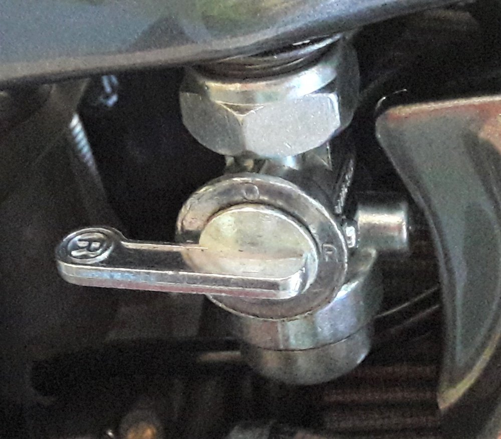

here is a picture of the offending petcock and the poor strainer bowl seal alongside a new seal from Z-Power.

Mine is not the same as the one pictured, (no strainer bowl), leak only in ON position, and is OK in RES and OFF positions....
