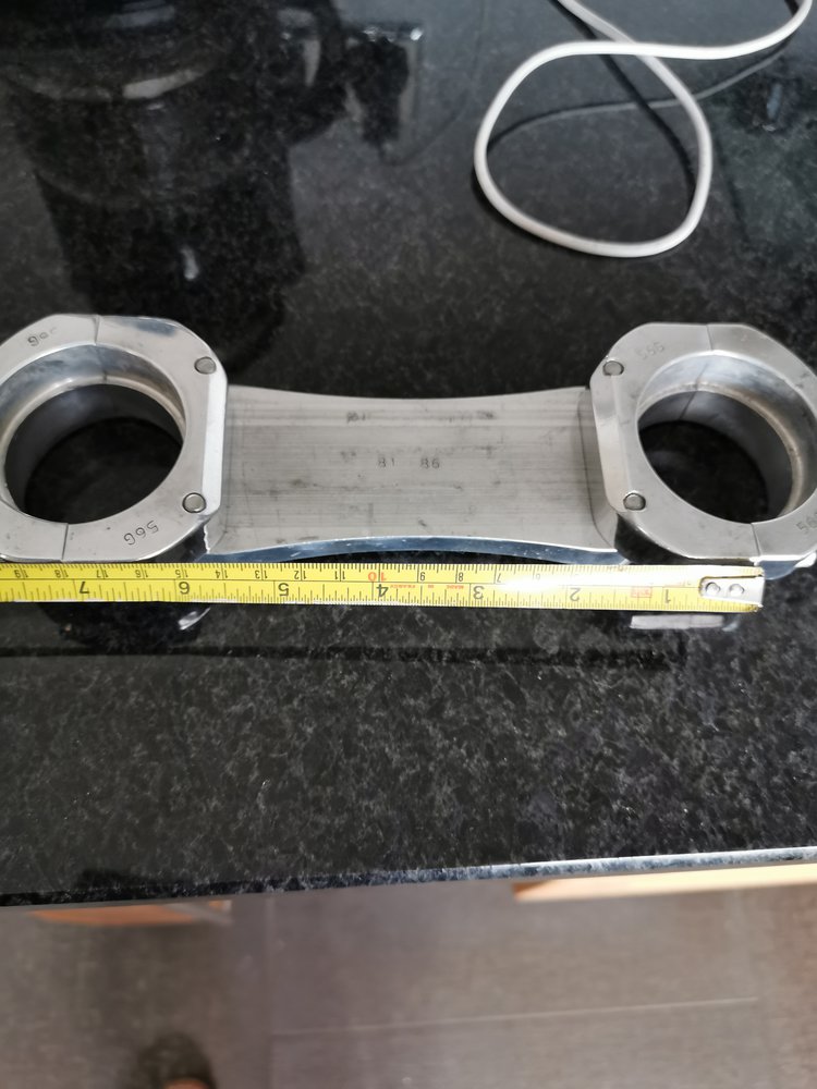

I have a micron brace that came in a box of other bits for a 900 A4 a while back, it has 81 86 stamped on the bridging part and 56g on the clamp sections, can anyone confirm that it's for the A4 or any other bikes?

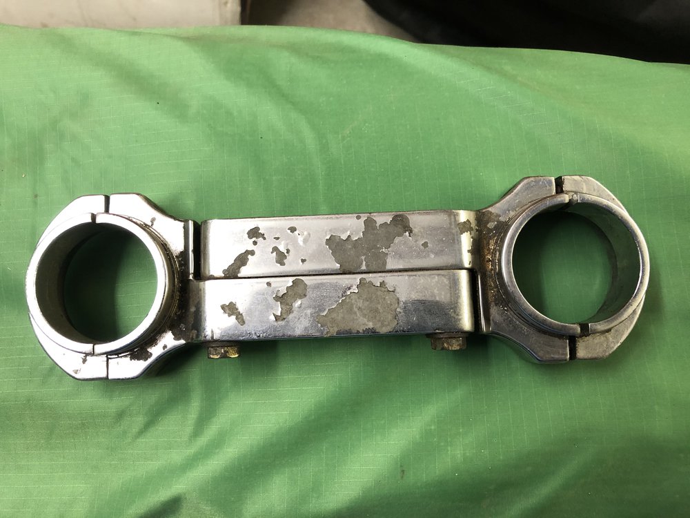

Wayne I’ve just sent mike a brace a week or two back have u 187 mm give or take centre to centre at clamping that’s what a z1r was a st is 220 mm think a a4 would b same as z1r but has I’ve not had one don’t know ?

Thanks guys, center to centre is 180mm and the internals of the clamp is 51mm ish

56G for Z's
58G for GPZ/J/R
56mm is the diameter of the forks where the rubber shroud slides over the top of the fork leg. slide the shrouds up fit the fork brace then the rubbers slide on to the top of the brace.
