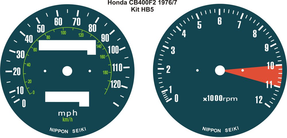

Good afternoon,
Has anyone any idea what this might be part of? It looks like a smallish Kawasaki triple to me, but I can't work out what.
You can tell by the orientation of the photo that it's off an Australian model of whatever it is....
Thanks, Olly

Sorry but I reckon you are all wrong... It looks very smilar to the Hodna CB400-4 F2
The only slight difference is the kmh markings (i.e. the 140 on the F2).
It's 99.999% certainly Hodna due to the L-shaped mileage cutouts, the plastic housing and colour of the gauge face.
I may be wrong but I doubt it :lol:

I've climbed over the lawnmower to find my Z250 clocks... and damn it, Big Fluff is right, it isn't the same!
On the Z250 the blue "km/h" lettering (below the trip display) is above the white "mph" lettering.

Big Fluff wrote:Sorry but I reckon you are all wrong... It looks very smilar to the Hodna CB400-4 F2
I reckon you've cracked it. Nice one.
Thanks to all for your assistance.
