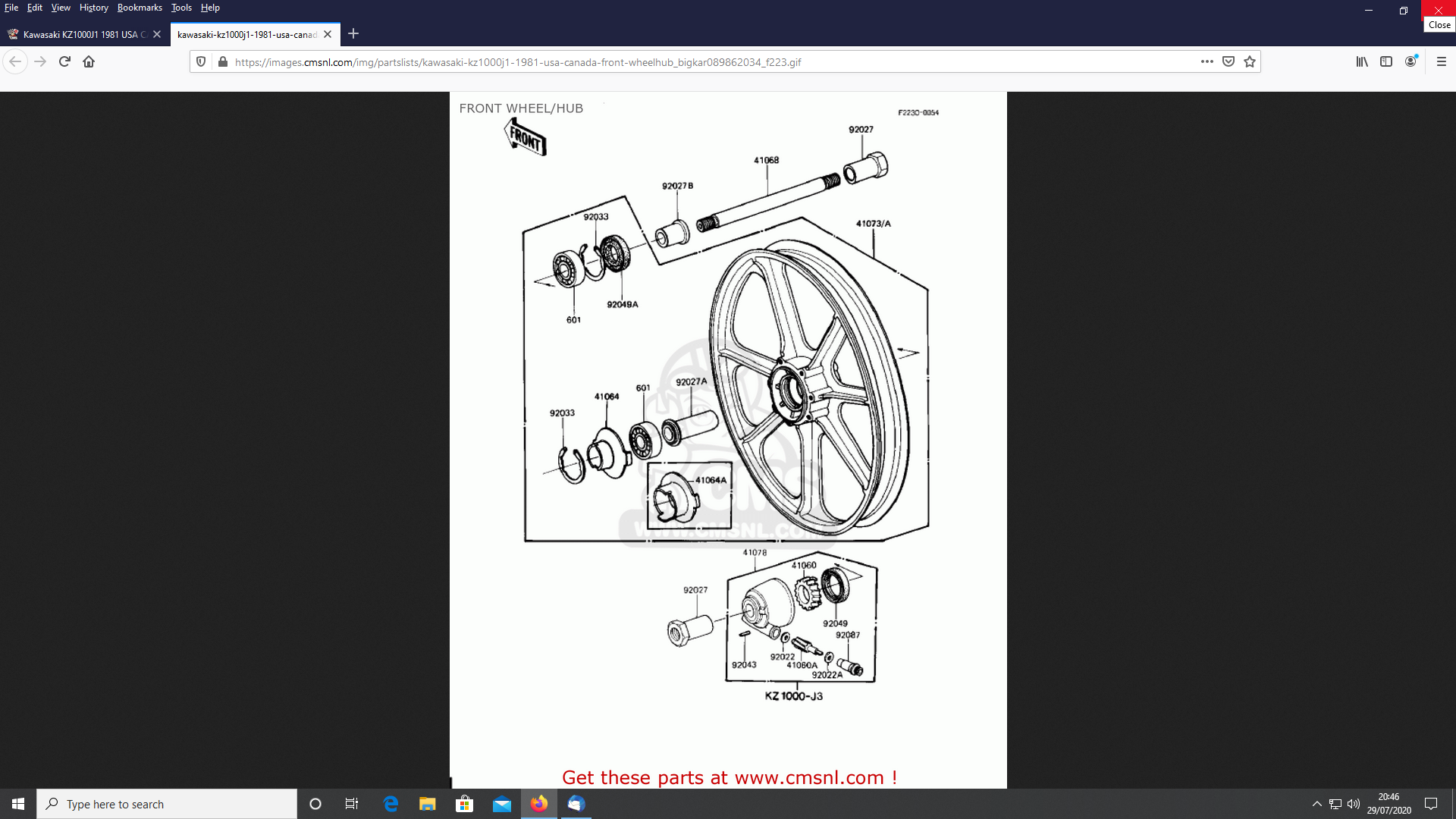

It is very easy to get the sensor sat on top of the tabs on the drive ring, not so easy to get it to locate accurately. It will be immediately apparent if you look at it because its very flimsy and it crushes inwards if it was wrongly placed. Looking at the parts diagram it looks like there are two different sorts which i hadnt noticed previously. One has tabs facing inward and out, the other; only tabs facing in and recesses facing out. Might be worth checking you have the right one. Also might be worth checking that someone didnt assume that the circlip is designed to hold the bearing in as on the RHS. Its just for the drive ring which is loose once fitted.
https://www.cmsnl.com/kawasaki-kz1000j1 ... 62034.html

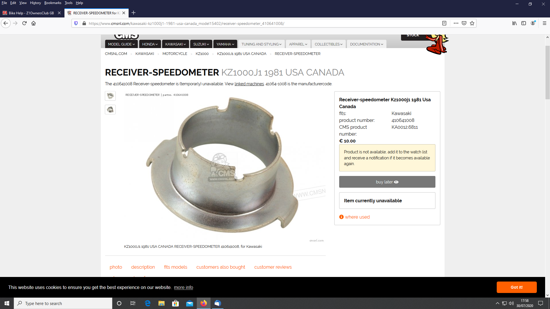

And of course the speedo receiver (tagged bit) is no longer available...aaahhhh... :sad
Does any one know if the cable speedo receiver (tagged bit) can be modified (dremel) to work with the electronic type as this is still available.
I would imagine the wheel bit is the same but it just looks bigger up top. All for about 8 quid..

The two inner tabs on mine were smashed flat and one of the outers was missing. Like you i straightened it but then TIG welded on another tab. With a little practice, as you push the speedo drive home you can feel the pegs with the inner ring of the drive. If you turn it just a little there is a point where it drops in. Turn a little back and forth and before the resistance of the drive mechanism starts to turn you can feel a mm of free movement.
