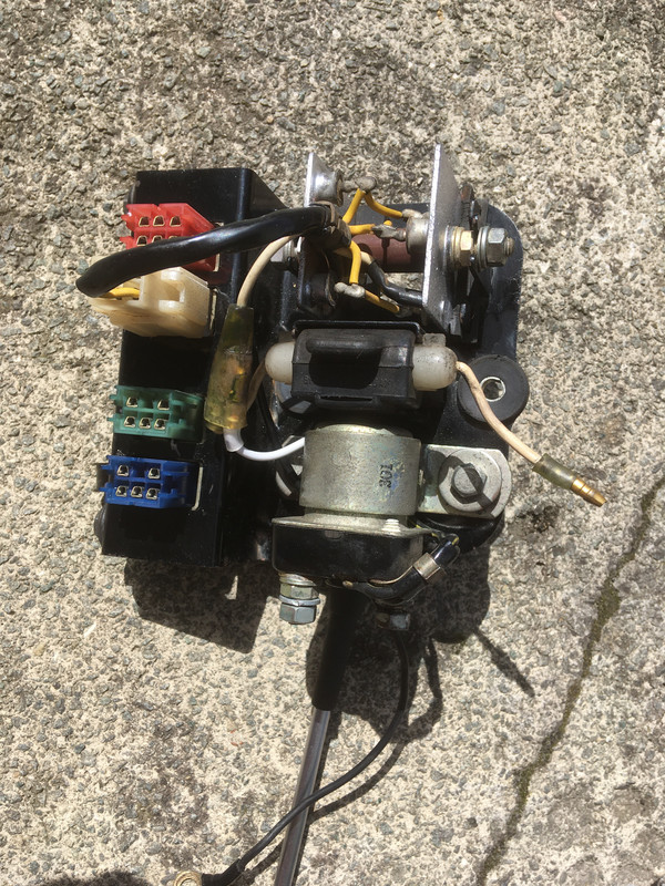

All sorted! Blue plug because James H has kindly offered me a new alternator lead in place of my nasty one with crimp connectors, white plug because I got a used rectifier from D&K. That came this morning, as it was possibly the last nice day this week, working from home was abandoned for the day and I set to work.
I first tested the rectifier with the multimeter, at first it seemed dead until I realised that elastictrickery was not passing through the layer of crud on the earth terminal. A bit of fine wet and dry sorted that out, then all was well - full current one way on each wire, nothing when I reversed the polarity. There was some rust on the rectifier plates, I always assumed they were unpainted until I saw where the original silver paint (complete with Mitsibushi logo) had been protected by the rubber mounting damper. Then the OCD kicked in, so I carefully removed the rust with a fine wire brush on my new Chinese dremel and sprayed some Simonize silver engine paint on. I removed the original knackered wiring and fitted one of my two new sublooms.

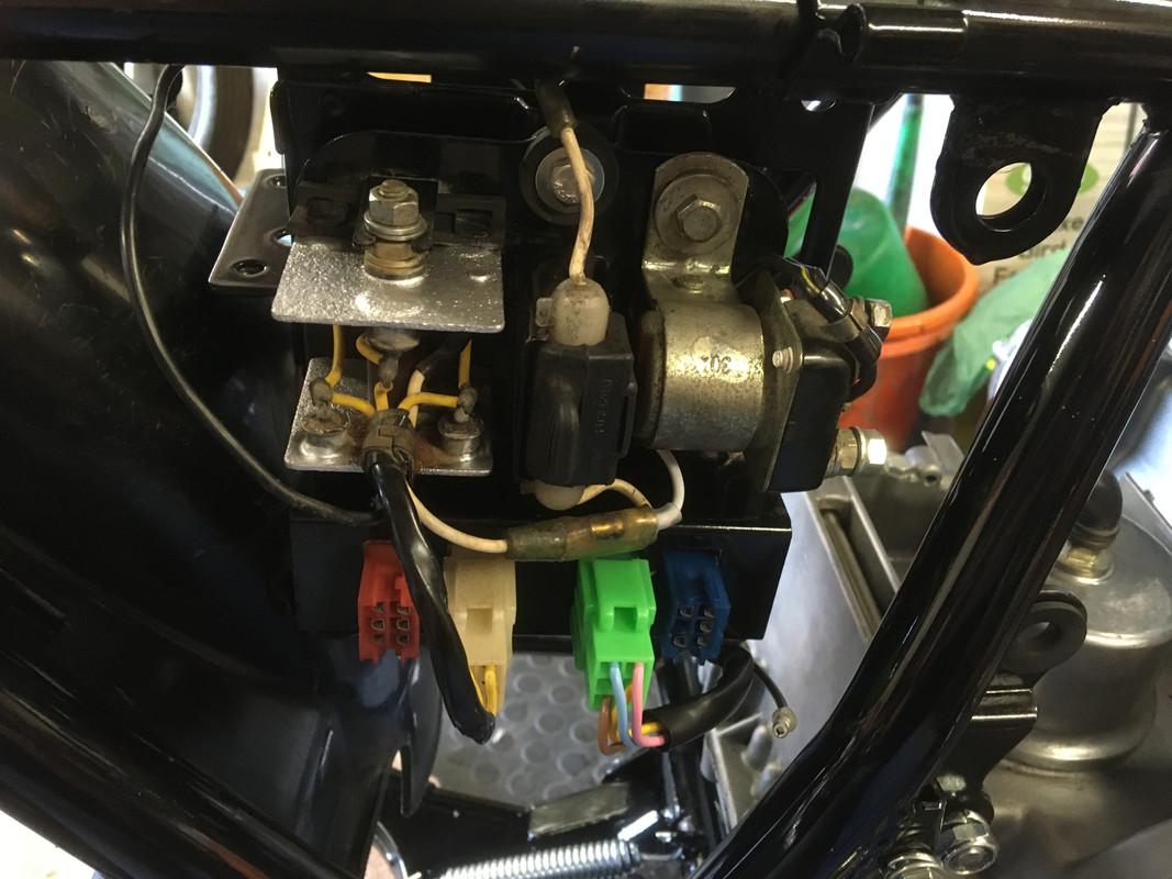

Bracket paint touched up, replacement rectifier and wiring fitted. The fuse was 15A and the glass was broken, but there were two original 20A ones hiding in the rubber damper.
That done I couldn't resist fitting it, also my brand new regulator was fitted under the battery box and plugged into the green plug. The alternator plug is the blue one, the orange one goes to the main loom. These OEM electrical block connectors may be a beggar to source, but the make wring a lot simpler than the usual fight with coloured spaghetti that I am used to, :) A flasher relay has been ordered, that slips on to a tag on the left of the bracket.
