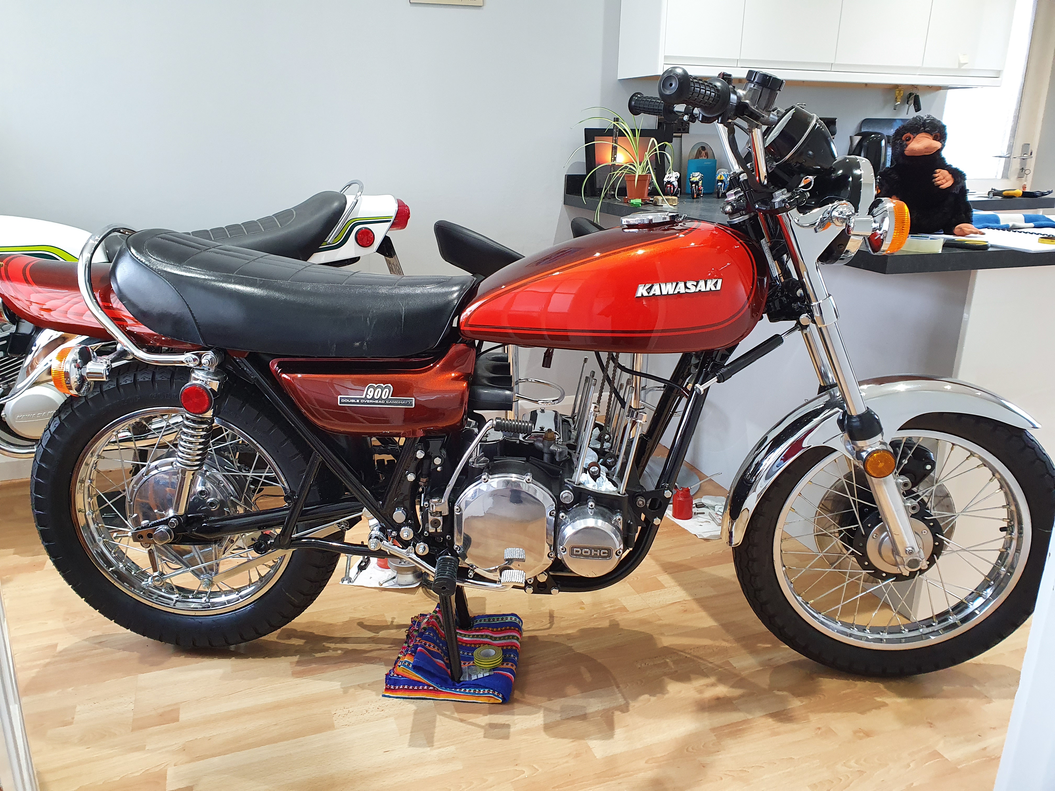

Currently restoring this '72 Z1 and fitting a new front brake light switch.
Question is, do you need to apply any sealant to the threads to prevent it leaking or just screw it in tight?
