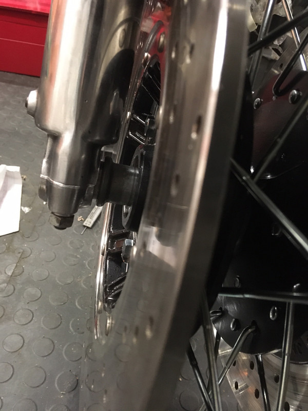

Here's a photo of the gap, between the spacer and the fork leg, this is with the shoulder on the speedo drive hard against the other leg, obviously I can move the gap across, or halve it and have a bit of a gap either side. The polish marks on the spacer seem to be from when the chrome cover was fitted, rather than a second disc.
I'll tighten up the yoke bolts tonight, with the mudguard removed, and let you know what happens.

See my thread in 'projects' - Phillipe has come up with spacer measurements, mine is 3.5mm on the short side. Mystery solved, by the look of it
Now to find the right part 41069018 according to the parts book. Johnny's in the US has them if I can't find one nearer. Thanks again this board is a mine of information.
