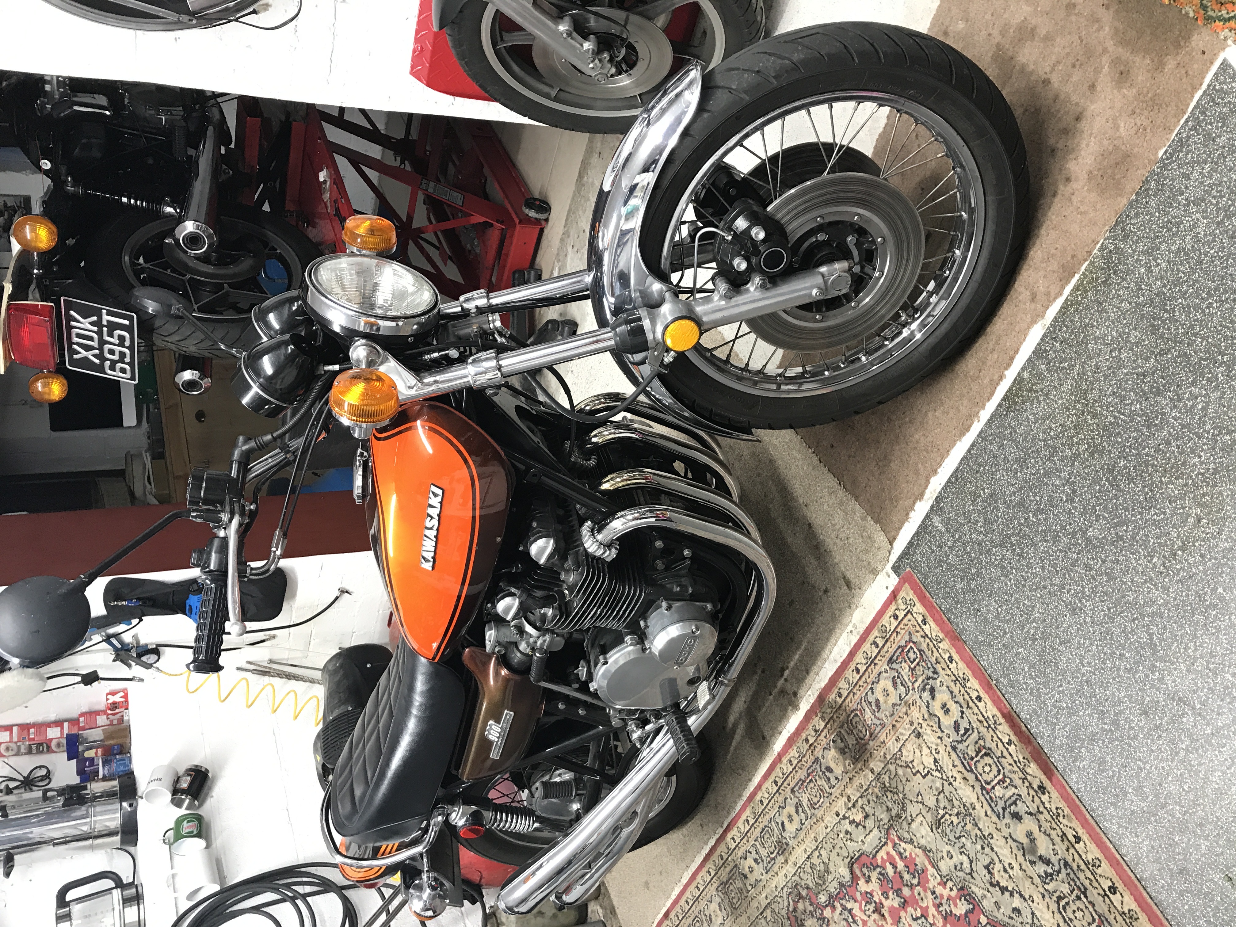

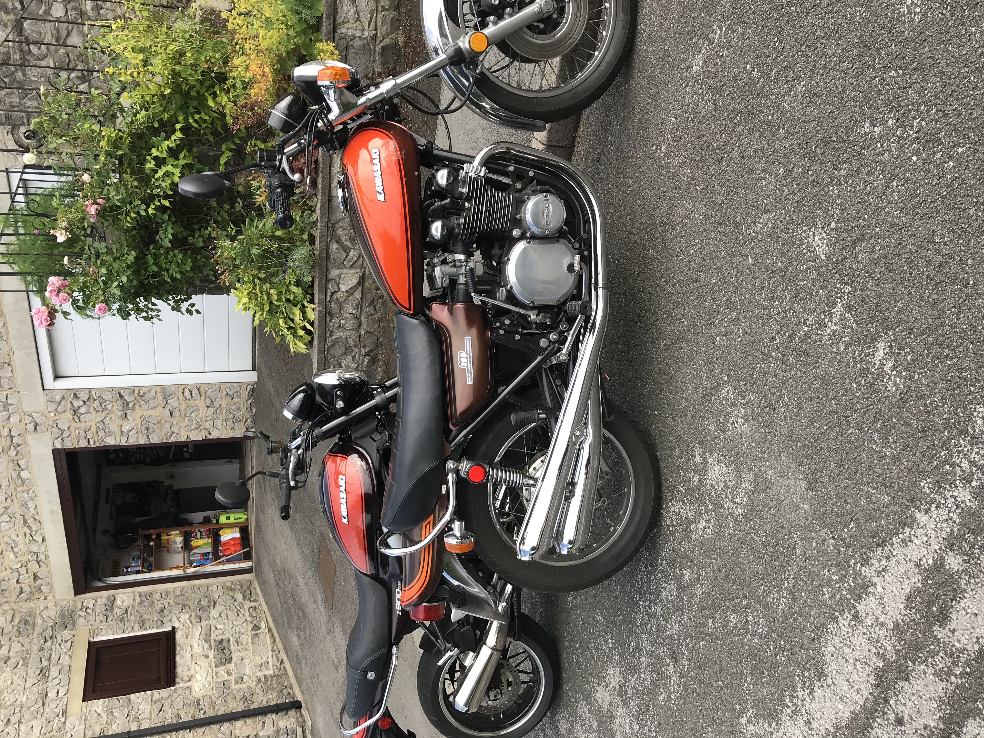

I recently put twin disc set up on my 73 Z1 and agree they look better, i bought the whole kit of Phil of Zpower Fame :)
it arrived super fast and fitted spot on job done.

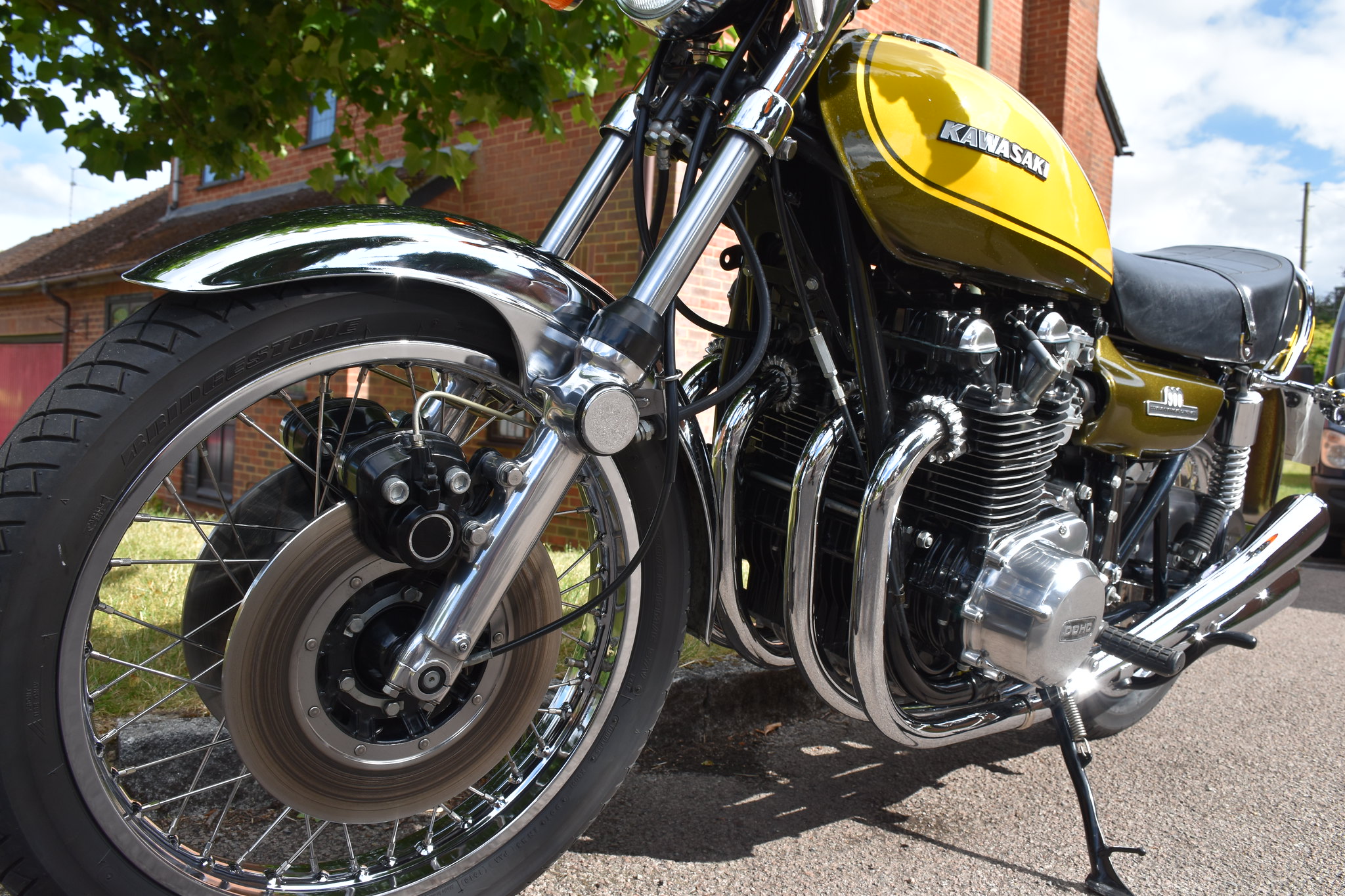

Yep, always nice to be able to stop better and looks nicely balanced - this is my mate Dave's Agrati imported 73 UK Z1 (now sold) with what is believed to be the factory set up.

Andrew_s wrote:Yep, always nice to be able to stop better and looks nicely balanced - this is my mate Dave's Agrati imported 73 UK Z1 (now sold) with what is believed to be the factory set up.
What a stonker of an example.
