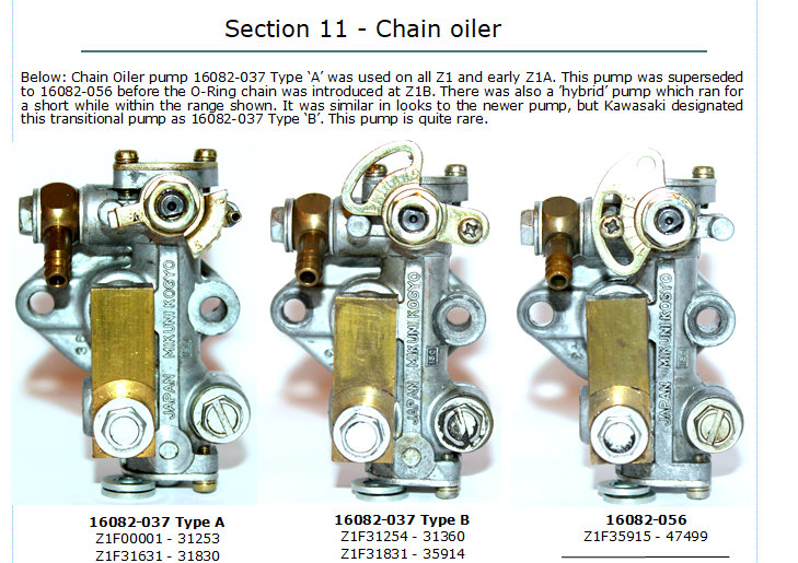

What is the difference in the early chain oil pump, on holiday so don’t have my usual reference material in front of me. Thanks in advance.

harri183 wrote:What is the difference in the early chain oil pump, on holiday so don’t have my usual reference material in front of me. Thanks in advance.

Cheers am I correct in thinking the date code on the type a is June 73?

harri183 wrote:Cheers am I correct in thinking the date code on the type a is June 73?
yes
