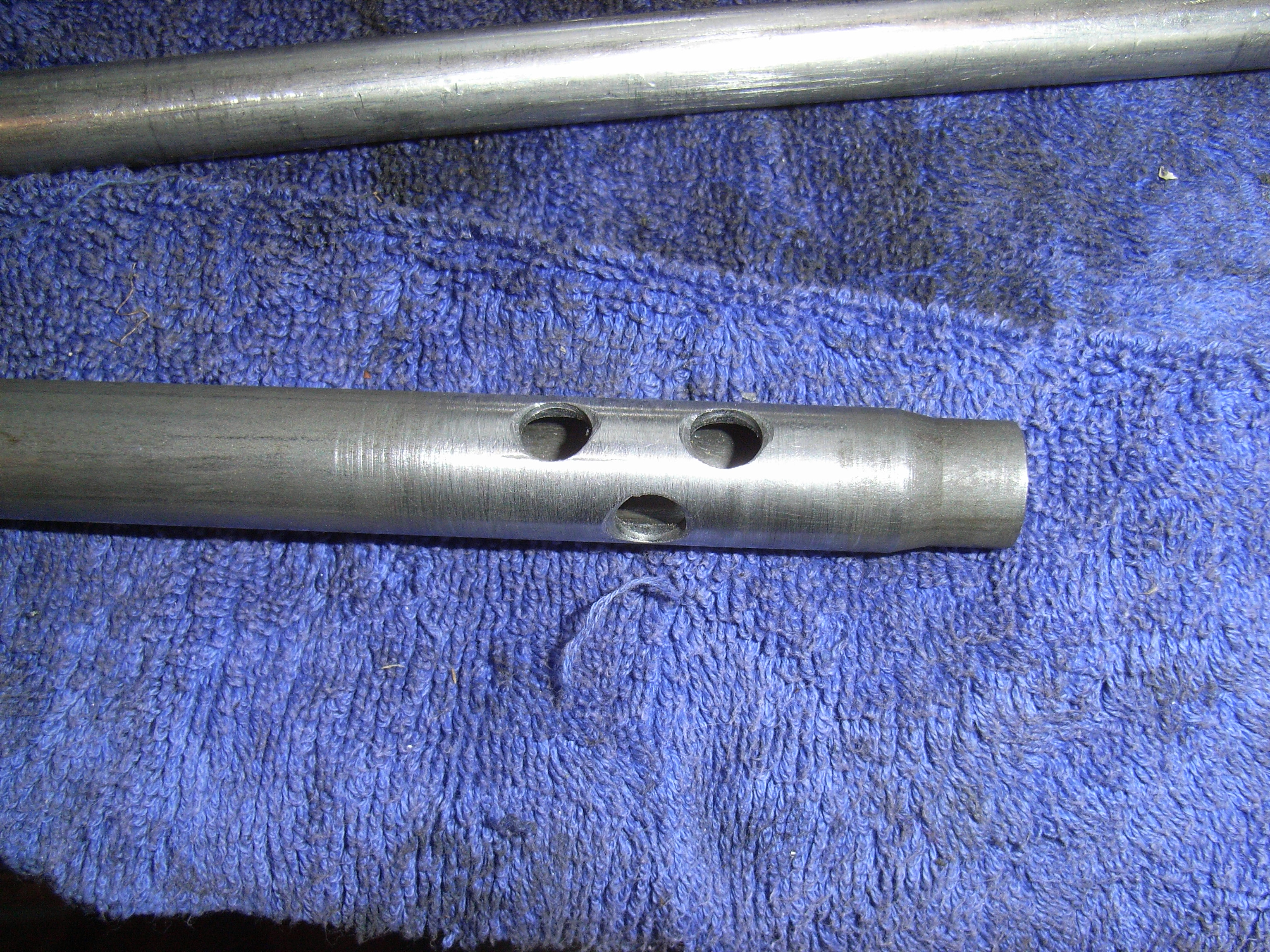

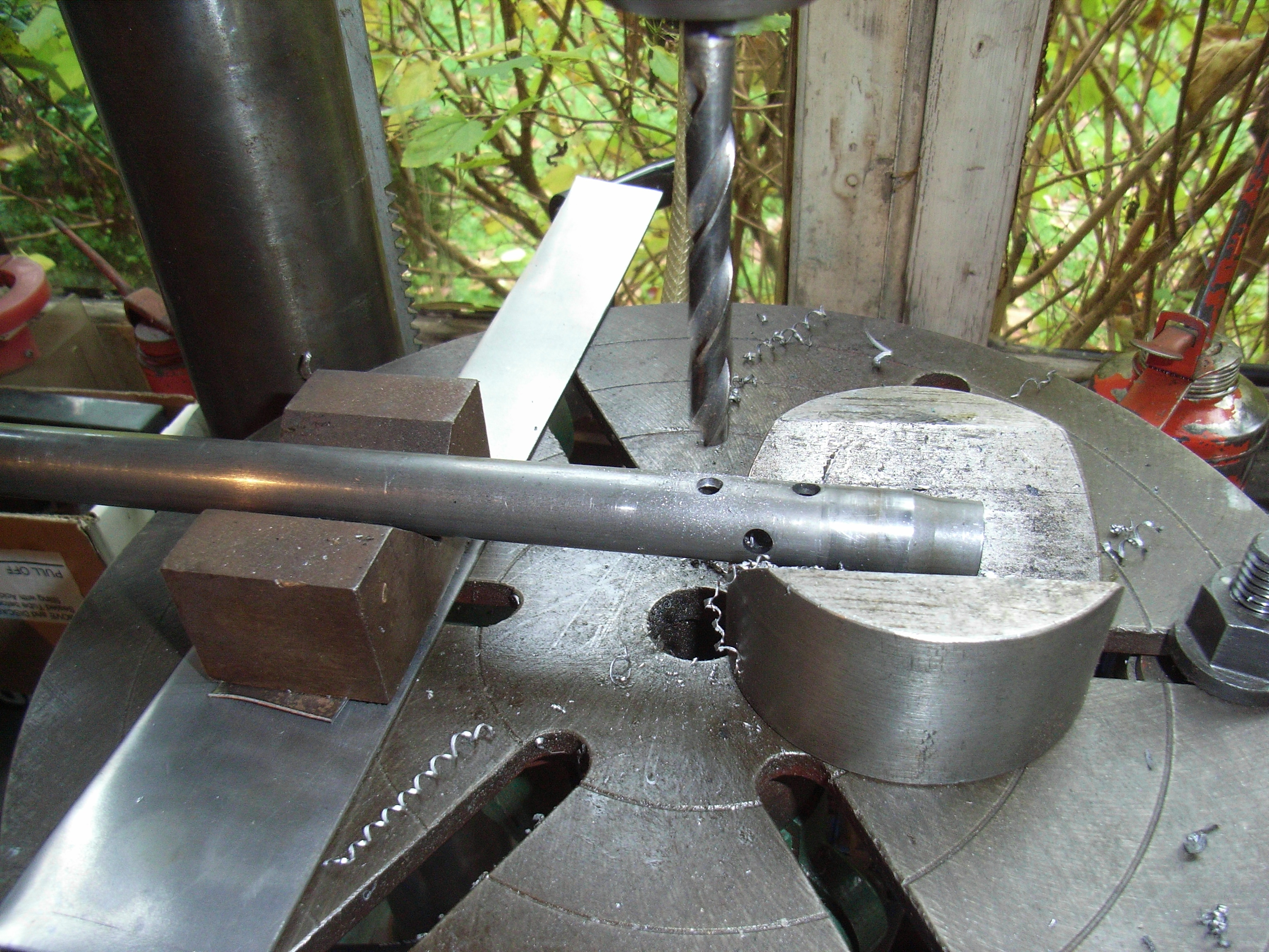

Damper rod: 6no. 8.5mm holes drilled.

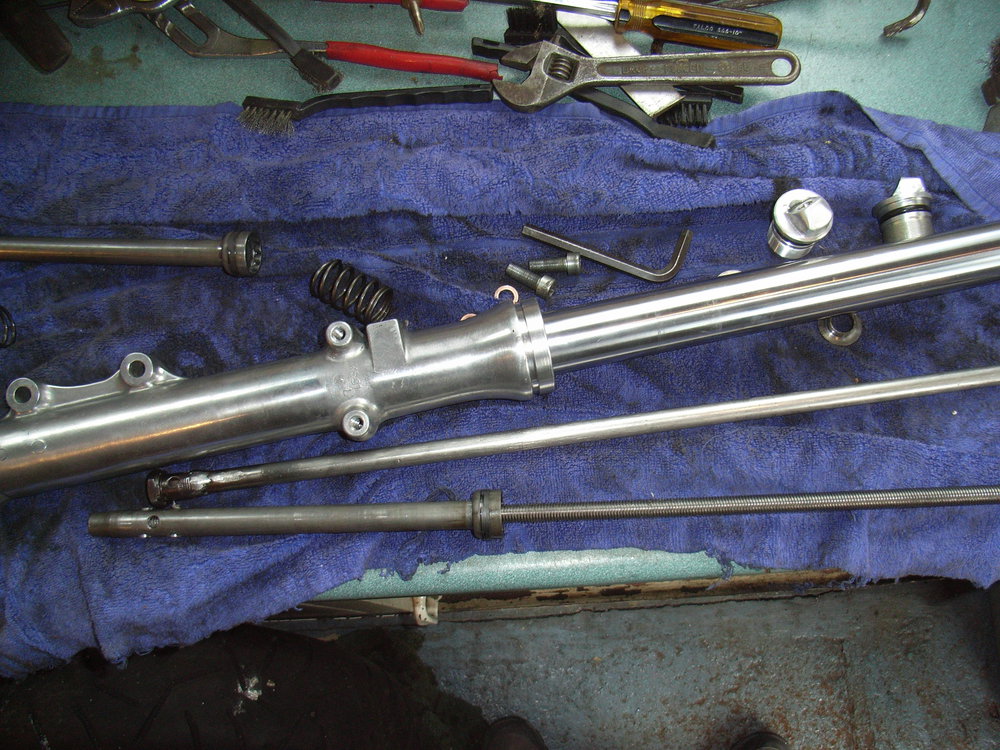

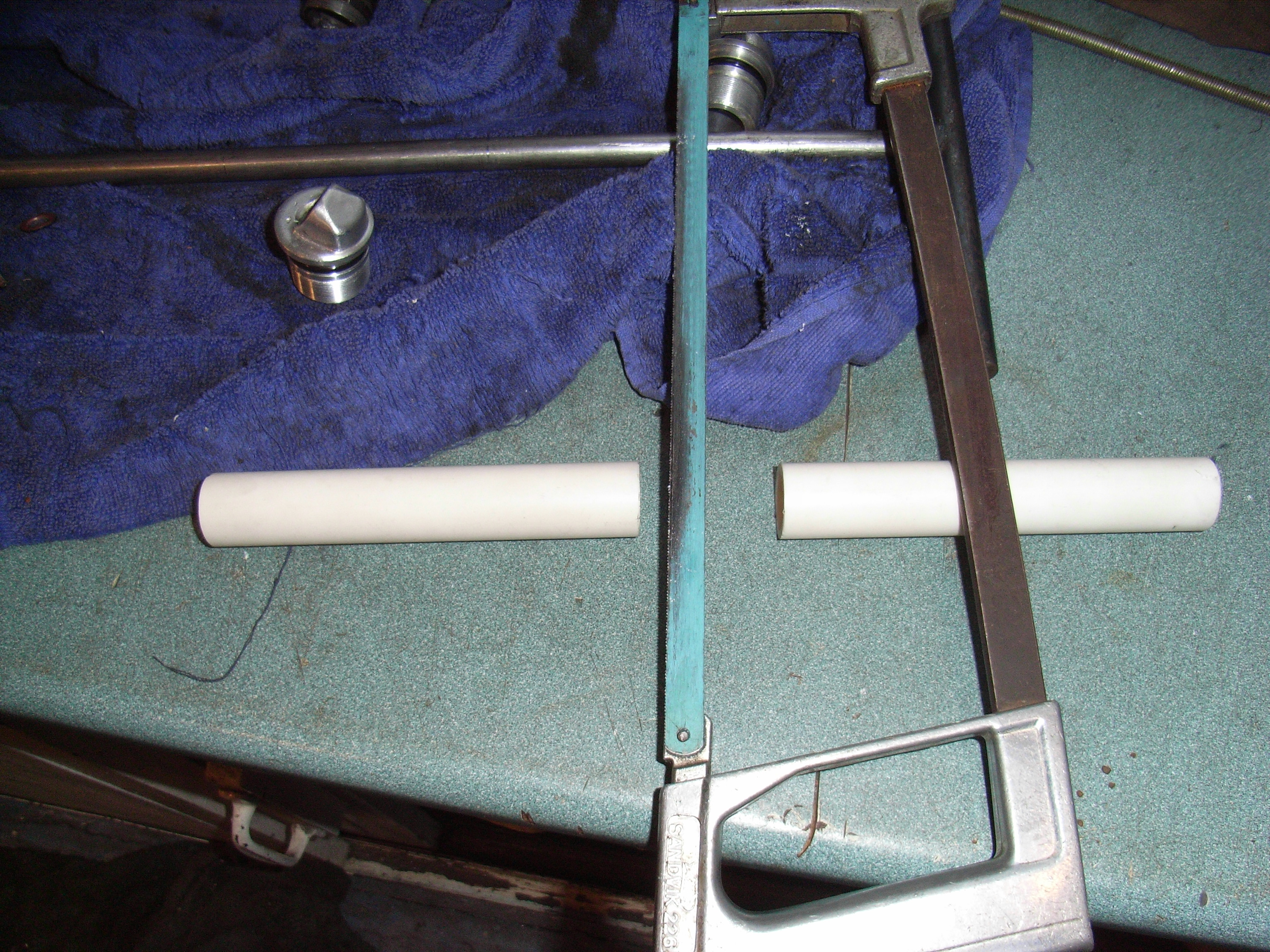

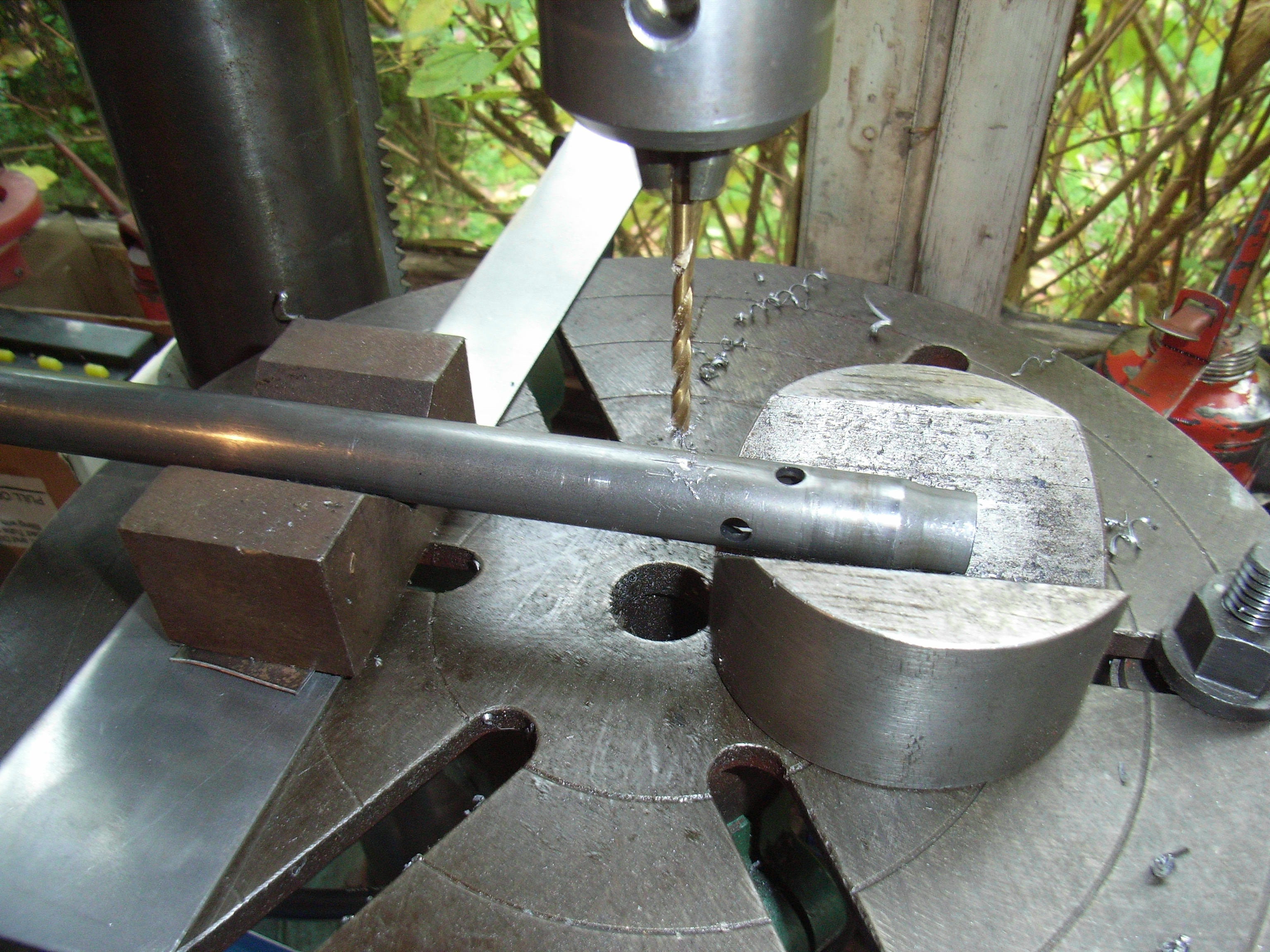

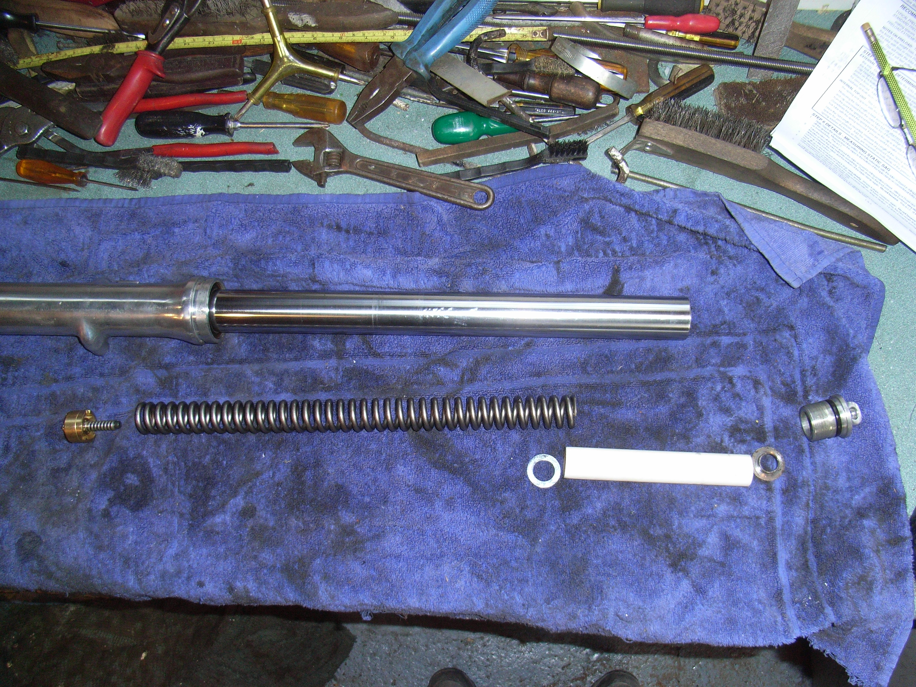

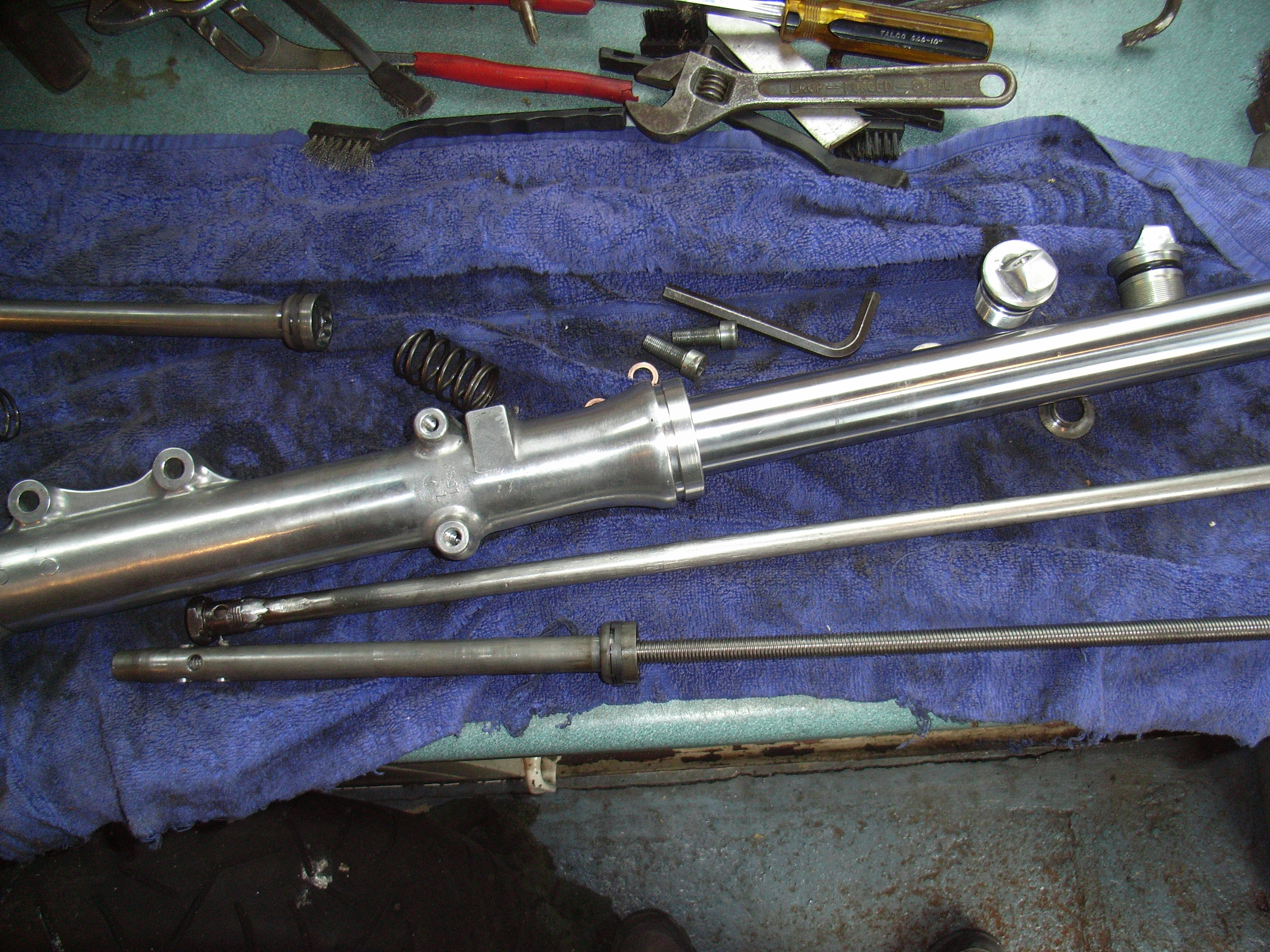

Looking at replacing the original pics which were posted in Photobucket but are now absent so found these instead.
Small hole
De-burr larger hole
De-burr internally with a length of studding
Clean up externally
Cut spacer tube to length
Order of assembly

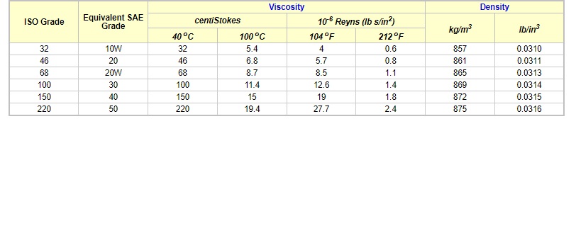

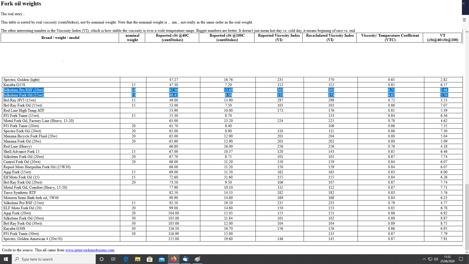

APPLES AND ORANGES. Been sitting on this for a while but due to the cancellation of trackdays to date have not been able to evaluate any changes.
What i can say is that mistakes have been made!! Figures are tiny but the two i highlighted rows show the approx range i was working in. What eventually became apparent with the appearance of this chart,... Thanks Brian 1100R and Mr Mahonkin, Peter Verdone, was that Silkolene (my chosen manufacturer) used not to have a continuity policy through their range of Pro and standard fork oils.
I assumed wrongly that they were interchangable when it is clear that they are not / were not. I believe they have now settled on a single viscosity index between the two product ranges!!!!
Looking at the two highlighted rows you might notice that initially: Pro RSF 10W is twice the viscosity of their 15W listed immediately below when at 100 deg. C but the same at 40 deg. C.
Its the same for V.I. when re-calculated.
Its not until you get to V.T. and divide the 40. deg. C value by the upper range at 100 deg. C, that things start to be the right way up.
From a practical perspective; i had used say 10W and believed it to be 'too thin'. Then changing to what i believed to be a higher viscosity (15W) gave a very different set of problems, complicated not least by the fact that the viscosity changes with temperature and at some point along that temperature change they switch sides!!!!
That represented about two seasons of head scratching and a great deal of fork oil changing!
Looking down the list its also easy to see that for this example; Silkolene Pro RSF 15w is twice the viscosity of Silkolene 15W fork oil
The full list in full size is available from the link at the bottom. Or you can click to zoom just this selection.
http://mahonkin.com/~milktree/motorcycles/fork-oil.html

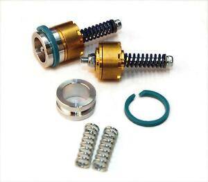

A couple more thoughts; I had been aware for a good few years that the very early J forks had only one pair of rebound springs and that later versions had two pairs stacked one above the other. I had failed to see the significance of this and had just assumed that rebound was rebound. I bought a pair of B model forks recently (thank you Scott) and they had the four spring arrangement as per standard for that model. One of the issues with my fork set-up is that; under hard acceleration, particularly out of corners, the forks would hyper extend. This changes the steering angle and the rake and trail characteristics at precisely the point where it is most critical. "fastest rider is not the one who gets on the throttle first its the one who gets to full throttle first" Un-quote etc etc etc. These extra springs resolve this issue to some considerable extent. Clearly an issue that became apparent after release of the first model J's.
There has been some suspicion that at the point of initial bite of the front brake and the moment of the onset of compression of the forks that the up-rush of oil through the old damper rod; lifts the emulator off its seat for a fraction of a second as the oil would rather go round it than through it. On 100% full front brake the forks would oscillate / spasm momentarily.
Coose was looking at machining a groove in the emulator body and turning up a pair of the nylon 'piston rings' as per the damper rods come equipped with. This would oblige the oil to go through the emulators and not try to go round. However it seems he was not the only one to have that great idea.
These particular ones (above) are not listed for our bikes but since some models (Z1R etc) need an adapter to correctly seat the emulators i can see no reason why this version with its piston ring could not be made to fit in its place or retro fit to J forks that dont need the spacer but would benefit from greater control of the oil flow. I will make some enquiries to find out a bit more about them and their availability / sizes etc.
