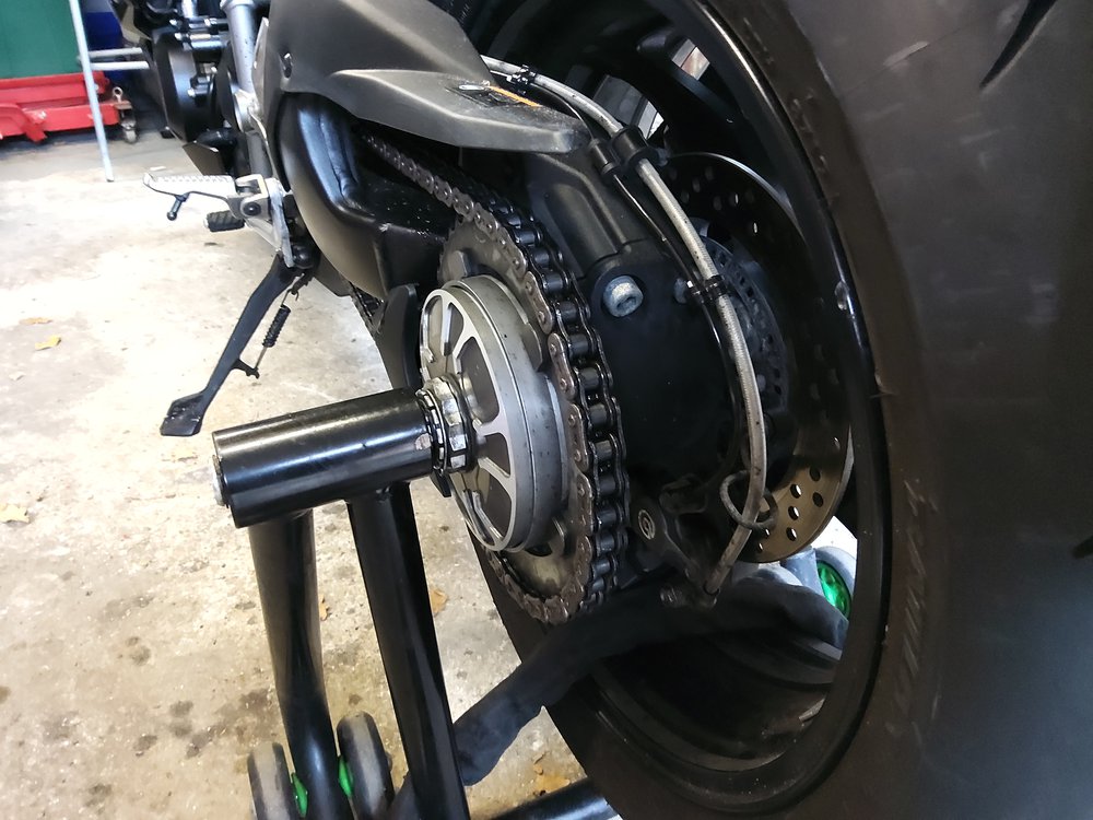

I don't think you'll have a problem with a 530 as it's slightly bigger than the 525 fitted to my modded Ninja H2 which is currently pumping out around 350bhp at the crank, and the chain hasn't snapped yet :D
Z1-B, 360bhp ZX1000NGF
