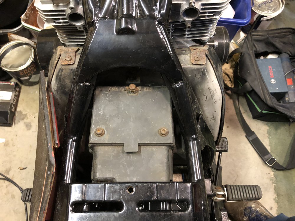

#3 PostAuthor: popsA1 » Thu Nov 12, 2020 3:22 pm

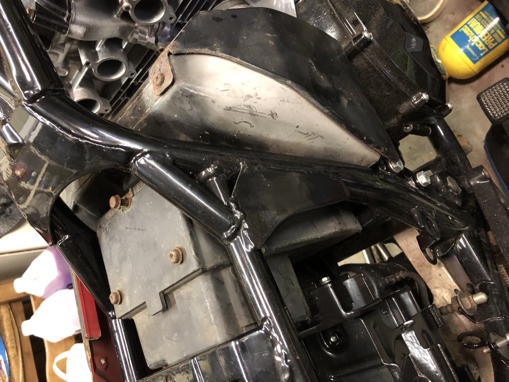

Here’s a couple of pic’s of the airbox in the Unitrak frame. There’s no free space in any direction.
If you look at the ID pic’s in the workshop manual, compare where the crankcase breather lines up, you can see there’s 20-30mm difference between the injected and carb’ed models.

Try a gpz 750 unitrac airbox. Fits a treat in the gpz1100b2. A z1000j airbox won't fit in a b2 - too long. If the 750 one fits (it probably will) cut the snorkel bit off of the lid and put a k^&n filter in there.

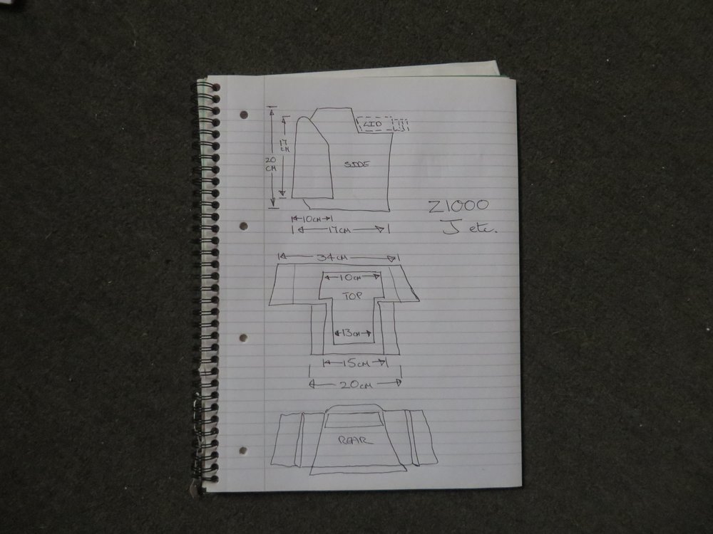

#8 PostAuthor: Al » Sat Nov 14, 2020 3:17 pm
Airbox still in the bike so not so easy to do but this should be OK. If not let me know and i can take a pic or something.

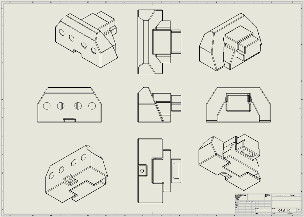

#9 PostAuthor: popsA1 » Sat Nov 14, 2020 11:17 pm
Thanks for that. I’ve modelled my Unitrak box in 3d cad. Then done the same with your dimensions.
I’m thinking the J box has the silencer in the lid whereas the Unitrak has the filter moved forward and the silencer on the end. This makes space for the fuel pump.

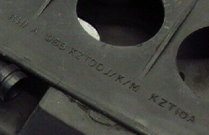

Does your airbox have any identifying characters under the carb rubbers? I found this on ebay.

Yes mine has the same numbers as that one you found. I cant see it, but found this one which should be the same thing with a few details exceptions.
https://www.ebay.co.uk/itm/Kawasaki-KZ1 ... 0667.m2042
The J Etc. airbox has the lid on top at the back and a snorkel as per the above link. I see they have a 30 day refund policy. Perhaps soak up the postage and return postage and try it and see. Nothing like trying it in the hole for size :)
Can you superimpose one airbox on the other to see where they may not be the same?

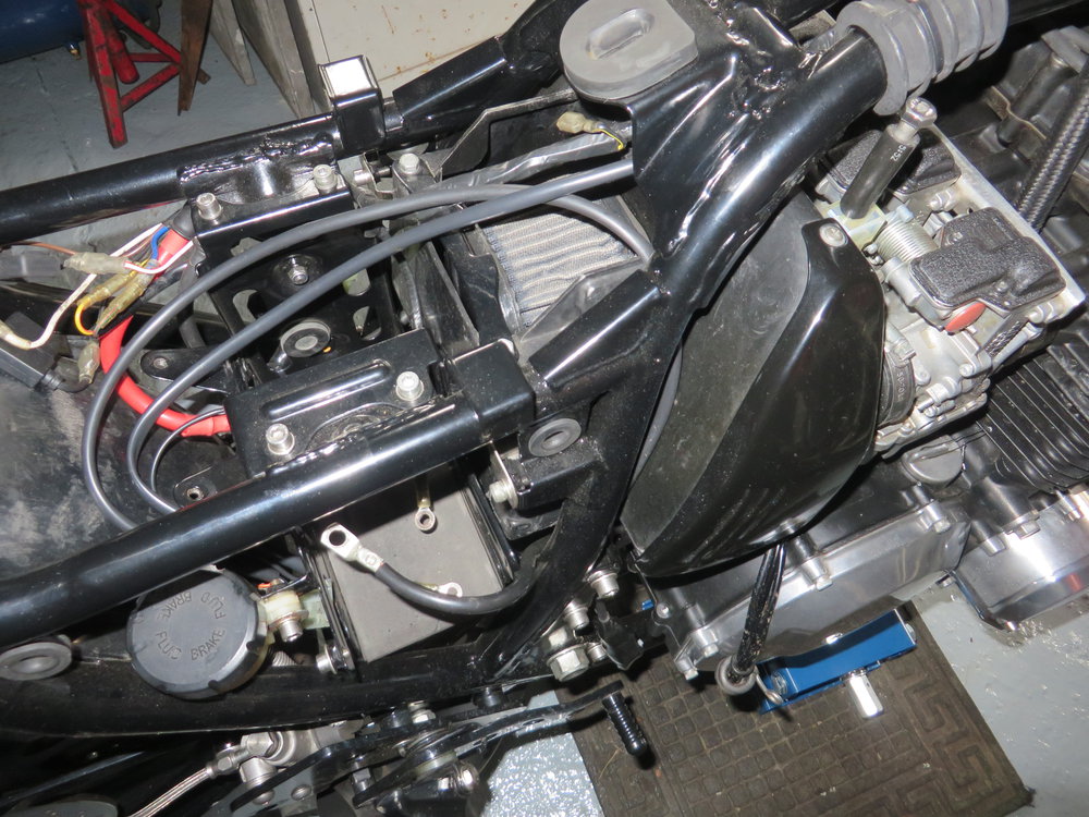

I dont use the lid or snorkel on mine but have made a small bracket to replace the lid since it holds the filter in place. I have taken a couple of pictures to that effect which i can post in a bit.
