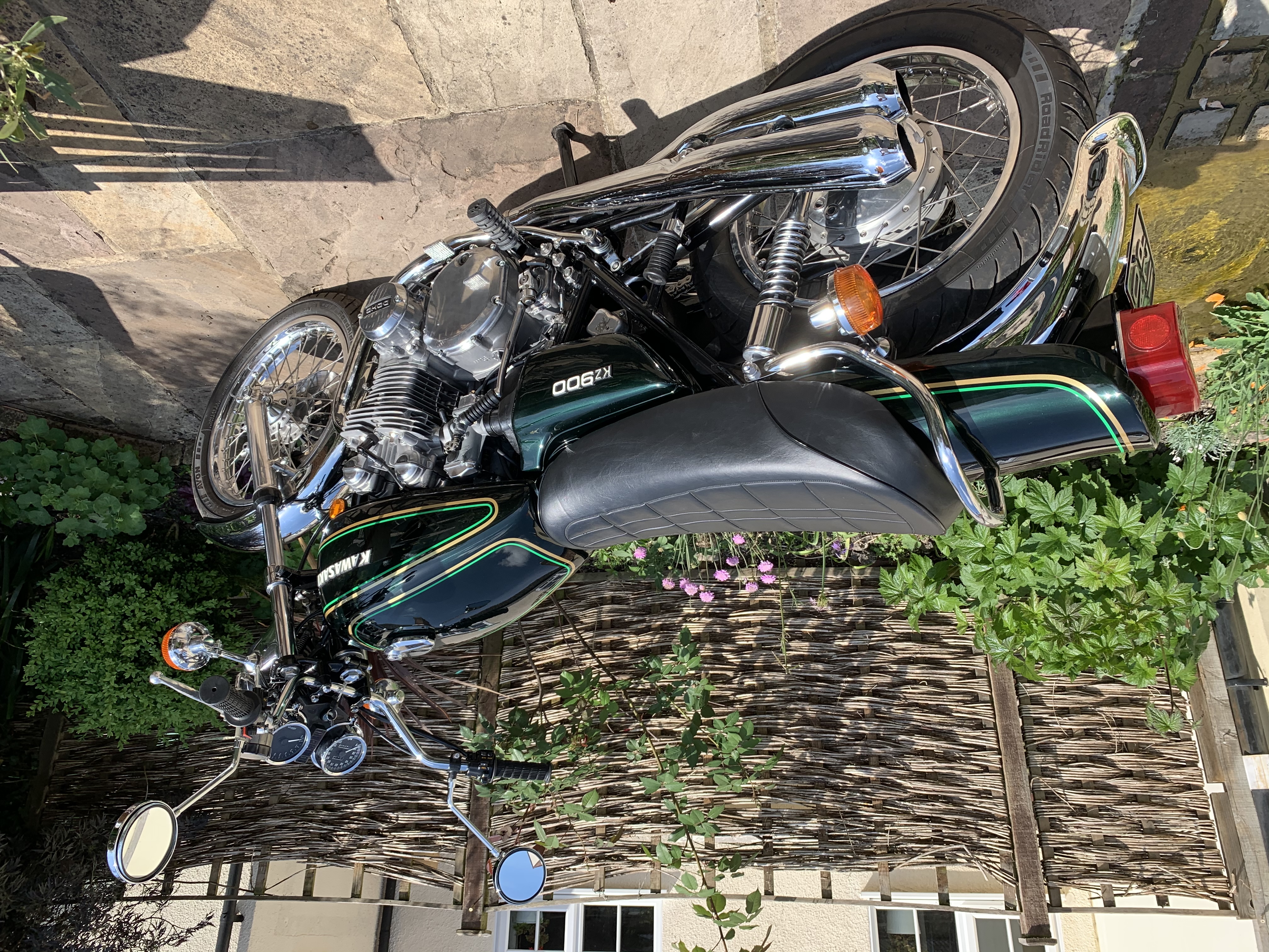

#4 PostAuthor: Garry.L » Mon Dec 21, 2020 11:39 am
Any help?....

Yes that helps, lovely bike you’ve got there.thanks

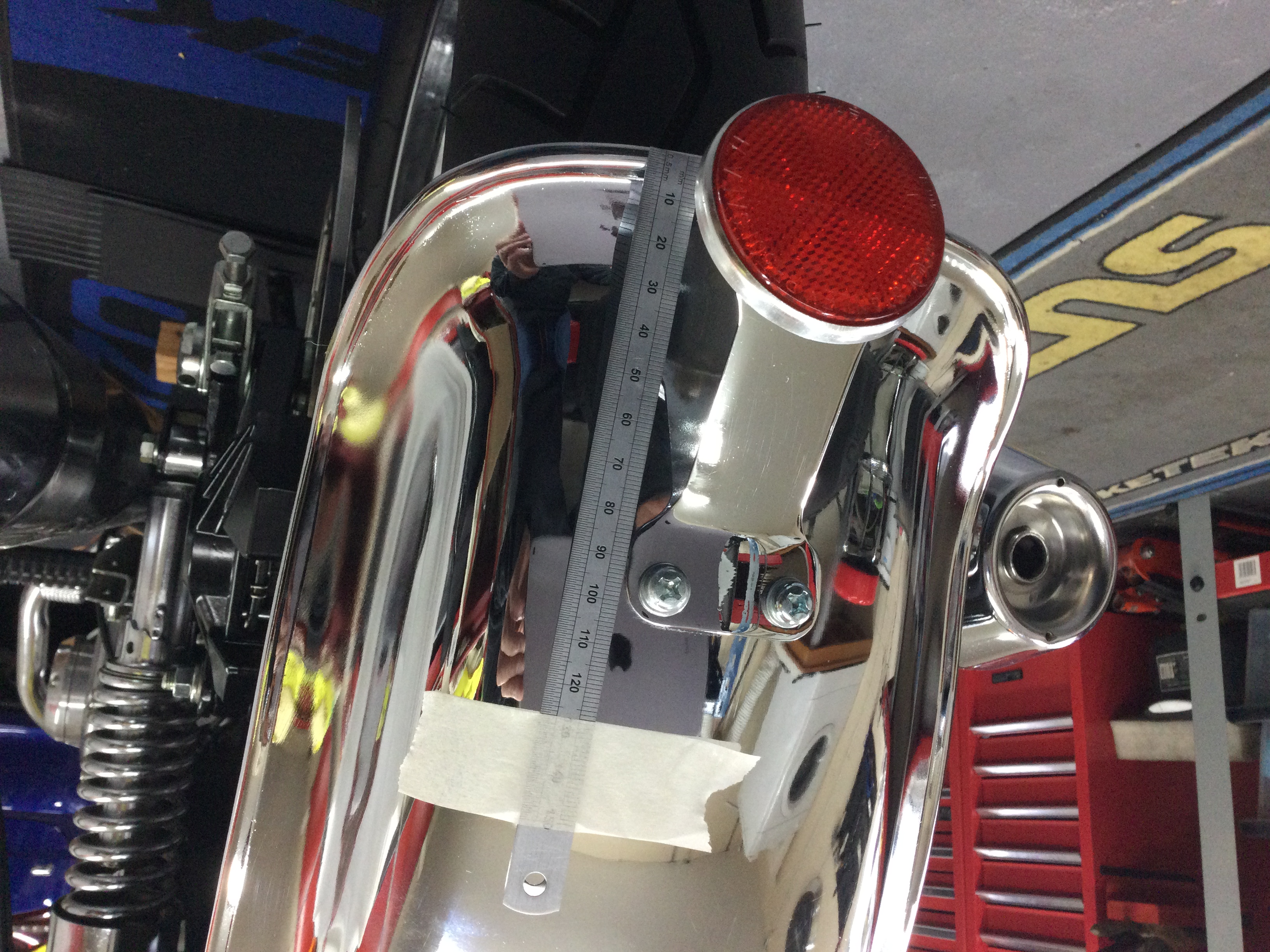

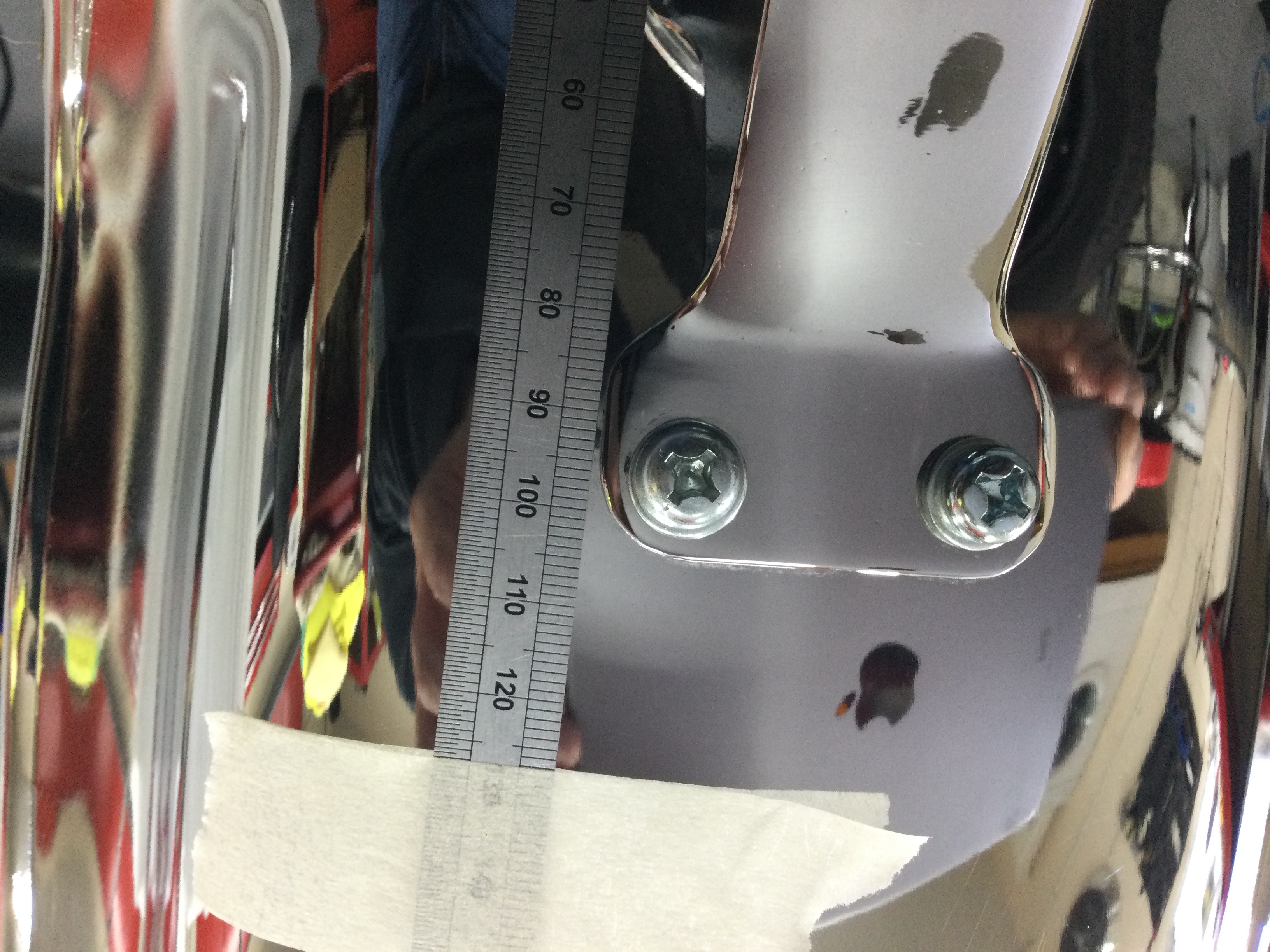

#6 PostAuthor: Mjay » Mon Dec 21, 2020 2:15 pm
Just measured the reflector bracket on my z1000 long mudguard.
From the bottom lip of the mudguard to the centre of the holes measures approximately 96mm. Hope this helps.
Please see images.

Thanks mjay, that’s exactly what I need.
It’s not an early z1, it’s a ‘76 Kz900c with a wider squared off bottom to match the light shape, so no good for a z1 :rock
