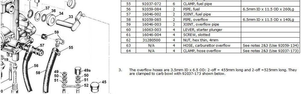

Can anyone tell me what ID and length pipes I need for my Z1A?
I need to make up the overflow and vent pipes for all four carbs, as well as the fuel lines from the tap, which I assume are a larger internal diameter.
Once I have the lengths and ID I'll probably try and buy a job lot, black nitrile tubing I assume.
Z1A carb vent & fuel pipes

Buy it by multiples of metres here. Much, much cheaper than mc parts suppliers.
https://www.advancedfluidsolutions.co.u ... r-90-c.asp
Re: Z1A carb vent & fuel pipes
I also bought mine from AFS for the overflows. I got the fuel lines themselves from Z-Power. The overflows were cheap as chips (though not as tasty), arrived very quickly and were perfect for my Z1-B carbs. I ordered 5m of the NT-003.5 (3mm ID).
I just guessed roughly the lengths for the overflows, added a bit and test installed the carbs. Ran the pipes through the rubber stay (my original!) and then cut them so all finished at the same point behind the engine.
Easy peasy.
Easy peasy.
Z1-B, 360bhp ZX1000NGF
Thanks very much for the information, I’ve ordered the overflow pipe tubing from AFS.
Using the information from John (what book is that?) it seems AFS doesn’t do quite the right size for the fuel and breather pipes, so I might also use the Z Power option. Making pipes fit that don’t quite isn’t an option for fuel lines. Where do the breather pipes go to?

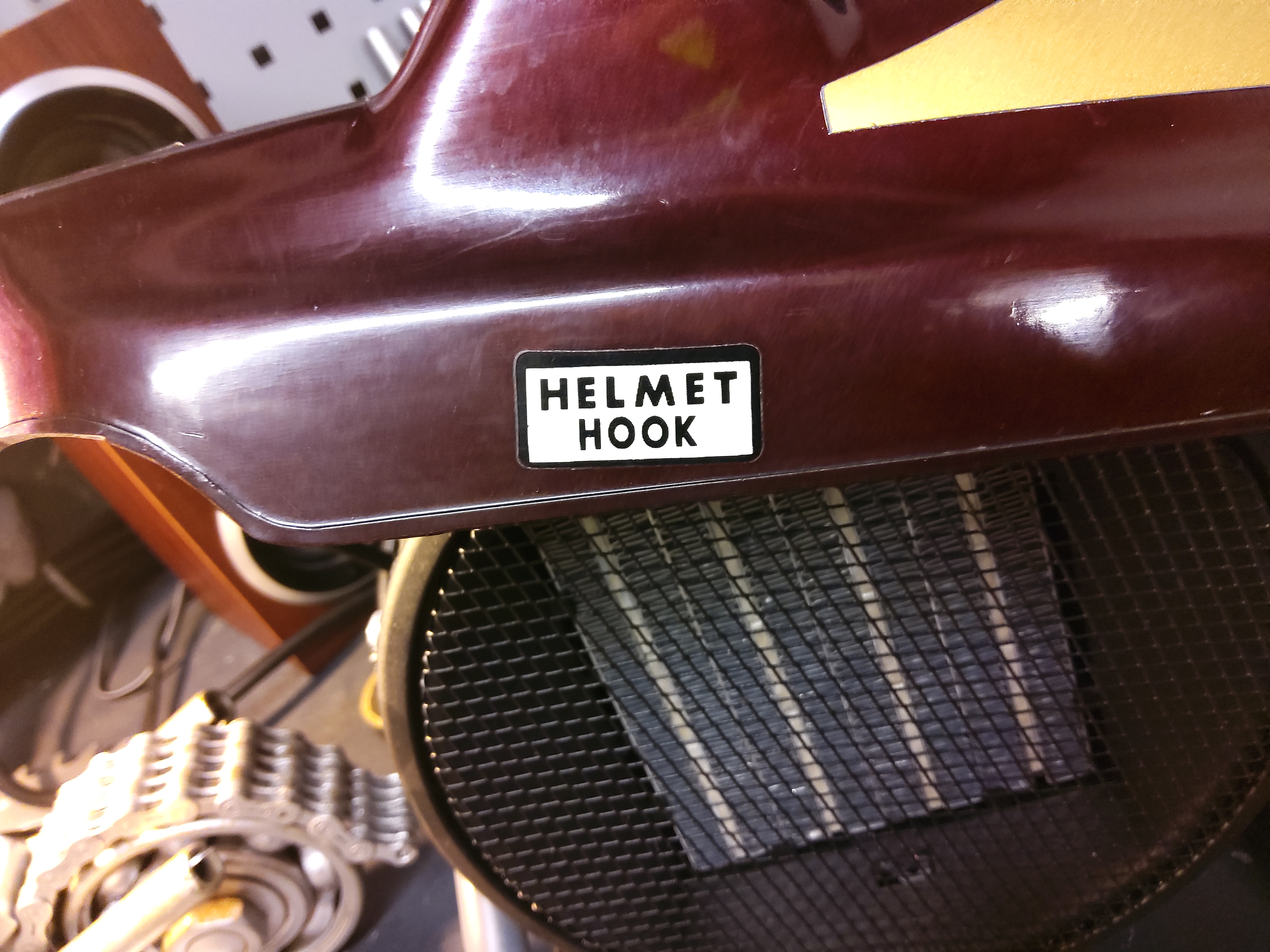

For example the horn I have fitted, although the right make has screws not rivets. Let's see who notices. Date coding is a nightmare if you want everything bang on, and lets not even check if my data stickers have the right font (ie 'Helmet' is NOT the same font as 'Hook').... I get John's comments about the anal aspect (probably a porn film title, let's see who Google leads here!) but it's such a resource to have the ability to check if a part is right, however if I had my time over I should have bought this first.

On the fuel pipe front, I now know how long to cut my pipes, and I've learned that the top breather pipes go through the hole in the frame gusset at the rear of the fuel tank.

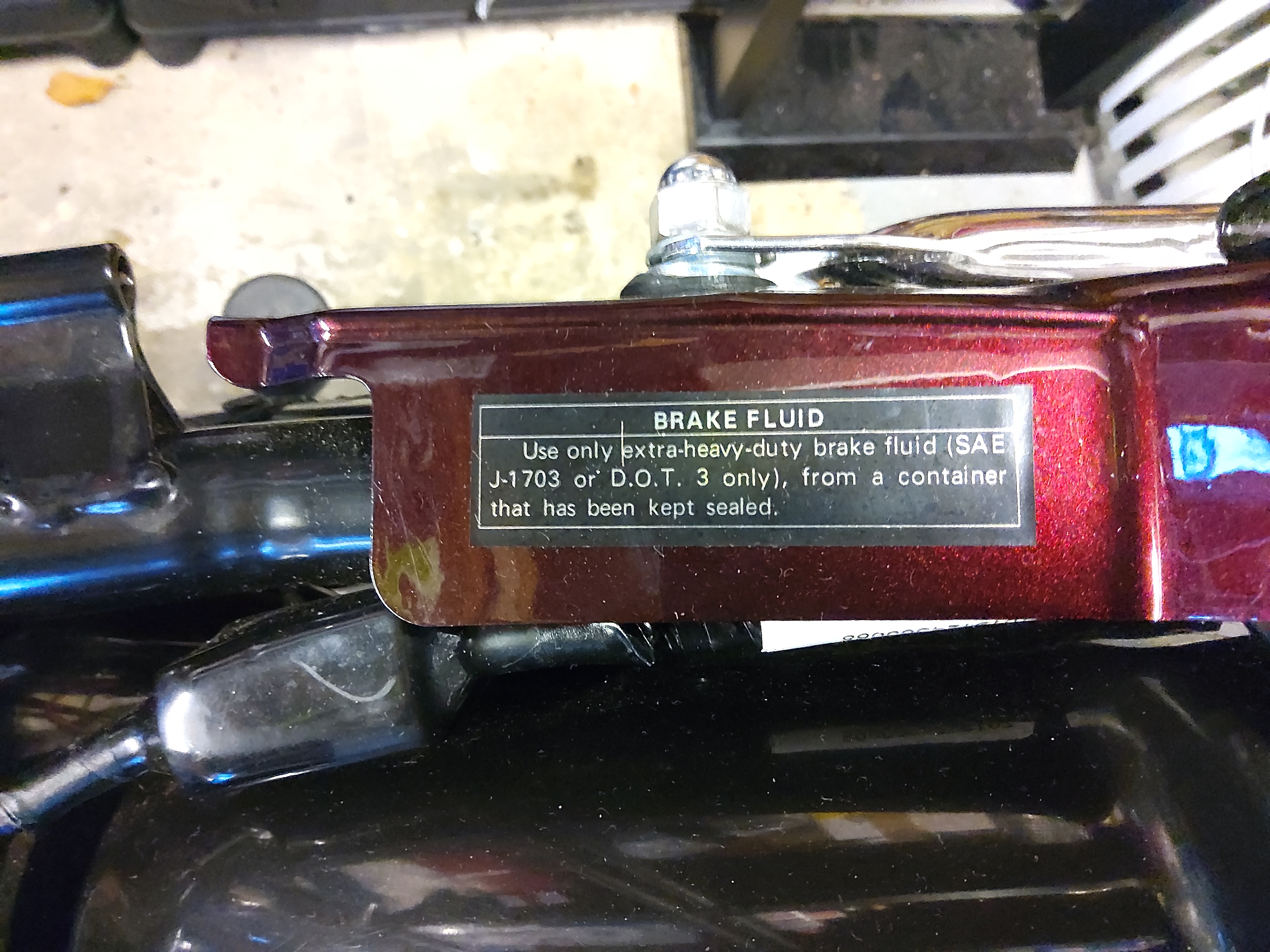

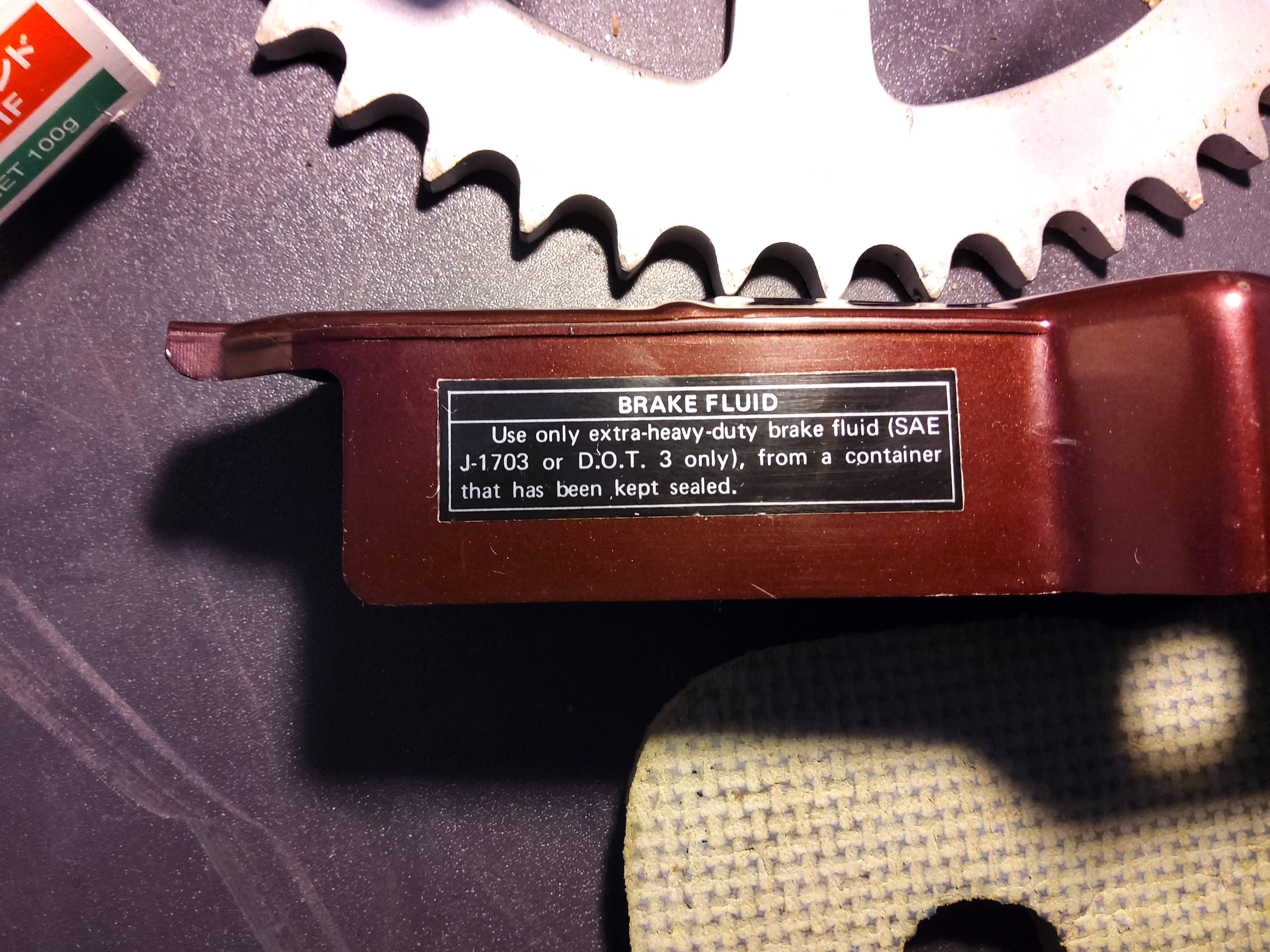

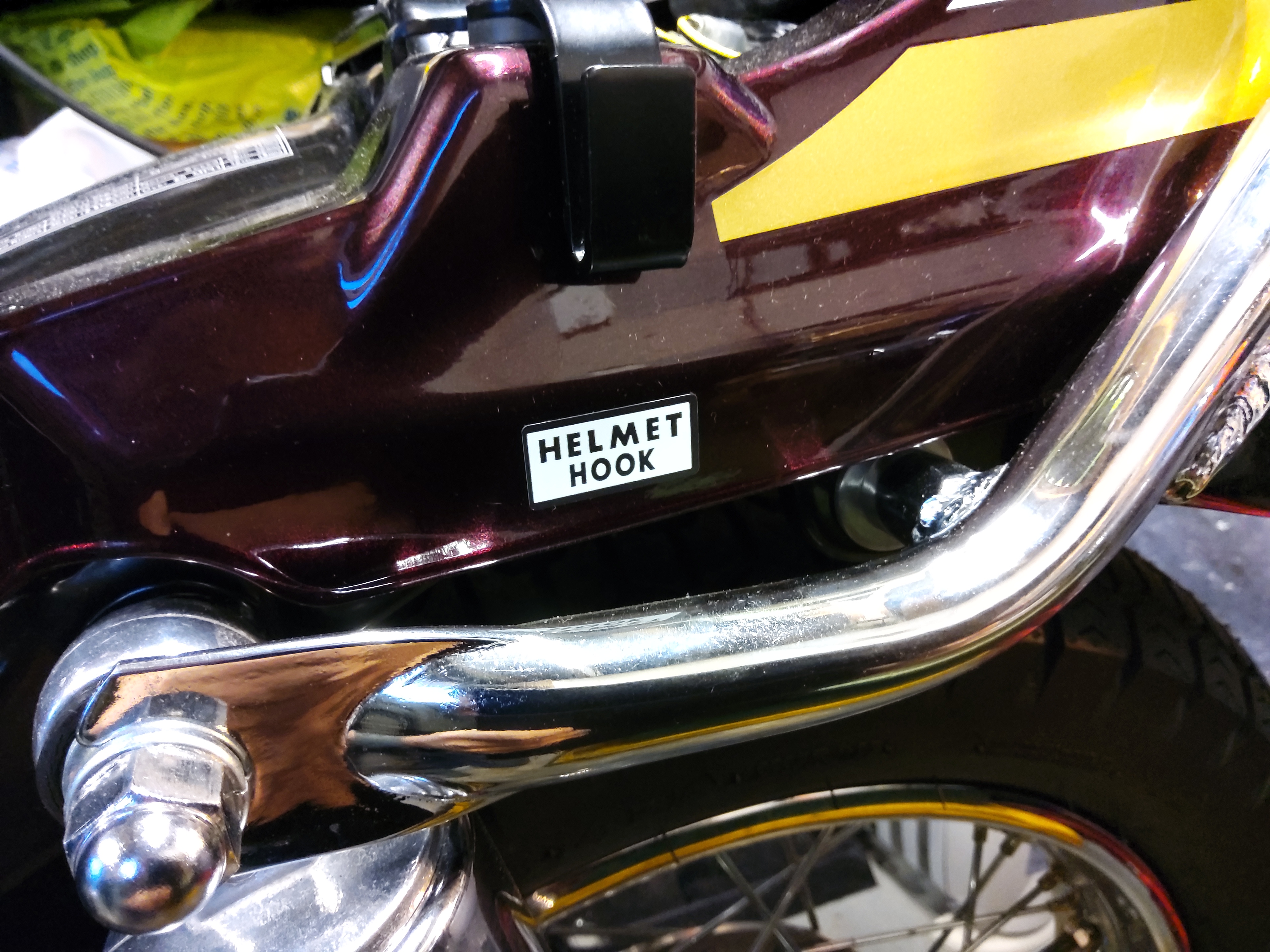

IMHO the important thing is not that these bikes are as they left the factory but that they are restored to running order and then used for how they were intended, on the road and track. Considering the mods and after-market kits that were produced for these bikes at the time it's a wonder any of them were "as factory" after a few years from new. If the rivet counters point out the "errors" on your bike just ask them how many miles they've done on theirs lately.

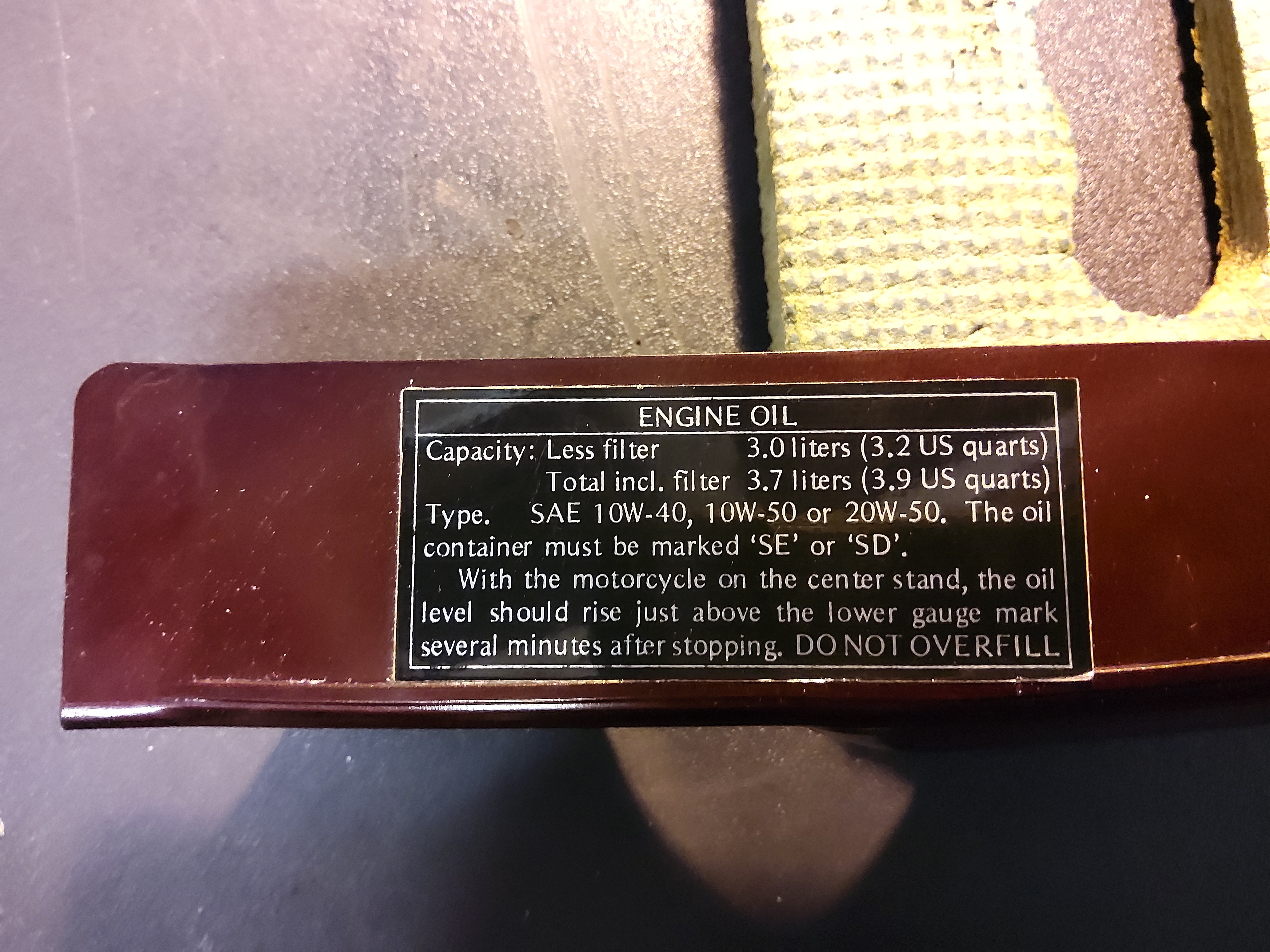

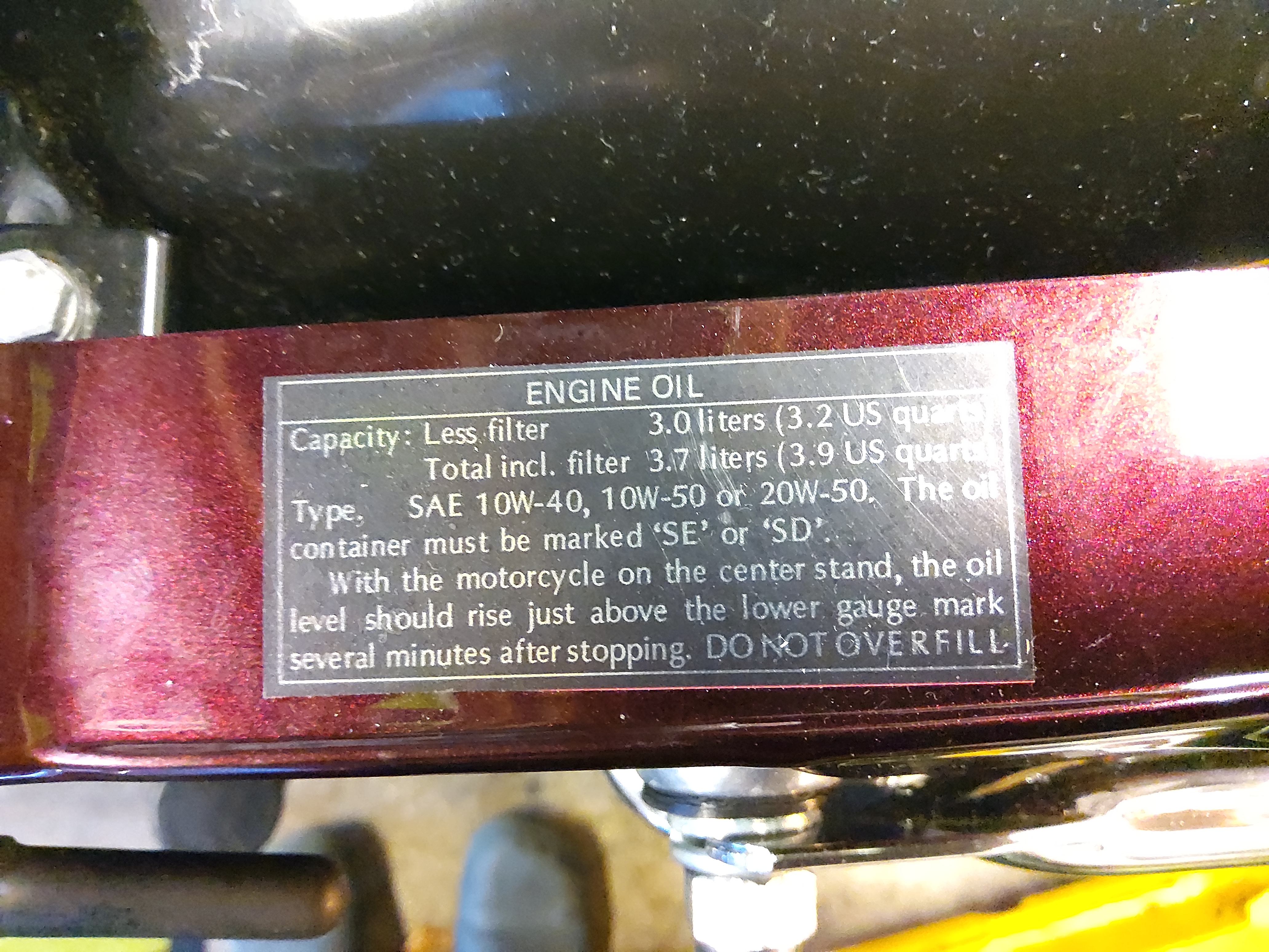

If you're interested in accurate repros of the decals turn to page 21 of John's book where he gives details of John Clifton's decals which are brilliant reproductions. My set cost the equivalent of about £35 inclusive of postage last year. They normally take 1 to 3 weeks to arrive (he's in Australia) but hit one of the lockdowns and the height of the pandemic so took about twice that. His contact details are in the book. I've attached a pic of them on the rear mudguard and ducktail.
I've also attached pics of the decals as they came from the factory (my original Z1-B ducktail).
