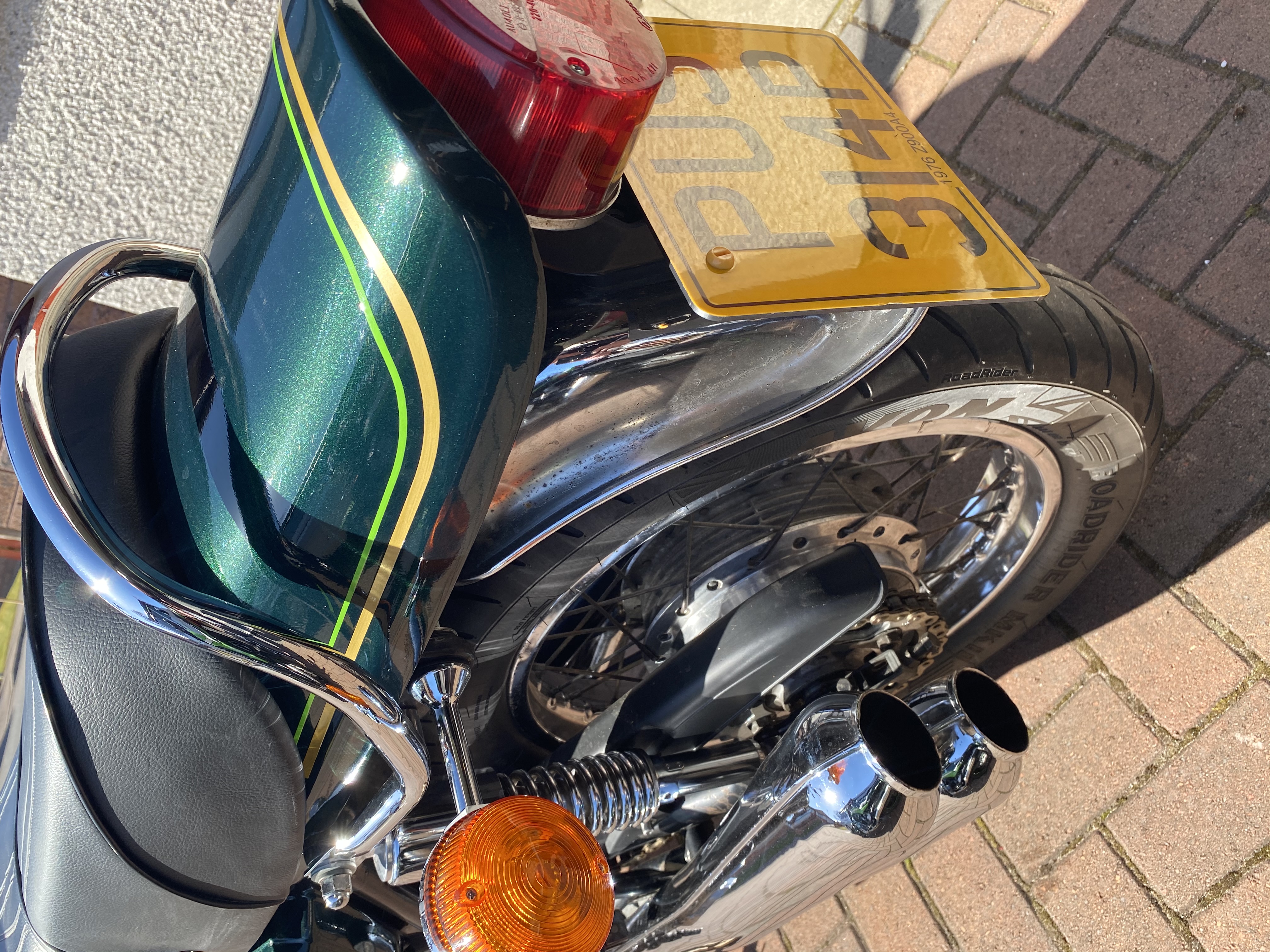

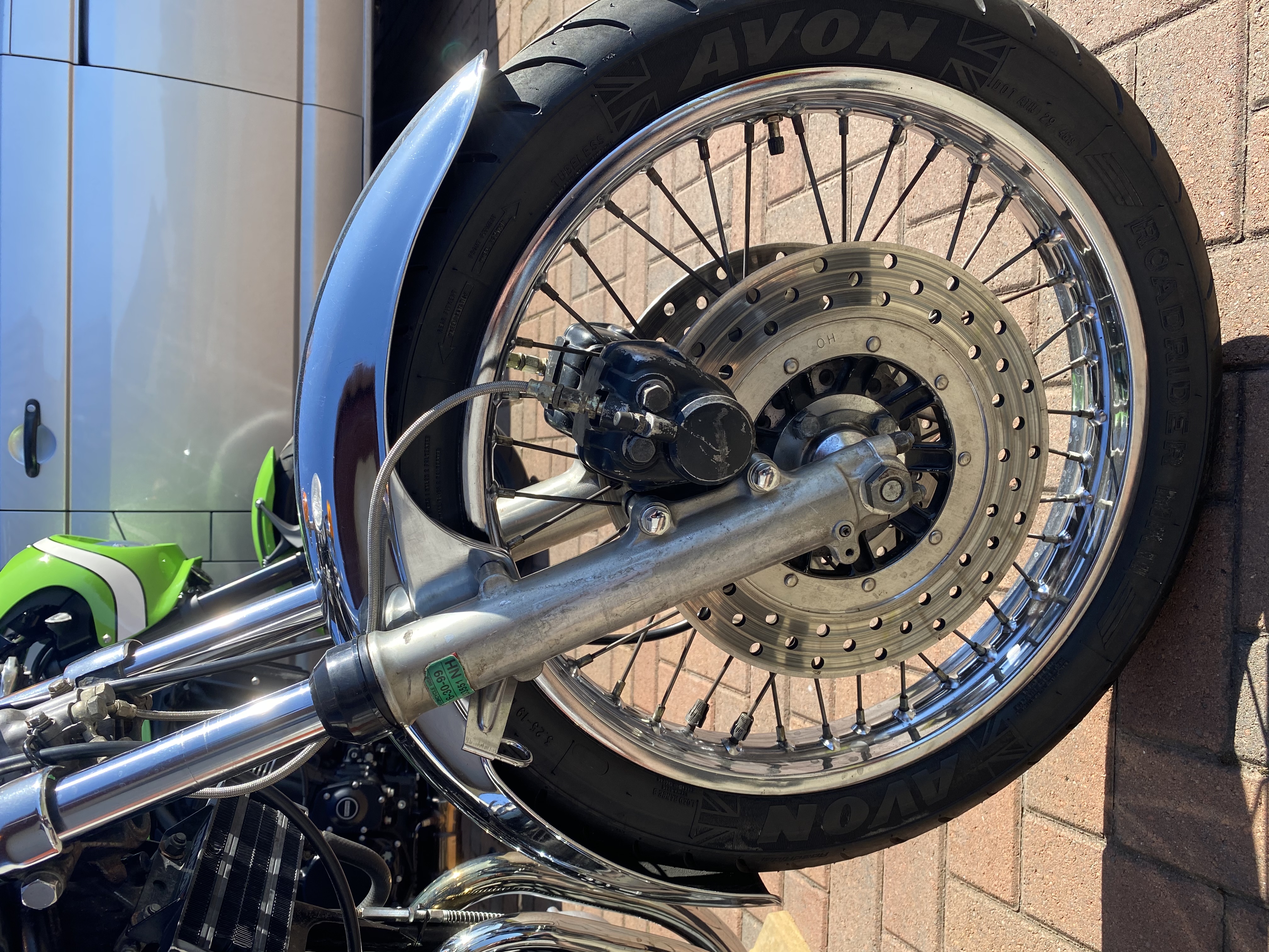

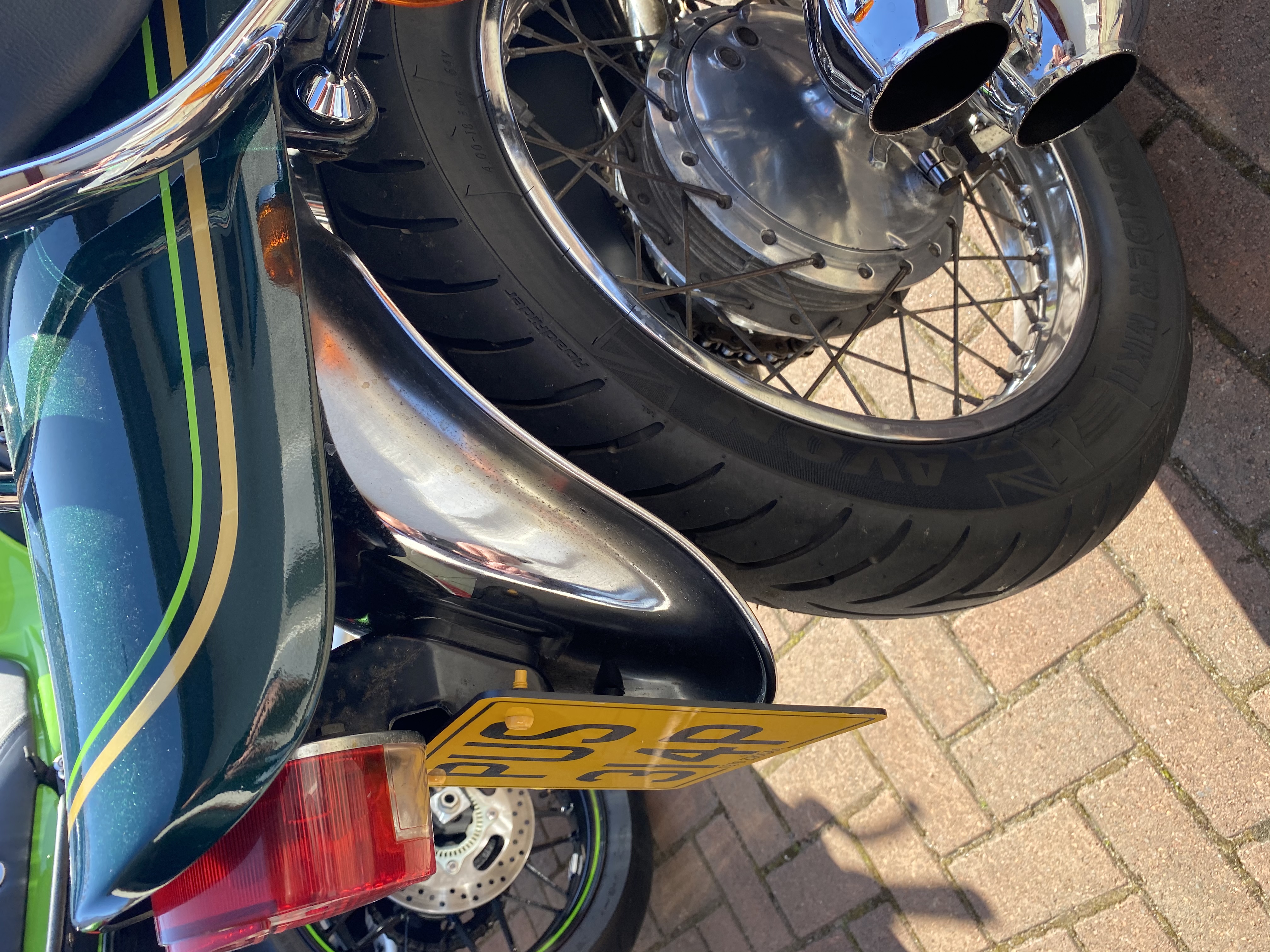

The mudguards on my kz are in reasonable condition but with pitting and look like they have been over cleaned. The chrome is dull.
I’m considering 3 options-
Rechrome
New genuine £500
New replica £300
Is there a way of telling if my mudguards are genuine and therefore worth rechroming?
Any views on the quality of genuine versus replica from the likes of Zed power?
Zed power seem to have genuine fronts but not rears
CMSNL have both genuine
How does genuine versus replica affect value.....although I don’t ever anticipate selling the bike.

The new genuine ones are not quite the same as the original ones, especially the front. The rolled edges seem to be smaller on the new gen ones I bought.
The replica ones are very good and I would say as good as the new gen items. However, my bikes don't see the rain ! I do seal the inside surfaces as they all start to corrode quite quickly.
If your originals are undented, I would get a quote to rechrome them.

Euro/UK models had a longer rear mudguard than the US market one's (your is the shorter US one).
If you're not going down the 100% correct & original route then just fit pattern one's as the cost of re-chroming won't be far off that anyway.
Re: Genuine versus replica fenders/mudguards?
They look good enough to rechrome. You’ve probably got someone local, but if it’s any help I can recommend Star Polishing in Wolverhampton, good prices and quick turn around.
