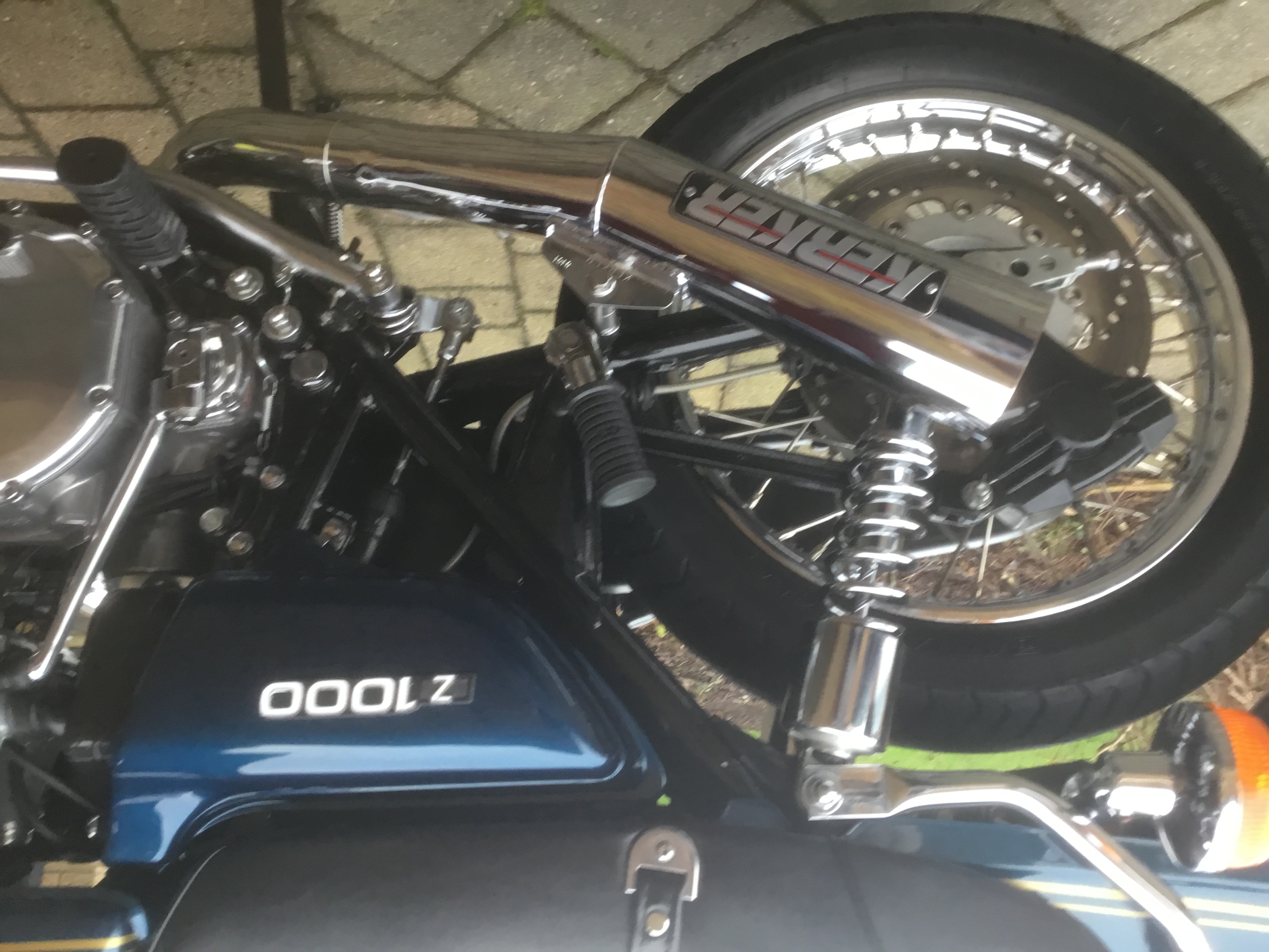

After the first ride this year I now realise my shocks are as much use as a bicycle to a fish! They are the standard rebuild one that RWHS use.
So whats recommended for a pleasant experience from UK suppliers (preferably not Hagon as I found them quite arrogant during a previous build).
Save my spine

Maxton do a range of twin shocks which would be suitable, T260 range.
Guessing they won't be the cheapest out there, but they would be custom built for your bike, they would look good & not out of place & more importantly, work & work well, https://www.maxtonsuspension.co.uk/files/t260-c.htm
All you would need to supply is some measurements such as length, mounting hole diameters, bike weight & rider weight, etc. The lower diameter of the shockers would have to be considered too so save having to cut out the chain guard for clearance.
Alot really depends upon how original looking you want to keep your bike.
