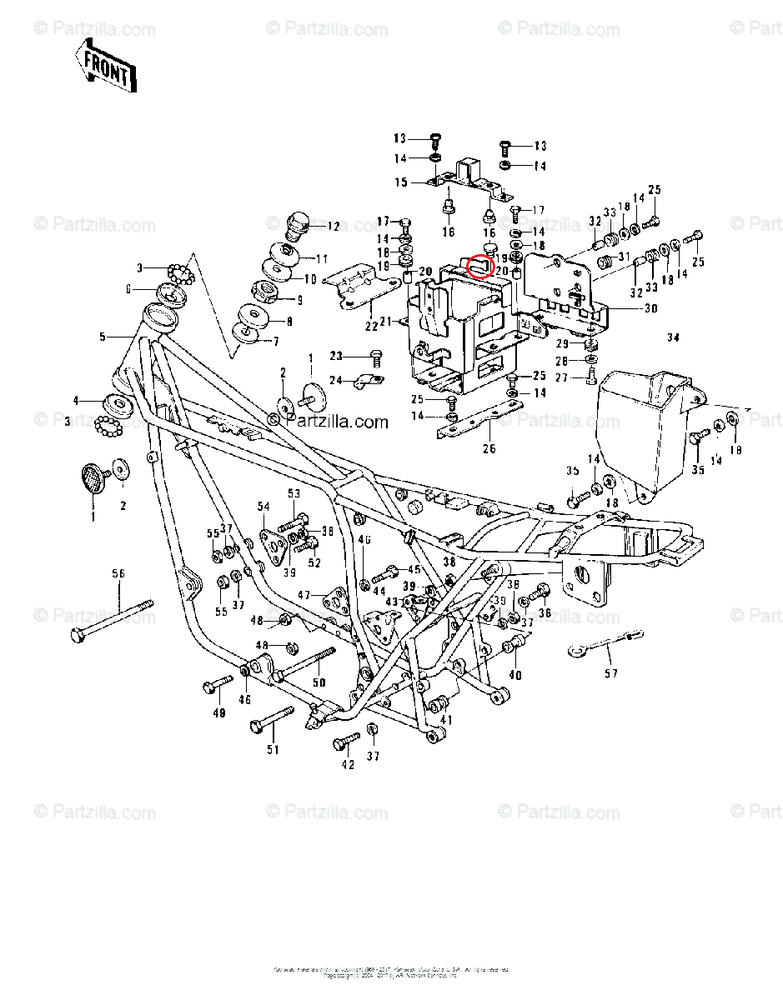

Hi there, I’m currently restoring my bike and don’t know whereabouts on the bike the indicator relay switch unit is situated as it didn’t have one when I got it.. any clues please?!

not sure about the LTD but the A4 had 2 relays - 1 either side.
1 for the indicators and one for the 4 way flashing
have a look on cmsnl.com for exploded diagrams.

I would say the round rubber support that holds the flasher relay fits over the end of this tang

Gus wrote:I would say the round rubber support that holds the flasher relay fits over the end of this tang
Gus
your bang on there gus
Re: Indicator relay switch - KZ900 A4 LTD 1976
#6 PostAuthor: Philippe » Thu Feb 03, 2022 5:11 pm
Hi guys
correct me if I'm wrong please but the KZ900Ltd didn't had the button to illuminate the four indicators at once.
The official name was KZ900B1 Ltd and not KZ900A4 Ltd. I know it's a detail but when searching for parts you need the correct name of the bike.
Gus has pointed out the correct place to mount the relay.

Hi there, thanks for all your help on this... I've got a firm answer now, I know where the point is on the frame. John

#8 PostAuthor: CAT3 » Sat Feb 05, 2022 12:59 pm
The '76 A4's had two "indicator" relays.
The picture with the circled item on is where the hazard indicator lives & the normal turn indicator relay lives behind the left-hand side panel, just near the seat lock barrel.
