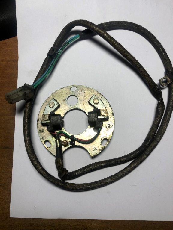

Hi Guys, just getting to the end of my Z750 engine build, and horror! I cannot find the ignition puck-ups or advancer / governor.
I did find my spare Z1000 MK2 set, a new ZX11 set and half a dozen IC Igniters, and a set that I cannot identify. They are not Kawasaki made, but fit the 750 cases. They are curiously only two wires? Any idea what make they are and whether I can rig them up to a Kawasaki igniter box?

they are Suzuki gs750 / 850

Thanks for that,
How odd.
I'm building the 750 motor from 5 engines that were put in store with another bike shop.
They were disassembled 35 years ago, by some helpful git and so I have crates full of parts all mixed up.
It appears that they robbed various bits and in some cases replaced with others.
The one bit I didn't check for before I started to build was the pick-ups!
Anybody got any pick-ups and advancer for a 750L3 / R1?
