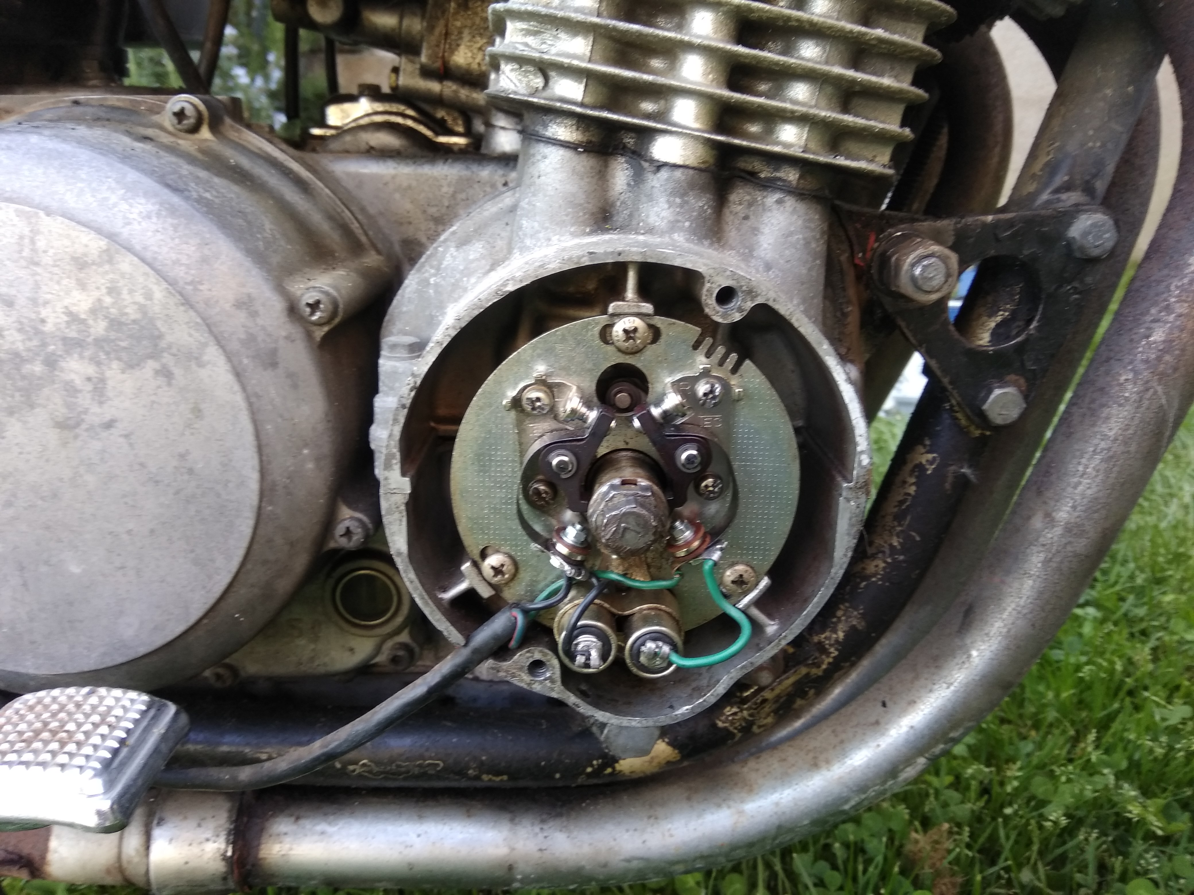

Now that the house is finished I thought I'd have a few hours on Batfink. After stripping more accessories off I thought I'd see if it wanted to start. Not a bloody hope in hell. Checked the yellow trace to the coils, 11.9v. Checked the green and the black to each coil with the points open, one shows 11.9 the other 10.2v. Checked the connector next to the coils on the green and the black, same result. Haven't checked the earthing on the coils. It wants to go but tries harder with no choke. The carbs need a good clean but I have fired it up before. I did hacksaw the carb to airbox rubbers and quickly looked at the float bowls and emulsion tubes, cleaned them quickly and tried again, same result. The fact that it tries with no choke would suggest to me it's flooding so the carbs will Ultra'd but the main question is the difference in the voltages? Duff coil? As said I haven't checked it's earth, will do tomorrow. It sparks, but seems weak.

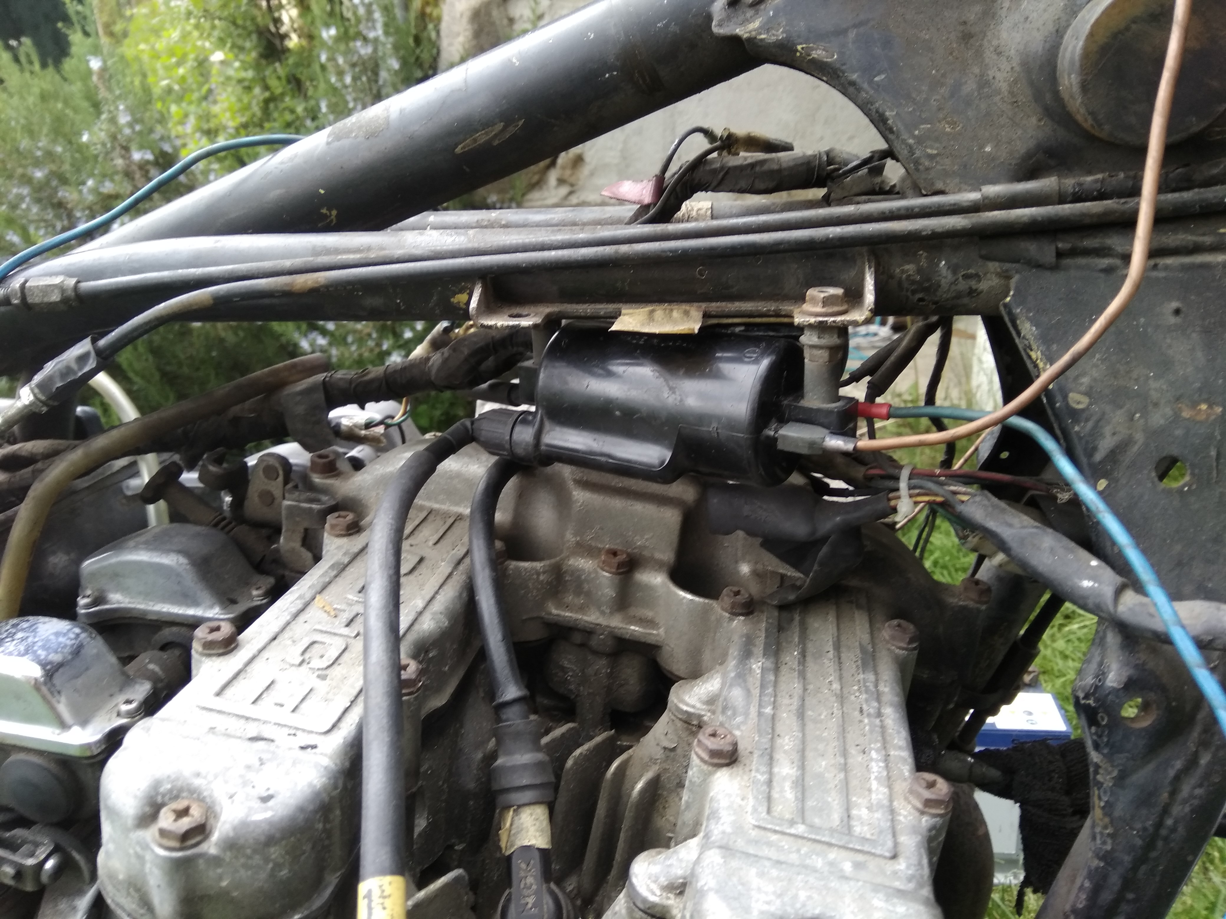

Thanks Keith, the battery is fine, it's a spare from a 2.0 HDI, 74AH 680A on jump leads. I can't use the kick because the splines on the kickstart (not the shaft) are buggered.
On the green coil wire for 2 and 3 I've got 10.6v and a LT resistance of 4.7 ohms, this is the one that sparks well.
The black coil wire gives 12v but has a LT resistance of 5.8 ohms.
I've only got a Haynes BOL's for this but that suggests it should be around 4 ohms.
The voltages are the same whether measured at the coil wire or the points.
Then I re-read the previous post 'Batfink hasn't got a spark' and followed the advice you posted then.
Opened the points up and bridged then with a screwdriver watching for a spark. The green coil sparked, the black for 1 and 4 didn't but I heard it click, decided to really test it because I was in quite bright sunlight and grabbed the plug, got a very very faint shock, just to be a muppet and compare the two I did the same with the good one.....got a smack, that works fine.
I then swapped the green and black wires to see if the issue stayed with the condenser or coil. It stayed with coil. Cleaned all the earth mountings up on the coil and checked continuity, fine, still the same.
So unless I'm missing something, and that is very feasible, the spark test along with the 5.8 ohm LT reading would suggest a knackered coil?
Just to confirm this absolutely, can I borrow a coil off the ST, are they compatible?
Is there something I should be looking into that can cause a coil to die or do they just die. The coils have been changed for gen Kwak ones in the past because I've got the empty boxes with part number in a box of bits the chap gave me.
Thanks for all the help so far

Re: Batfink needs an electrician
Just a thought, the ST is electronic vs 650 points, does it make a difference, and another thought was instead of nicking the coil off the ST, I have the GPZ11 already in bits, would that work?
sounds like a coil . if you've got a another coil on the bench try it, I guess it wouldn't make much difference if it was off a points or electronic bike, for a 5 minute attempt to clarify the problem. Then at least you'd know. If it runs great then you can invest in the "right " one if you want.
gray
Stuck the GPZ11 coil on.....in a fashion
Dropped the tank on, started on the button, no throttle cables connected but ticked over sweetly at 1500rpm.
Off to source a coil, well pleased.
