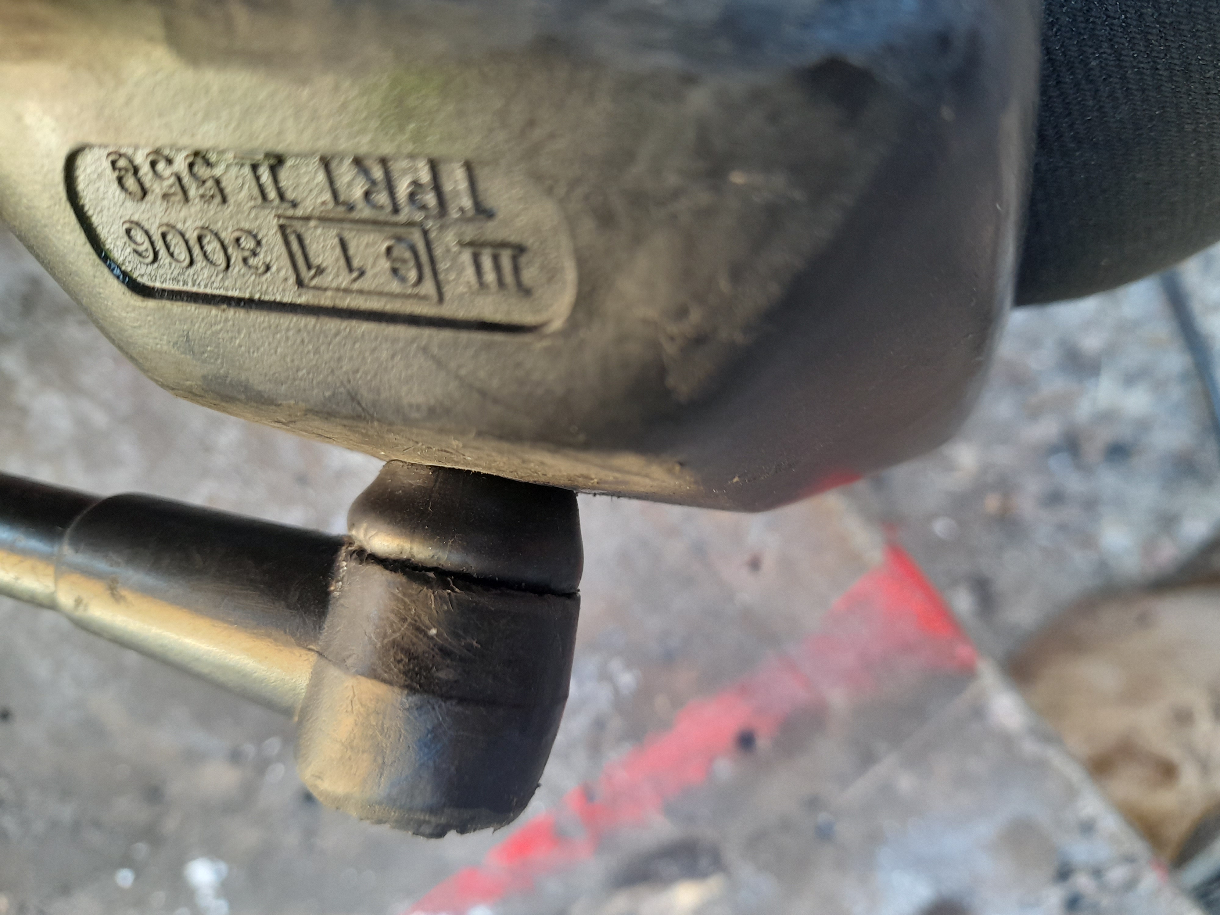

Is it possible to tighten the ball joint on original khi mirrors? They are the rectangular Z1000j style with the black plastic moulded mirror housing and non removable glass so can't get to the innards.

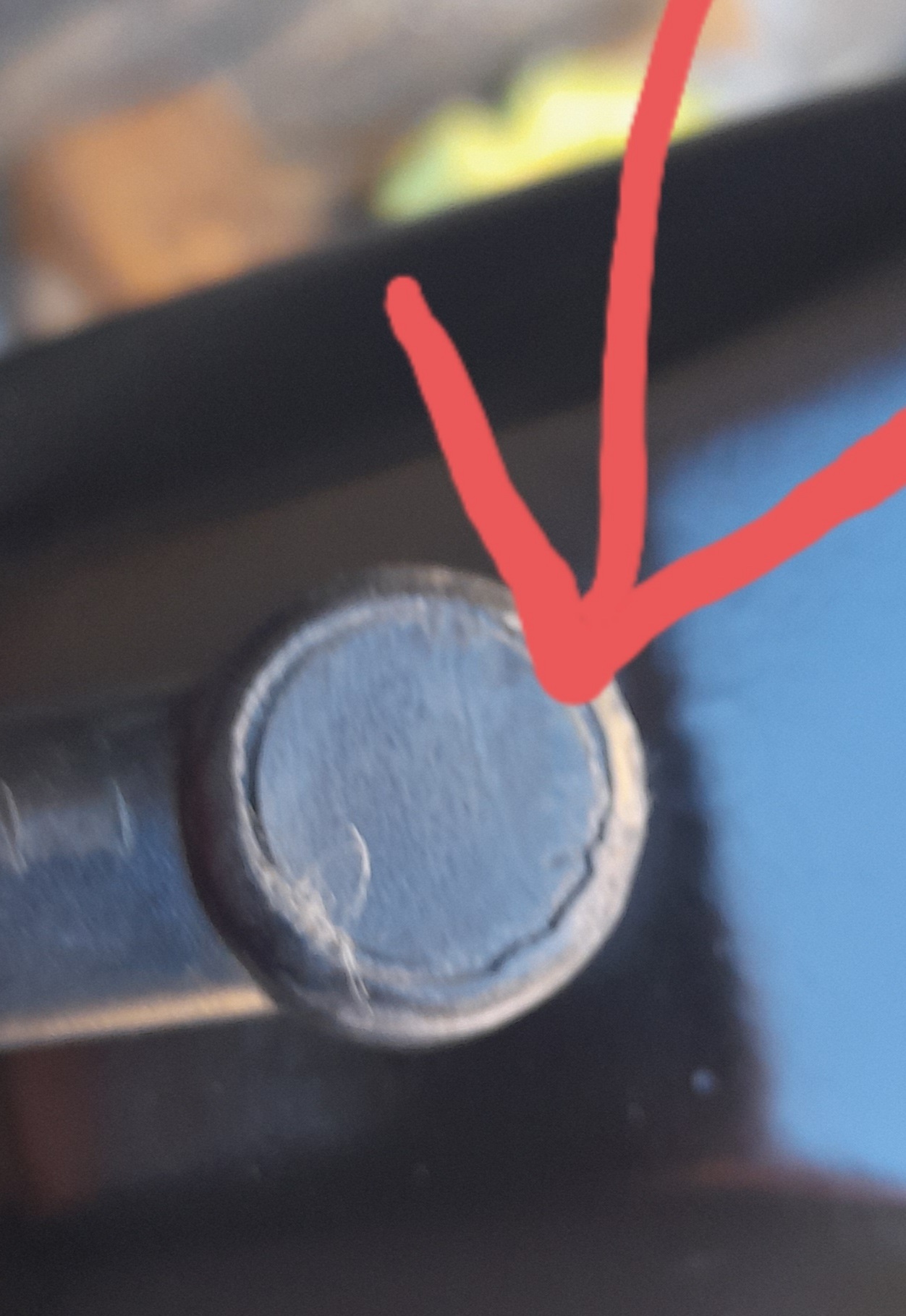

So thinking the right angle joint between the arm and the ball shaft is no likely to be one piece I decided to try getting access to it by cutting out the plastic cap by slitting down the circular recess.

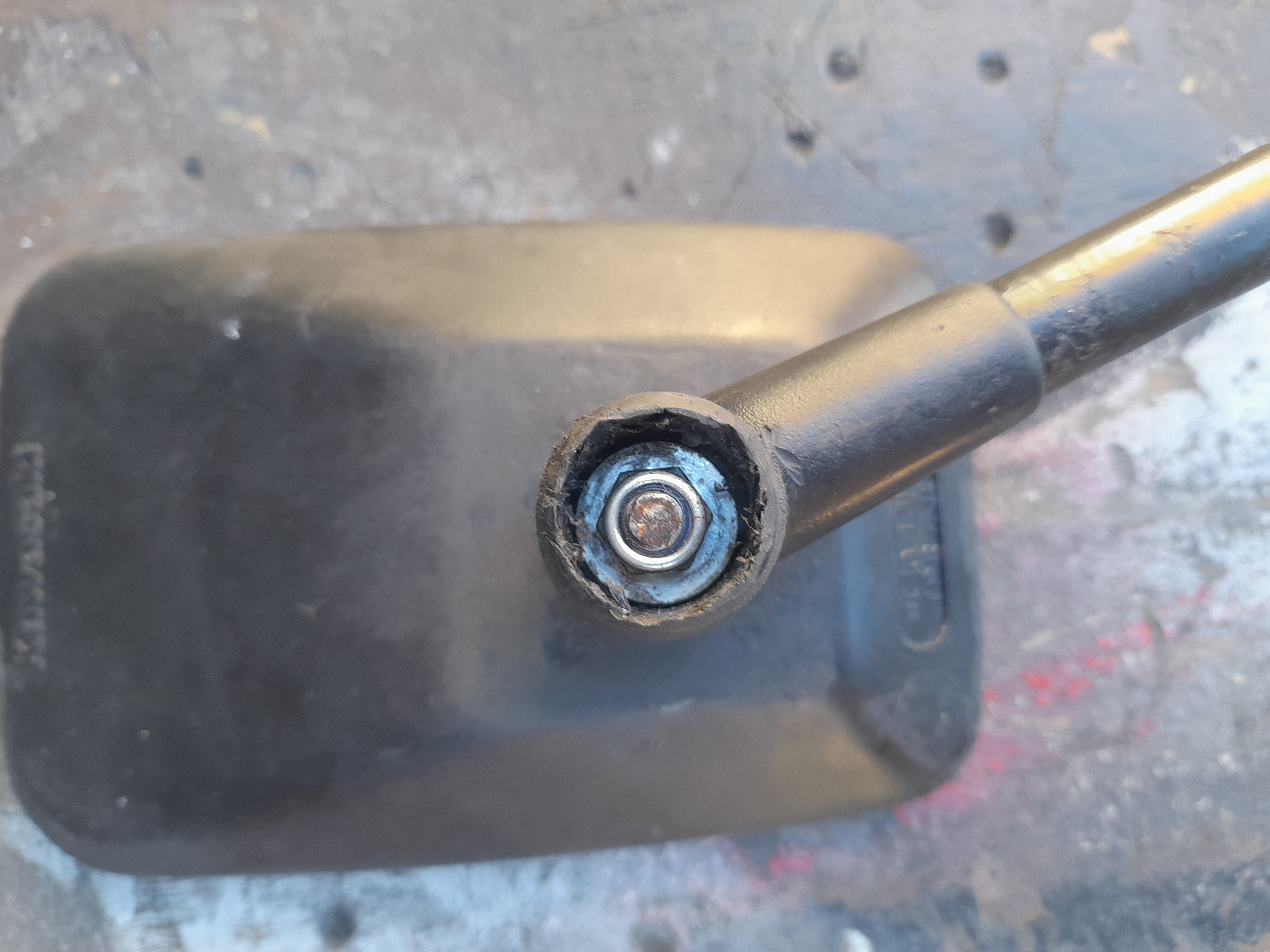

Once that was out the way it was obvious that the arm and ball shaft were held together by a 10mm nyloc.
So by sliding some tubing on the ball shaft I created some tension between the mirror head and the arm which had the effect of increasing some additional tension and friction in the ball and socket.
