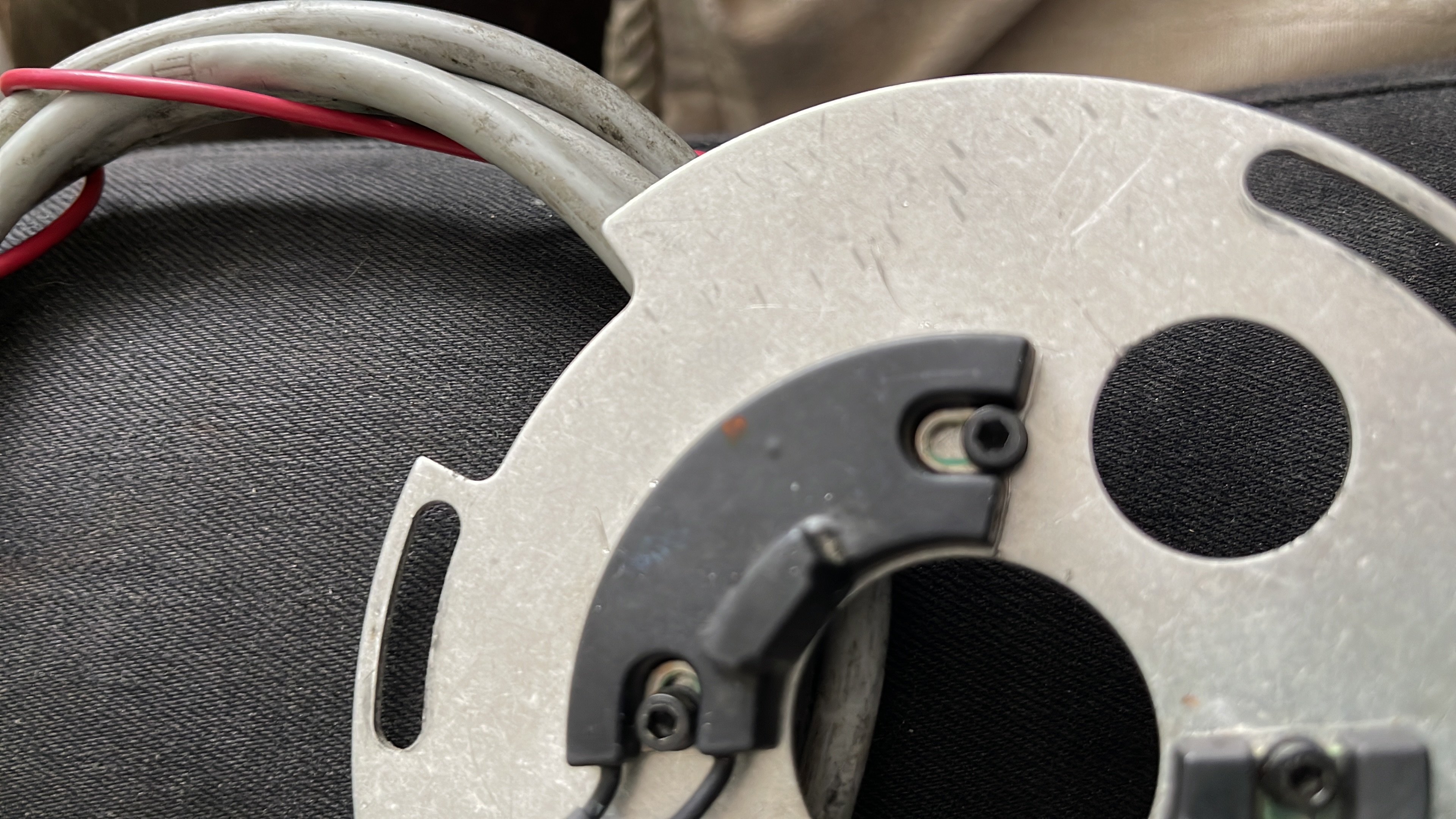

#11 PostAuthor: Z1st » Sat Apr 29, 2023 3:31 am
Hi long time since update on this turns out that the 1 and 4 pick up was goosed and if I looked at it close enough I could just see a small bubble in the black casing

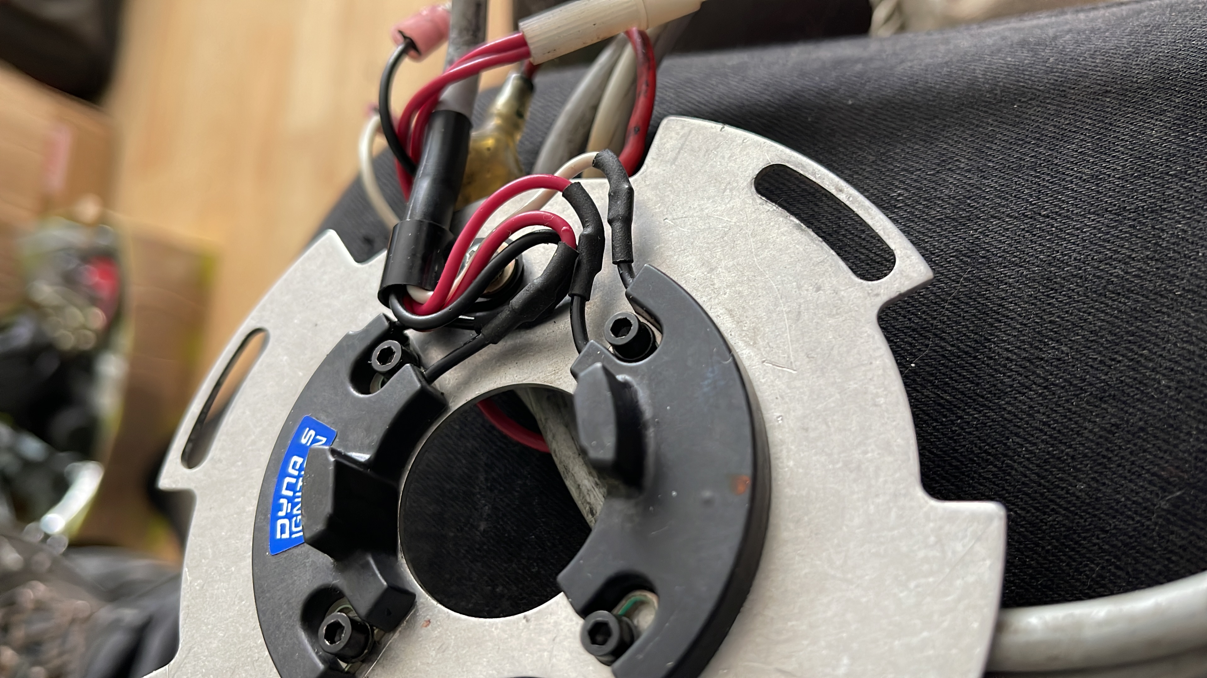

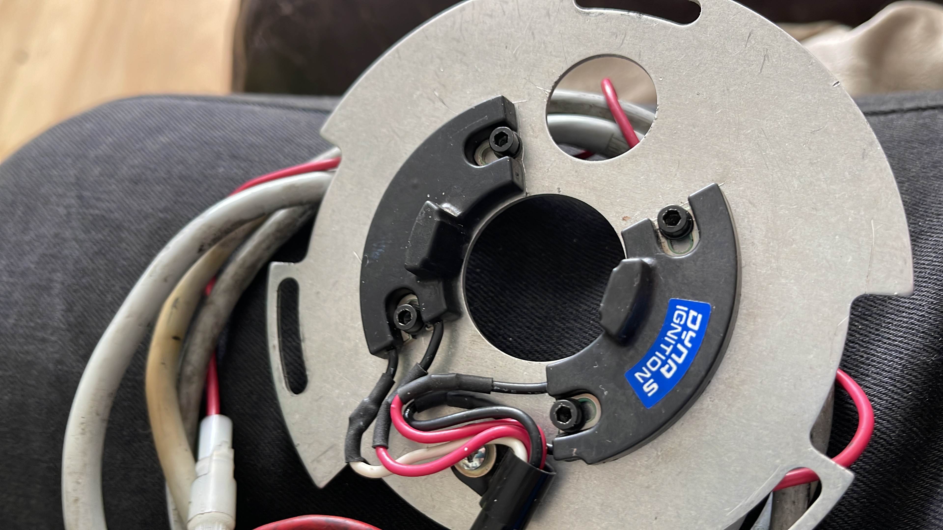

#12 PostAuthor: Z1st » Sat Apr 29, 2023 3:32 am
Hope you can just make it out I’ve marked the area
