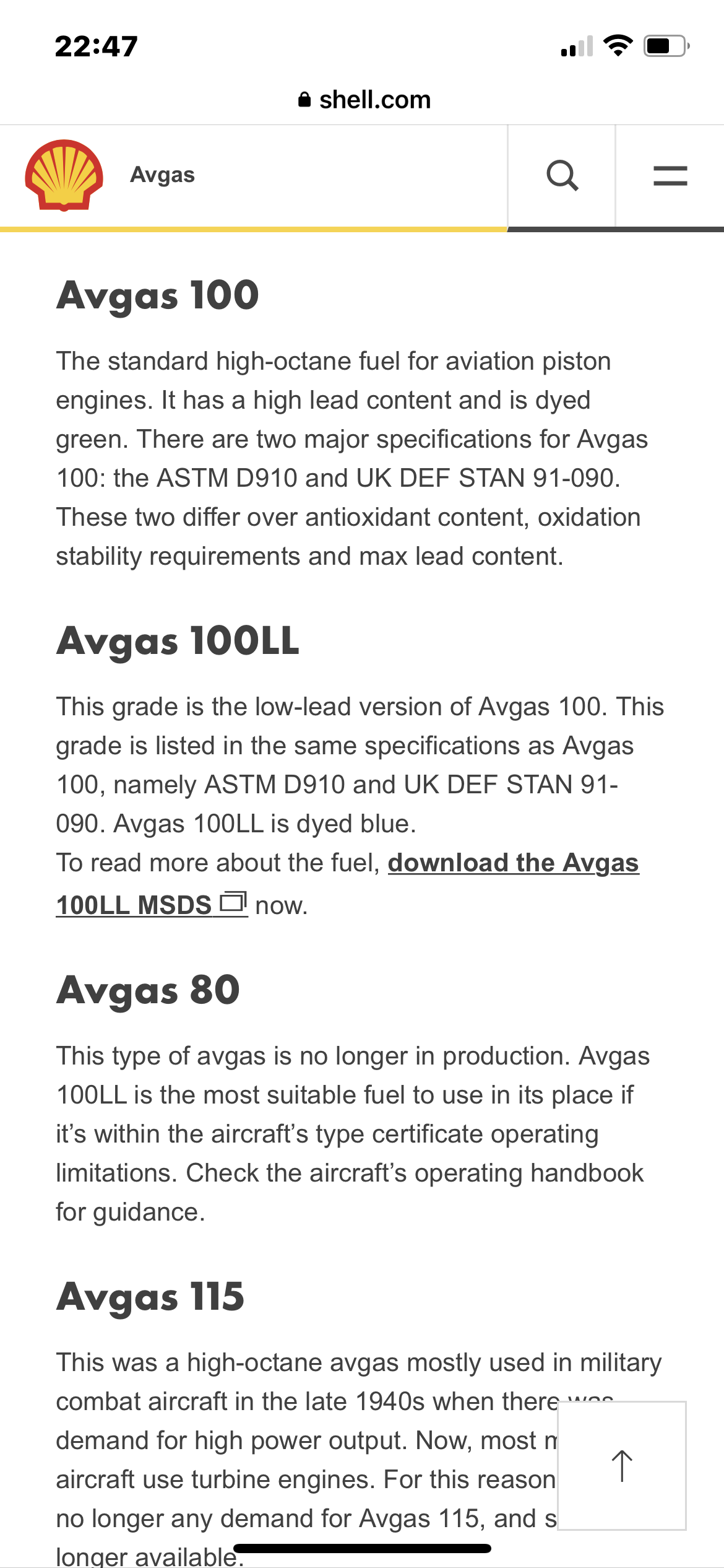

moizeau wrote:I ran my LC on Avgas, not sure on the specs today but back in the early 90's it was high lead content 100 octane petrol, The LC loved it.
Still the same high lead :biggrin put lead in ya pencil
Or 100 LL low lead :sad
My mate runs it in his RC30 race bike and he has a light aircraft too and I’m only 3 miles from breighton air field a
Non of this filling station Shite E10

It was the 100ll I used, apparently still far more lead content than the old 4 star.

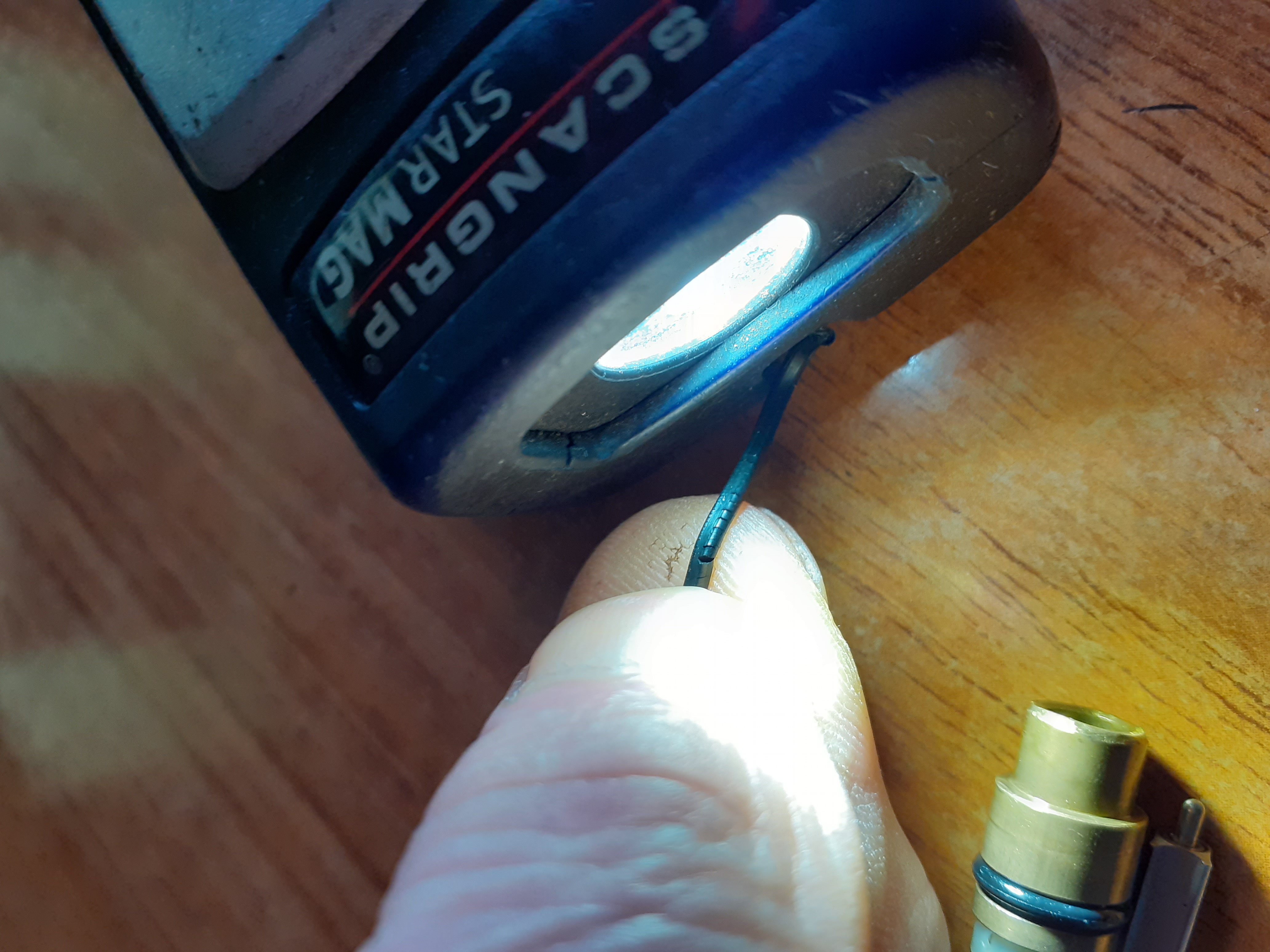

With the carbs all in bits i ordered 4 new 'O' rings to seal the float needle valves. Genuine Mikuni parts from Motocarb for a little over £11 delivered. http://www.motocarb.com/ There has been some intermittent dribbling (bike not me) and difficulty setting the fuel heights correctly for some time and two of the four float needle valves just fell out when the holding screws were removed so the 'O' ring seals wernt doing their job any longer.
All four came off the needle seats like 100 year old wood. Three are about ten years old and one was replaced two years ago with a complete new valve because the spring plunger had broken.
The three older ones were very perished and showing signs of fatigue.
