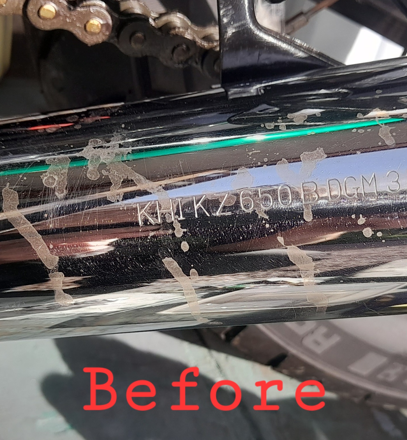

Ok what do you use to polish up dodgy chrome?

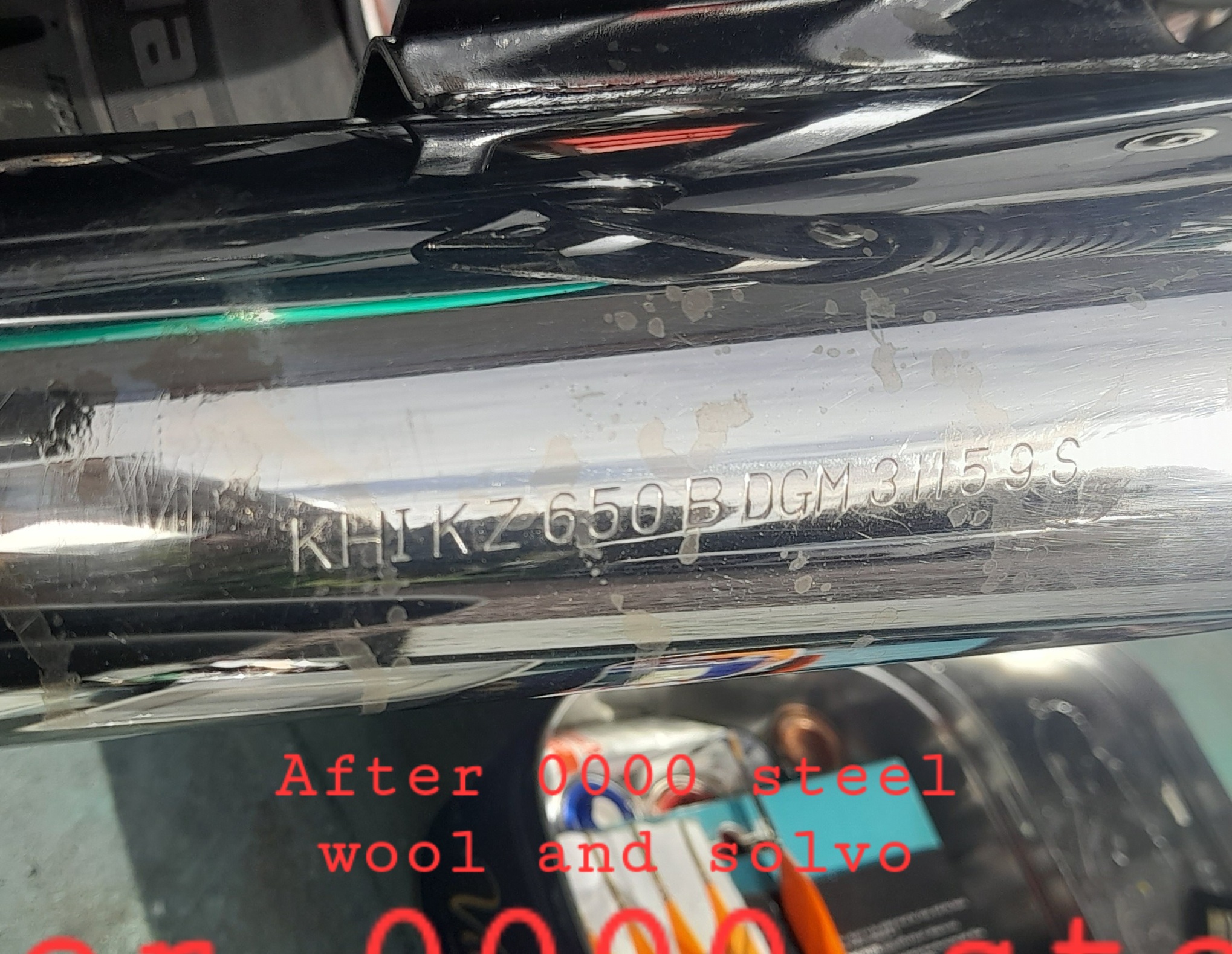

Solvo and 0000 grade steel wool then quick glo after to final polish and seal. Battery acid marks. Only did the bit through the khi embossing to start with in the pics.
