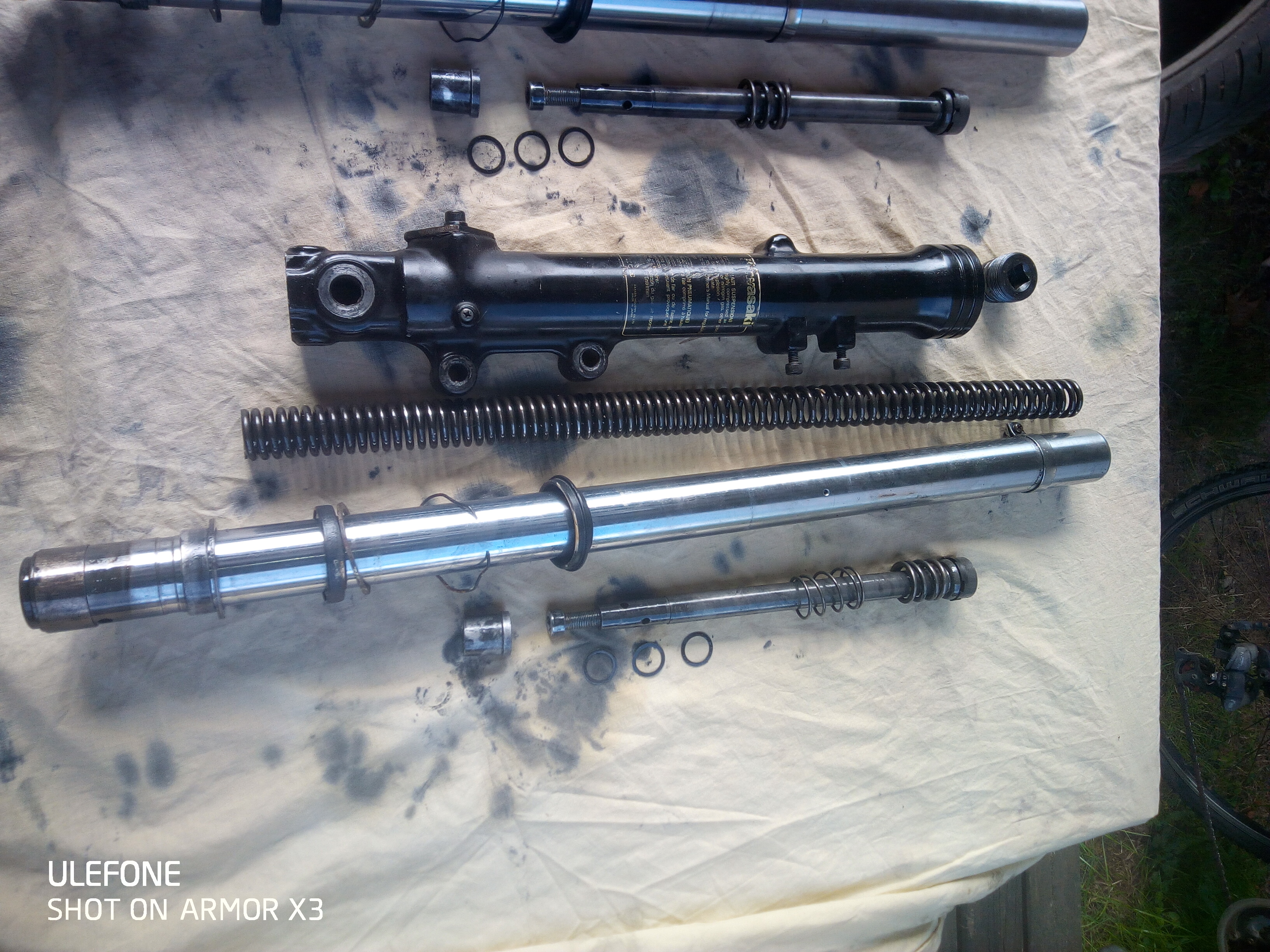

Just done this on mine. Having had it stripped and seen the bits I think you could. The way I would think it's possible would be to remove the dust seal, then the clip, washer, then use 2 or 3 drywall screws in the fork seal at equal distance. They would cut through the seal then when they hit the washer underneath would lift it off.
Having said that, it is just as easy to pull the forks apart. Just be aware of the placement of washers/springs especially 3 little ones that look the same at the bottom. They're not, 2 are flat and sandwich a deformed 'spring' washer.
