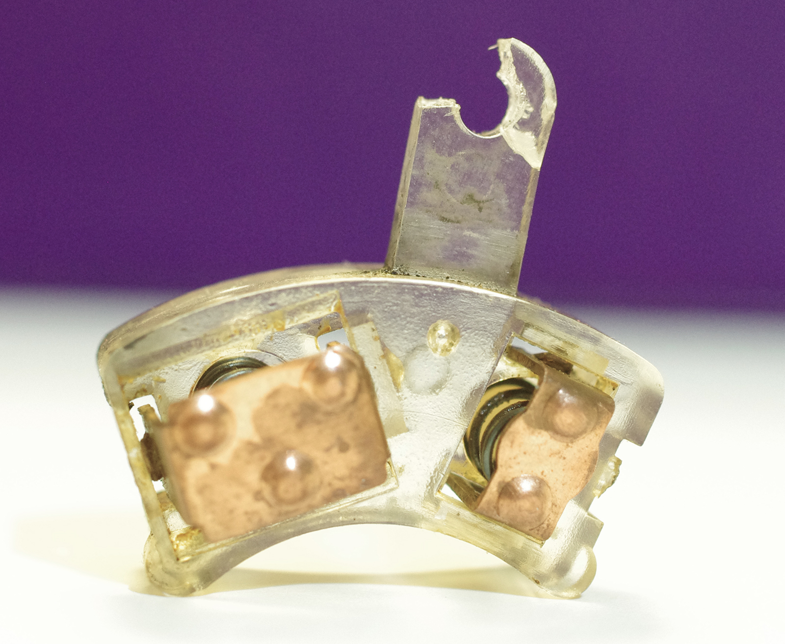

I'm refurbishing my switchgear (Z1000-A1) and the plastic bit where the dipswitch attaches is broken. See photo...
I might be able to fix it but it's very small, so...
Anyway, I figured these were the same on most seventies Kwacks, but an eBay search has been fruitless. Anybody out there got a spare one?

Dab of superglue and fit the black bit and screw while wet.
Don't know of any available repop so a (possibly) knackered secondhand one is the the alternative.

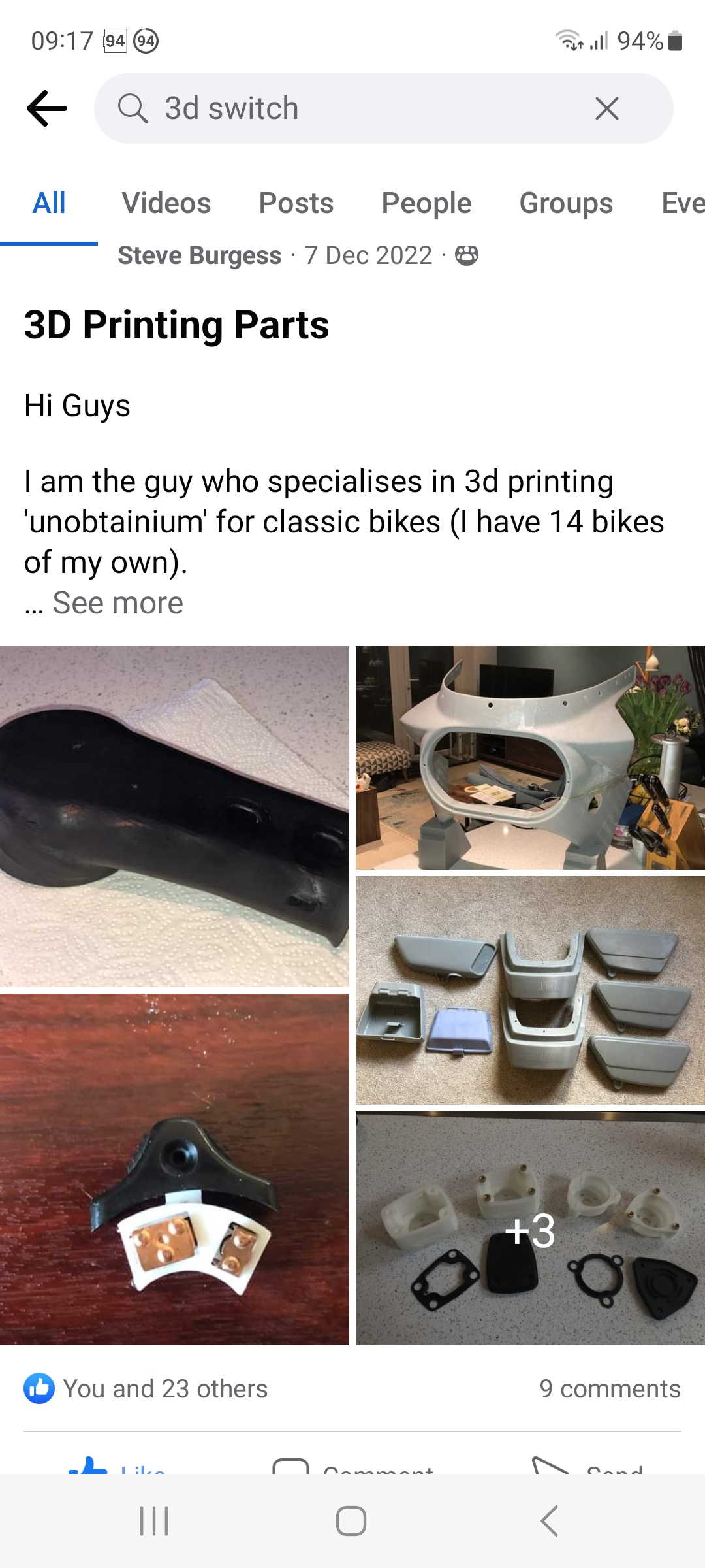

Steve Burgess on Facebook 3D prints the switch part

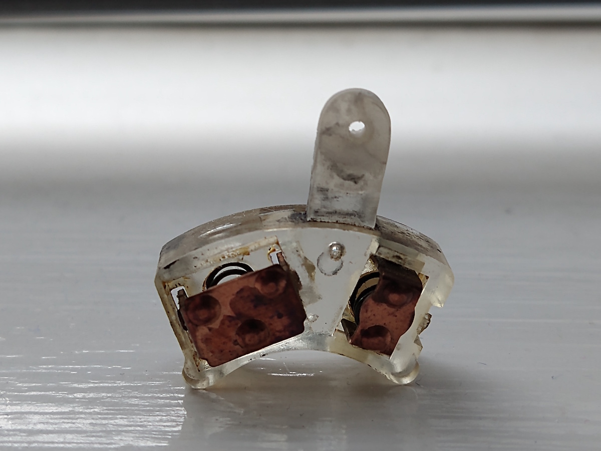

#7 PostAuthor: TiBolts » Mon Jan 30, 2023 3:36 pm
Thanks for all the info guys. I had a go at it with Plastex and it worked ok (well I've reassembled it and it hasn't fallen apart yet).
