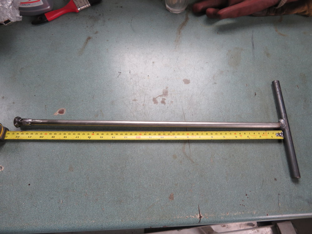

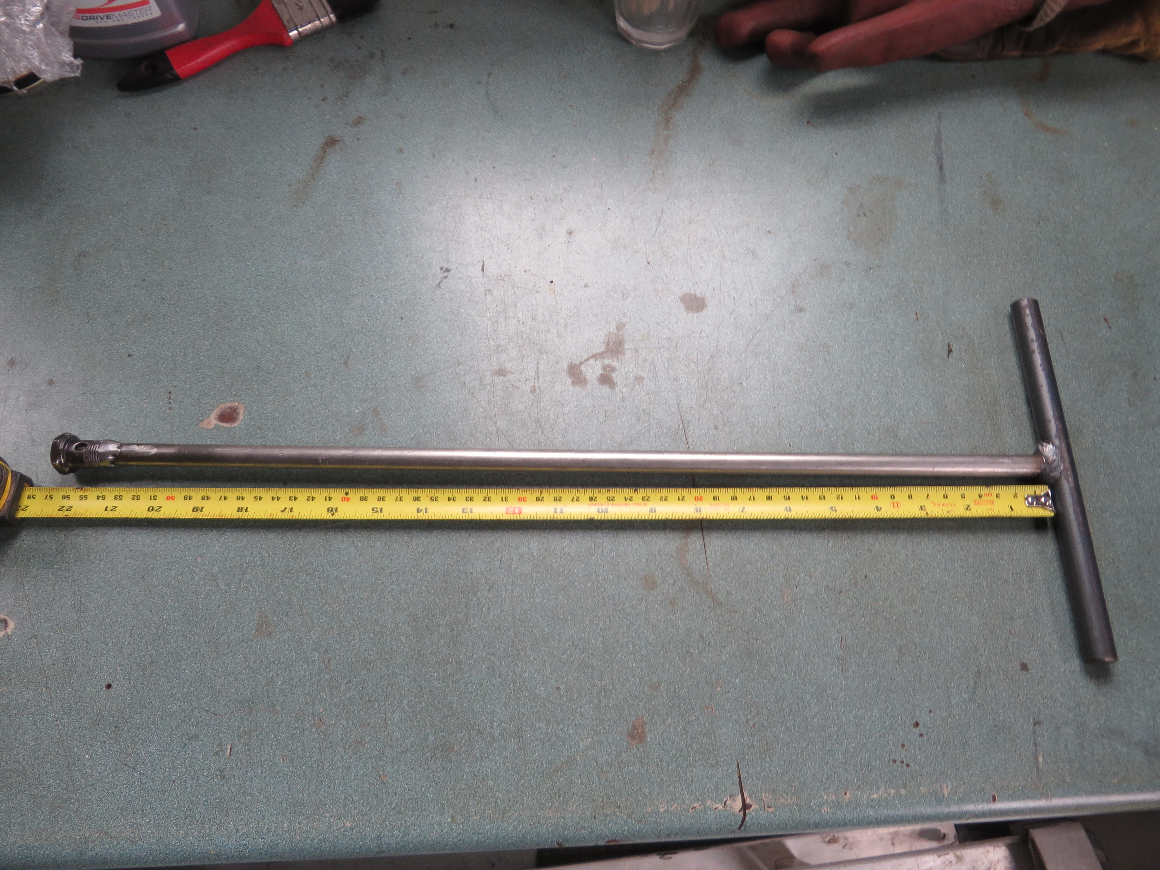

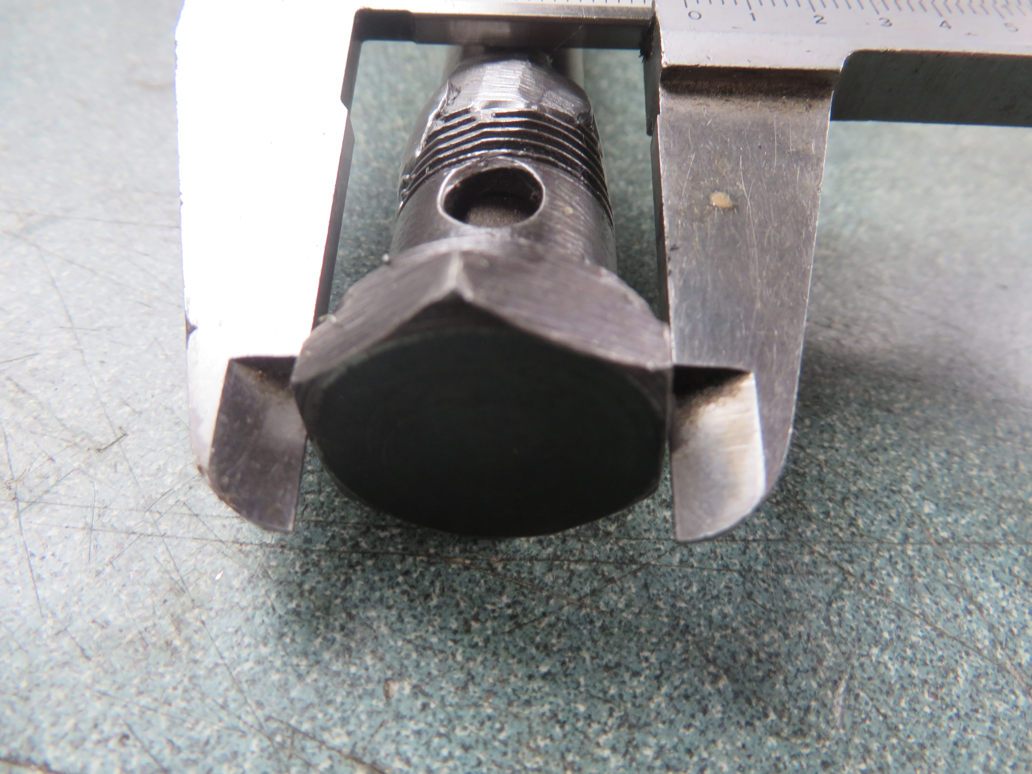

#3 PostAuthor: Al » Sun Feb 12, 2023 11:47 am
22 and a bit inches in length.
21 and a bit mm across flats.
If you have NOS but older seals you might do well to replace with the more recent version since the originals were superseeded and i believe better designed subsequently!!
