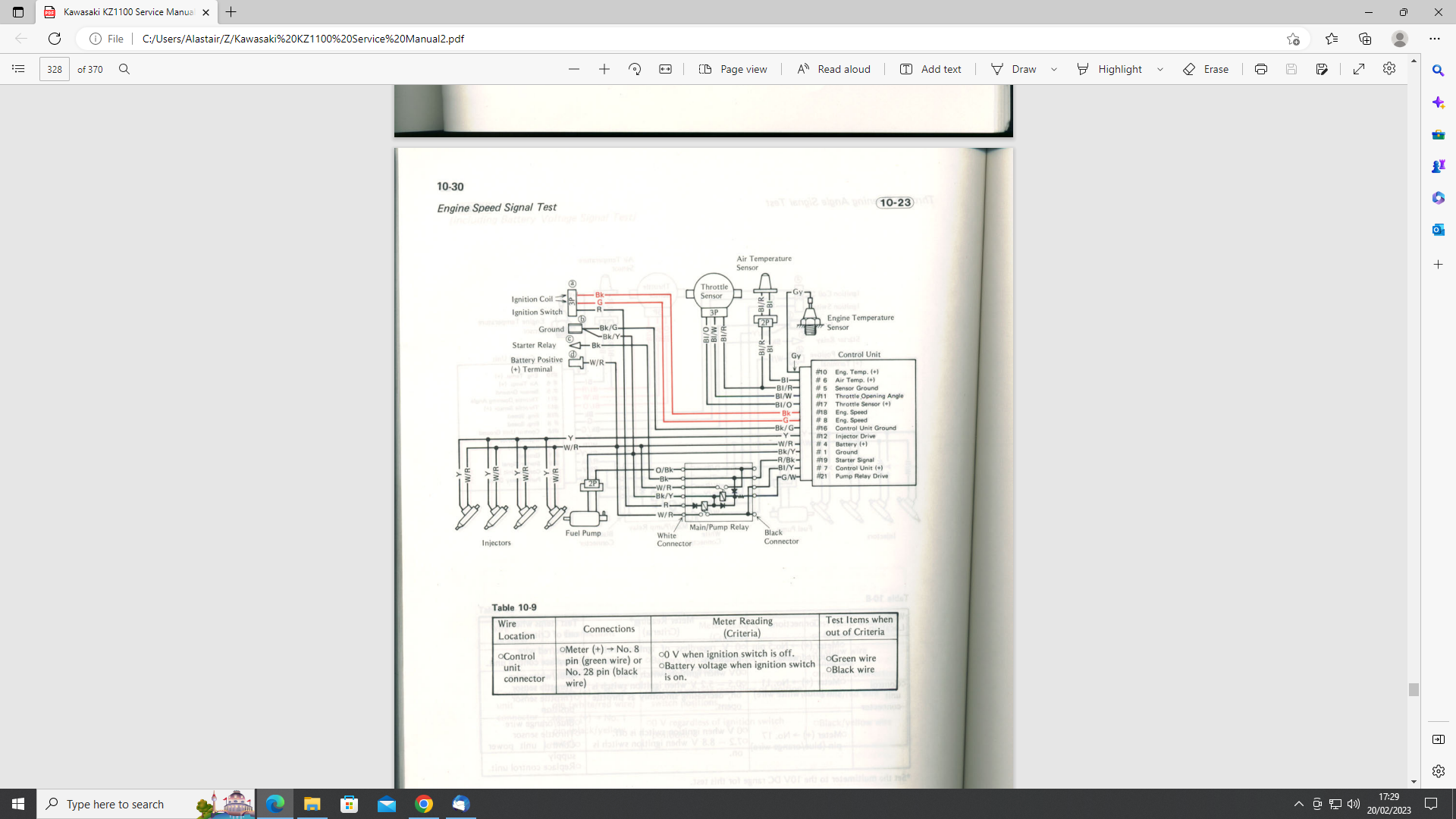

Having issue with my 1100a1 not turning over getting a 2 long 3 short pulse from the DFI unit as the engine is not even spinning the criteria of 'no ignition pulses are transmitted to control unit' is not really of much help the action point (i have the supplement manual) is to refer to the main manual 10-30
Does any one have the main manual and could sand me a picture of that page, i have bneen trying to get one fro over a year now but they never appear to come up for sale

I've got the KZ1000 and KZ1100 as a PDF, also the supplement. PM me your email and I'll send them you.

Sorry Derek, the file is too big. Is it page 10-30 you're after?
I've just checked the source that I downloaded it from and it no longer exists.
Sorry mate. I can stick it on a USB key and post it you if you wish?

This is page 10-30 of the base manual. There is also a picture; 10-30, which shows the throttle position sensor and not much else.
You may be able to click the picture to zoom it!
