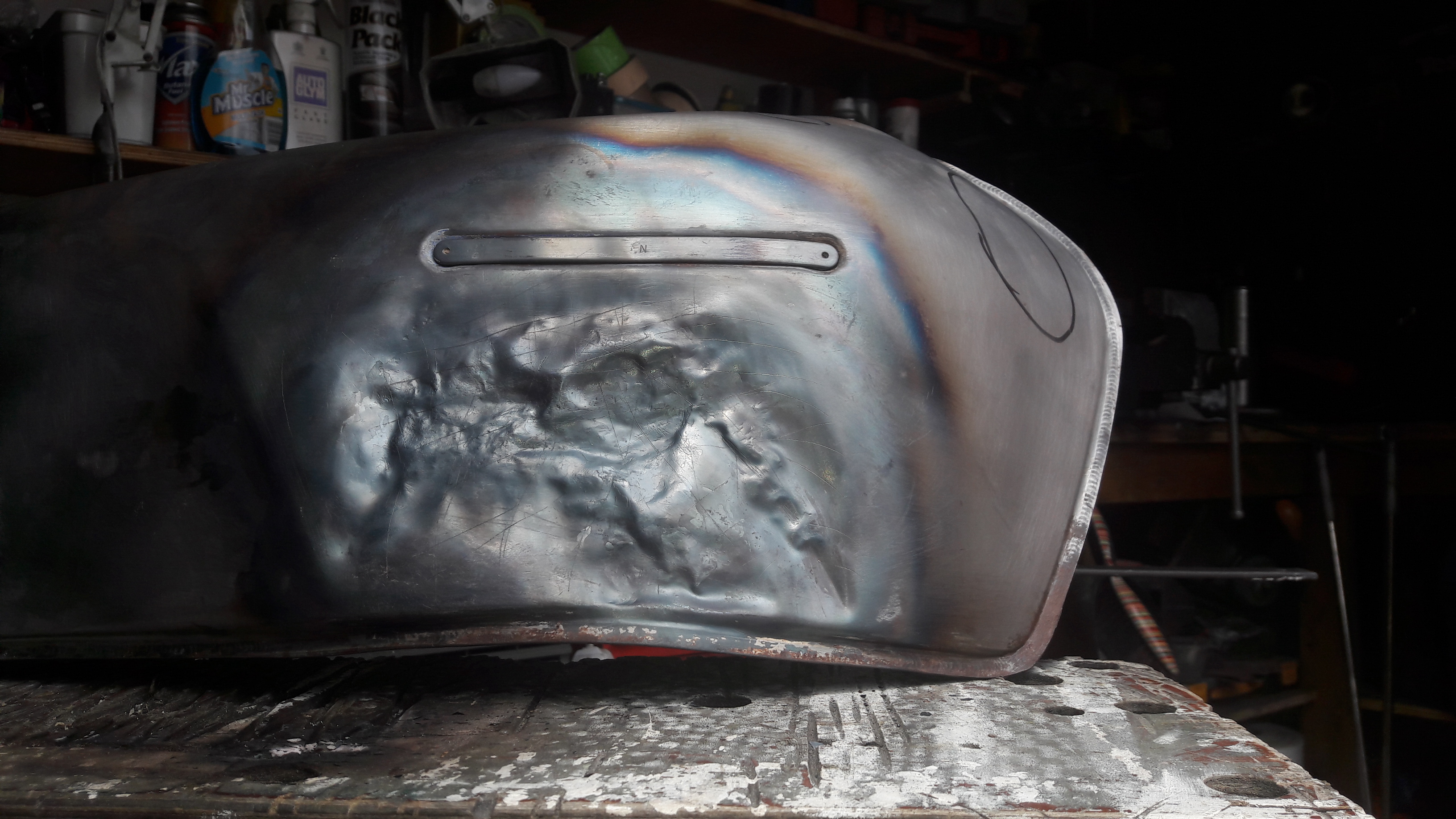

#18 PostAuthor: warren3200gt » Wed Mar 01, 2023 10:42 am
Everything can be fixed.
This tank looked fine on a project I bought. Getting another J tank is next to impossible so no option but fix it.
Before
Just depends on how motivated you are.
After
