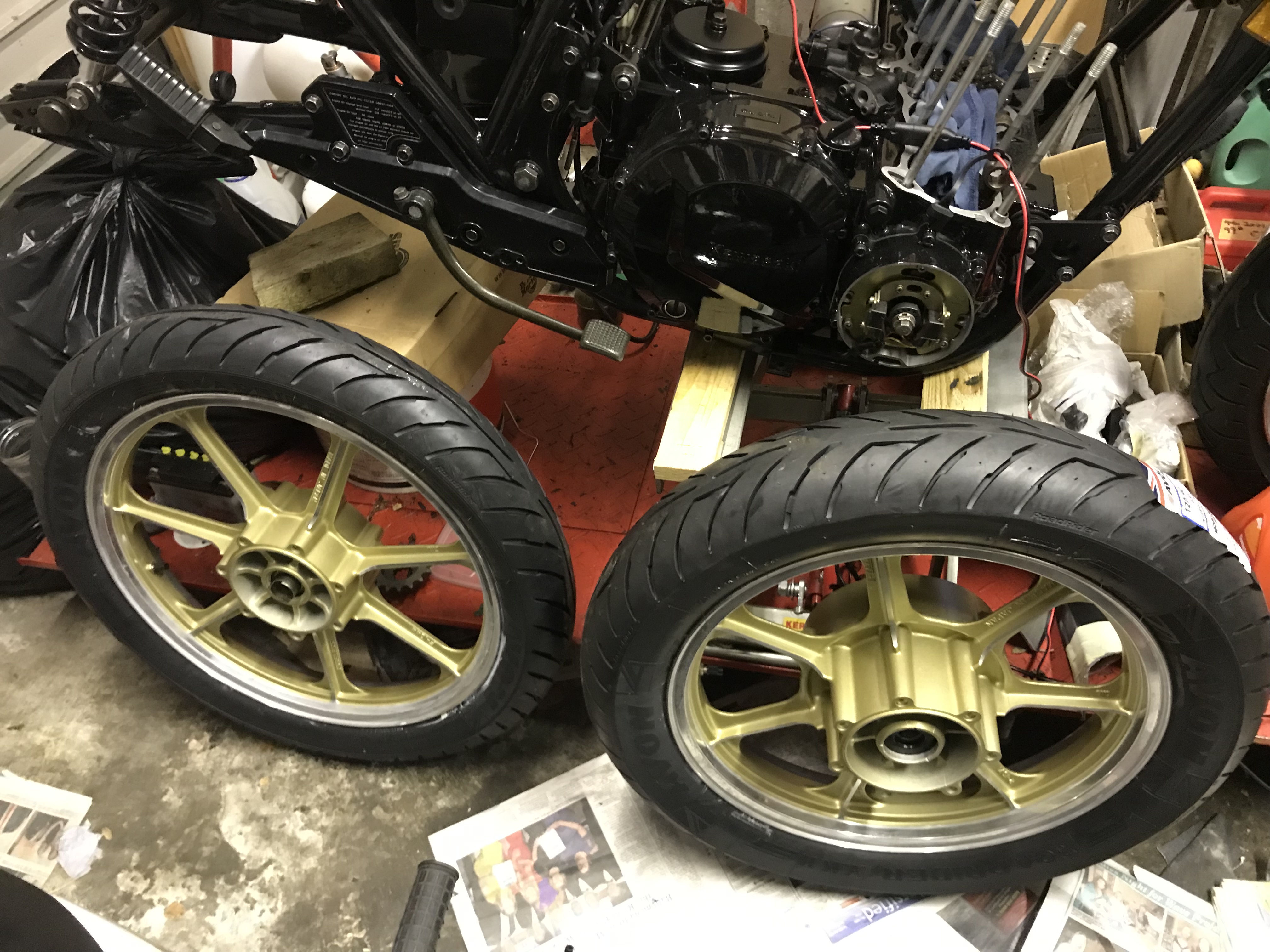

#5 PostAuthor: chrisu » Tue Mar 07, 2023 5:38 pm
i still fit tubes in my 1980 cast wheels even if the tyres are tubeless. Never had a problem.

#6 PostAuthor: chrisNI » Tue Mar 07, 2023 6:34 pm
warren3200gt wrote:Mags were tubeless from the late 70's. If they are kawasaki mags they were designed for tubeless tyres.
They’re an odd valve size though it’s probably simpler to just go with tubes :shock:

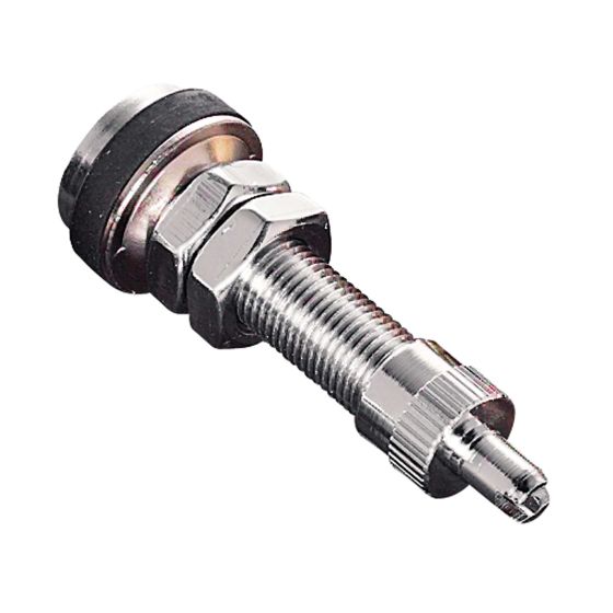

#7 PostAuthor: warren3200gt » Tue Mar 07, 2023 7:12 pm
They are specific to bikes. Car valves won't fit. They are available in different sizes, this is on Ralph's bikers toolbox.

#8 PostAuthor: chrisNI » Wed Mar 08, 2023 12:26 am
warren3200gt wrote:They are specific to bikes. Car valves won't fit. They are available in different sizes, this is on Ralph's bikers toolbox.
No doubt. My local bike shop didn’t have the right size in stock so I just went for tubes on a set I got done last week.
