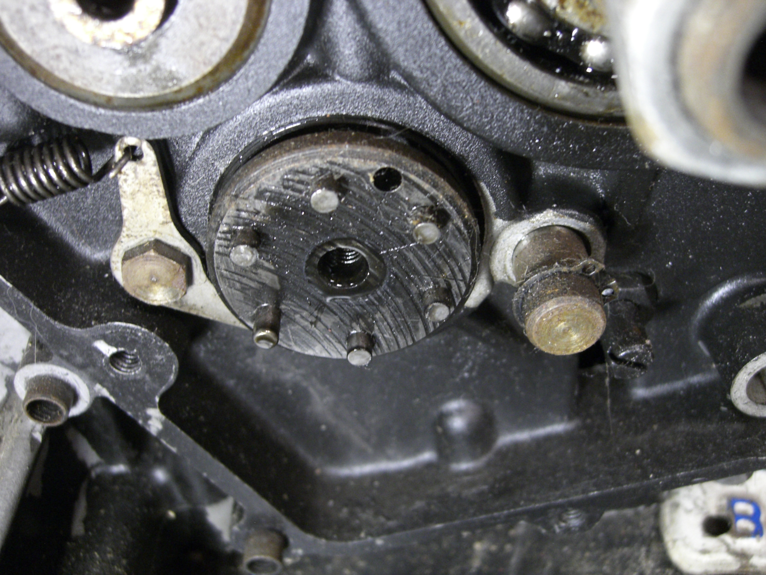

Thanks for photo, that helps, stripped case off etc to get to selector mechanism, i found my dimple plate was 180 deg out cimpared to yours, renoved it thinking it just needed turning around but found longer pin 180 deg out seee my photo.
Can i just pull the long pin and swop it over with the one 180 deg away so it then matches yours in Neutral?

I also notice on your photo its black yet an A4 case is usually silver has it been coated at some time?
Update pulled pin and swopped it over, then re fitted dimple plate, however mine isnt now in same position as yours is.
If i select 1st gear it looks in similar position, but in Neutral dimples higher up, may temp fit side case and check if i can see dimple through switch hole. However it now all works.

Have taken cover off so you can see photo and looks similar, mine may be out a little for being moved a bit.

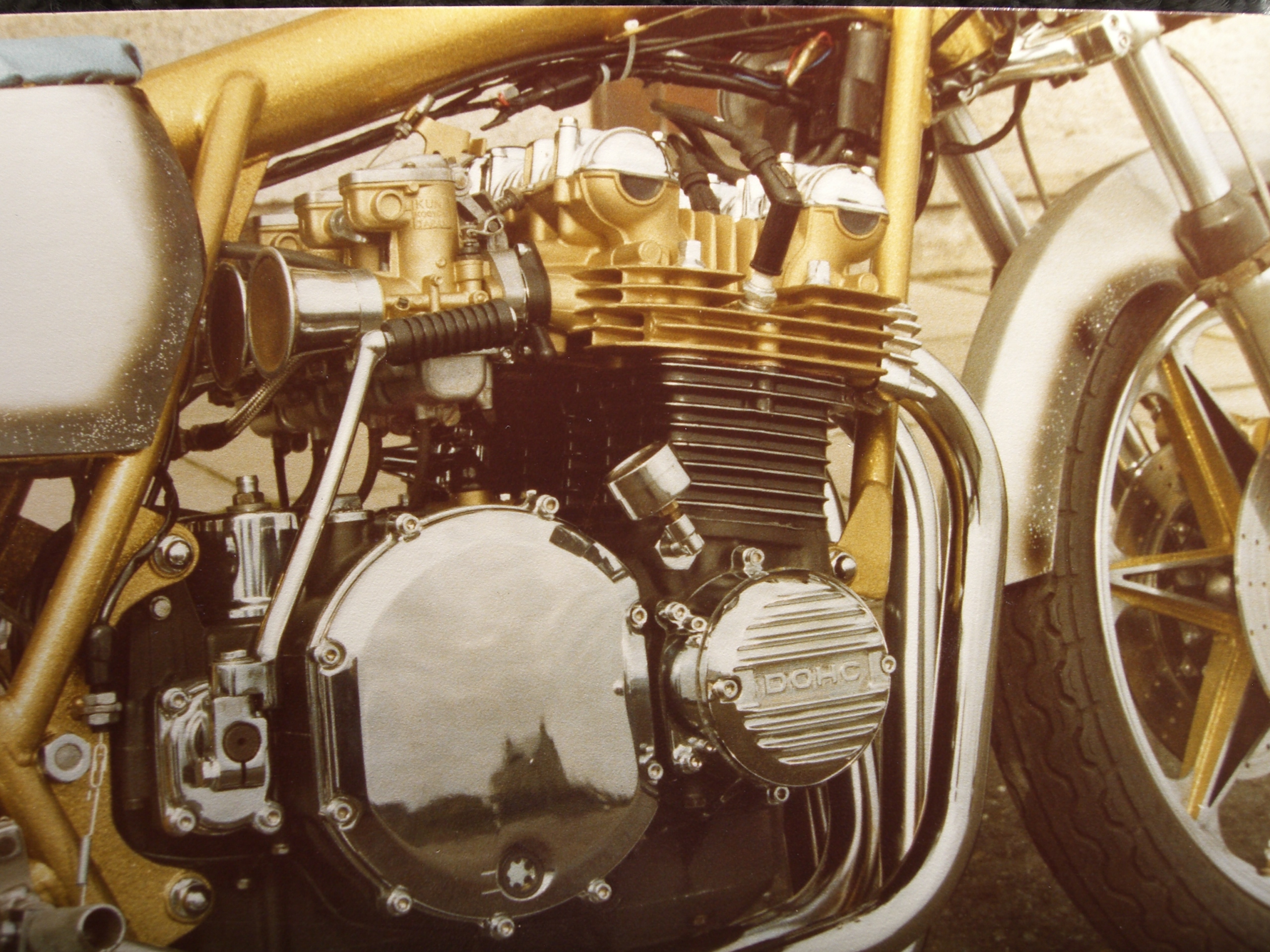

Engine cases are black as i sparayed them and baked in oven when i had top casing enlarged for bigger liners for 1170 pistons plus lots of head worrk.

It could be that the long pin needs moving one hole anti clockwise.

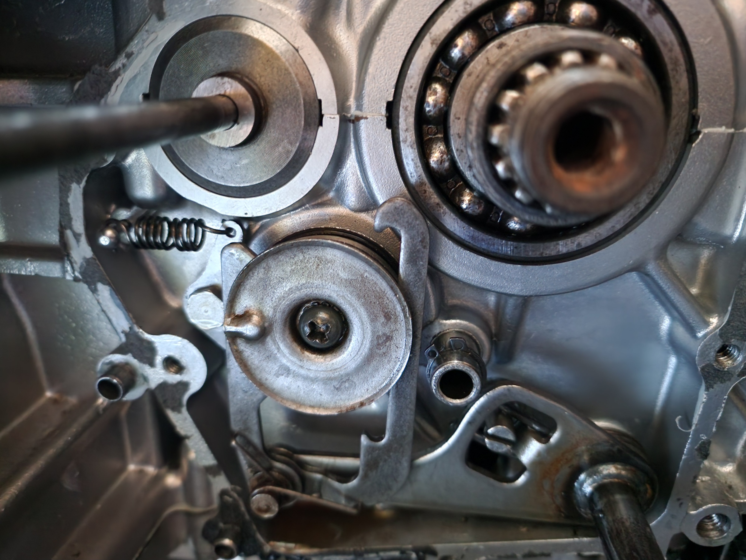

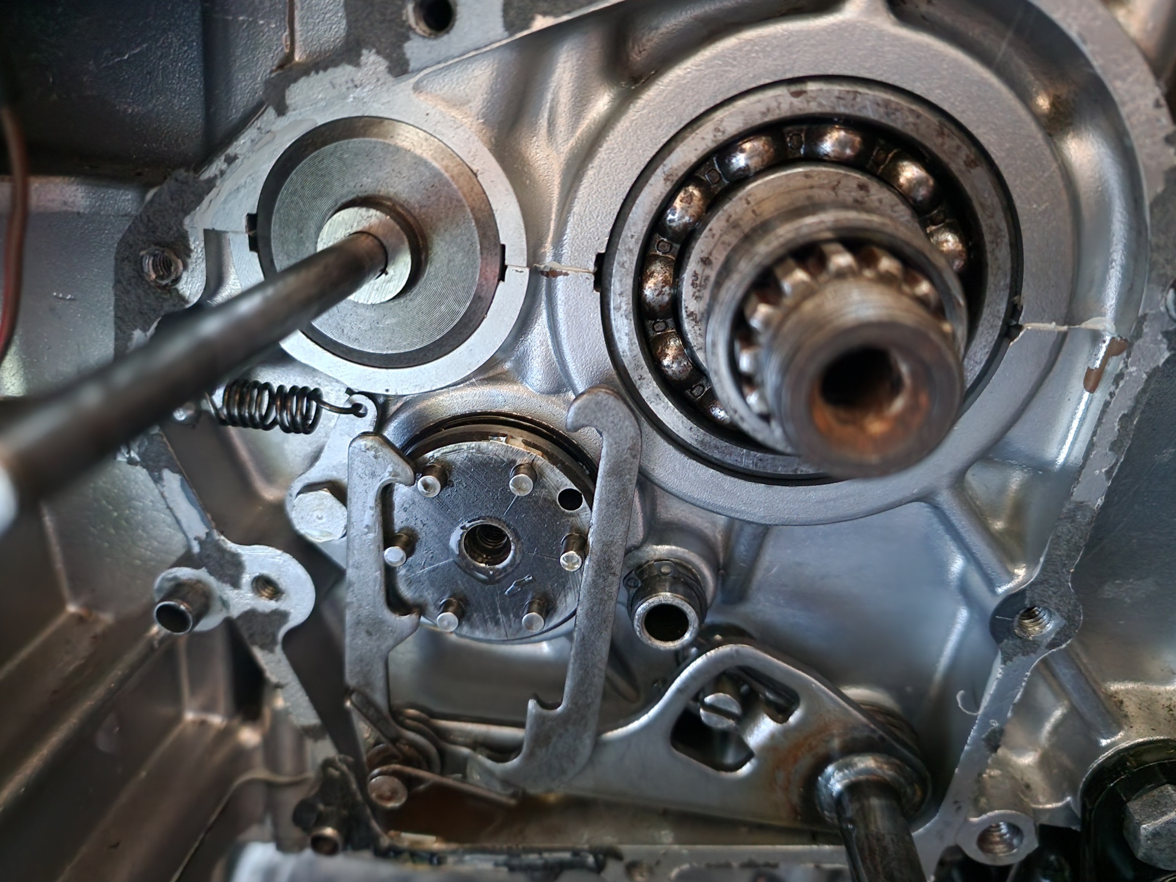

R3sc : hard to show in photos but once i removed the inner case i could tell the dimpled cover was 180 deg out ie dimple facing rear wheel, when it should have been facing front wheel as in Zed9 photo.
I therefore removed the dimpled shield and found the long pin was to the right (1st photo), when should have been to the left, solution swop them around, replace dimpled shield now in correct orientation (2nd 3rd photos) temp refit case and Neutral switch, check operation then remove, replace gasket and refit all.

Sorry, I should have said that the longer pin needed to be moved one more space anti clockwise to achieve the same dimple position as the one shown in the photo of the black engine!
