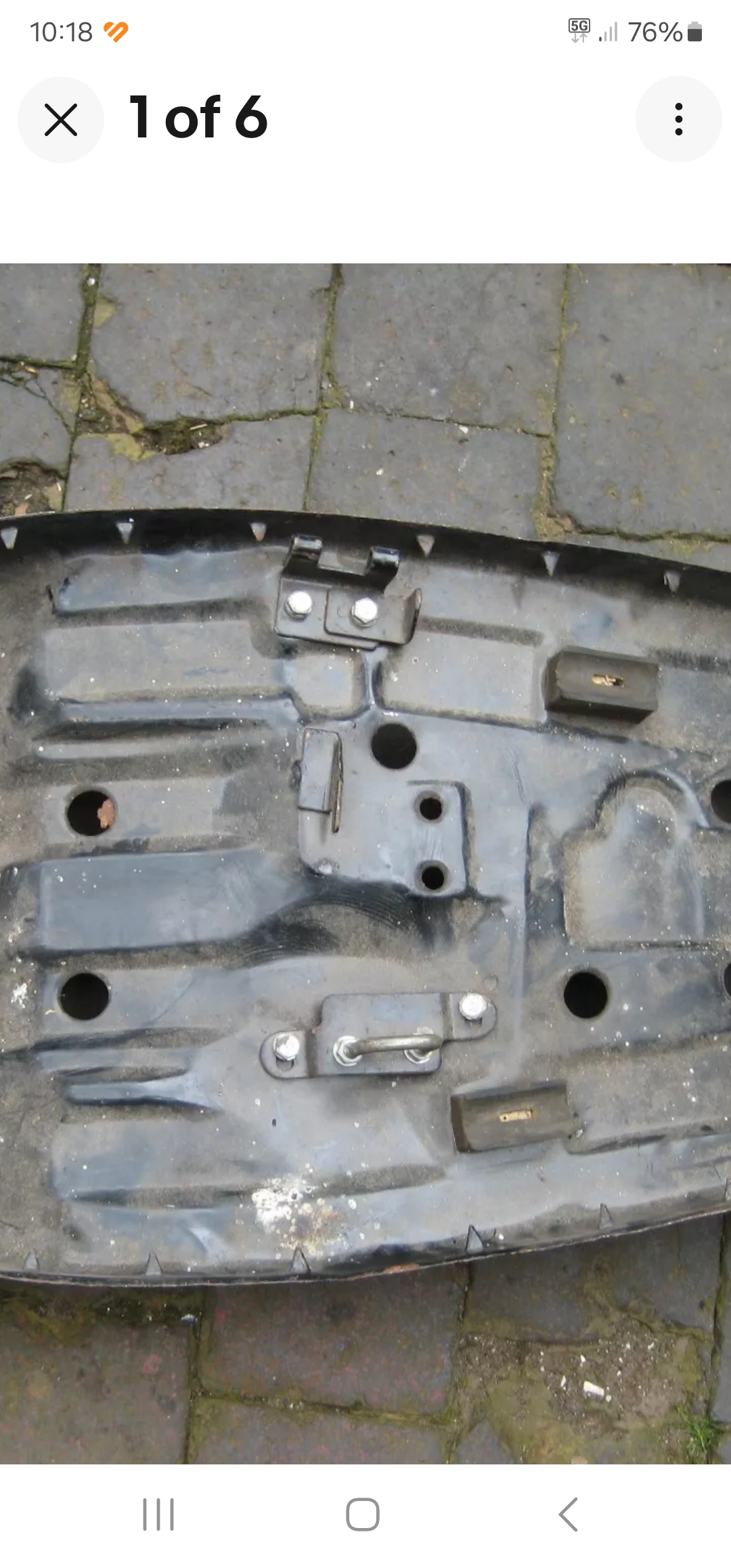

Re: Z1000 A2 seat
Sure you wont need it, but good luck.
Here is photo i used as guide when fitting bracket it helped to confirm its position, it may help you too.
