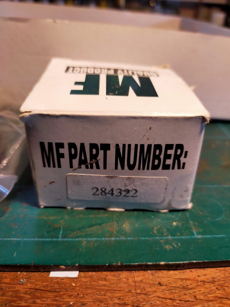

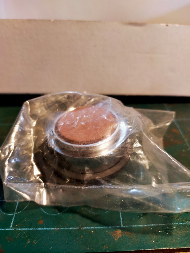

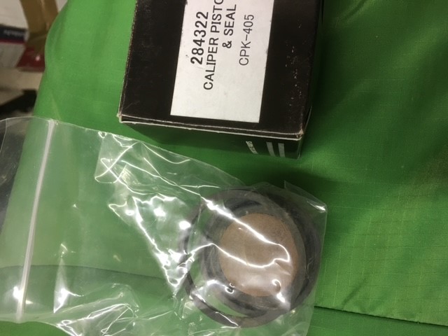

Folks
Bought these MF pistons code 284322 for 1977 Z1000 a few years back.
No trace of them on the internet. Can anyone confirm they are correct please. They are 43 x 22mm

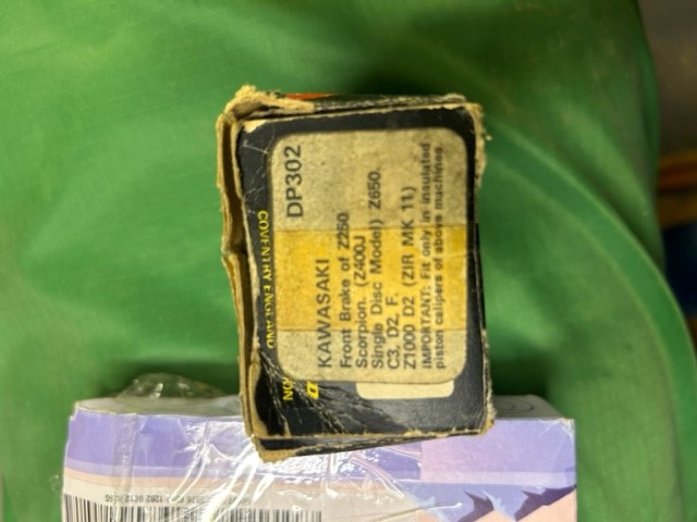

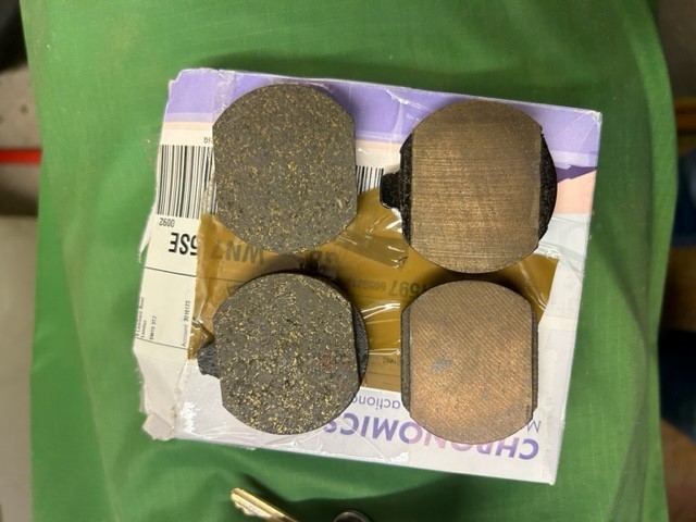

there solid pistons for sintered pads or full metal !!!

YES CORRECT
