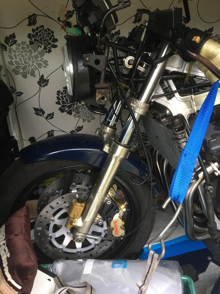

My 1000 with zx9 forks and zrx swingers . I am an hour north of you if you want to see the bike or get any information .

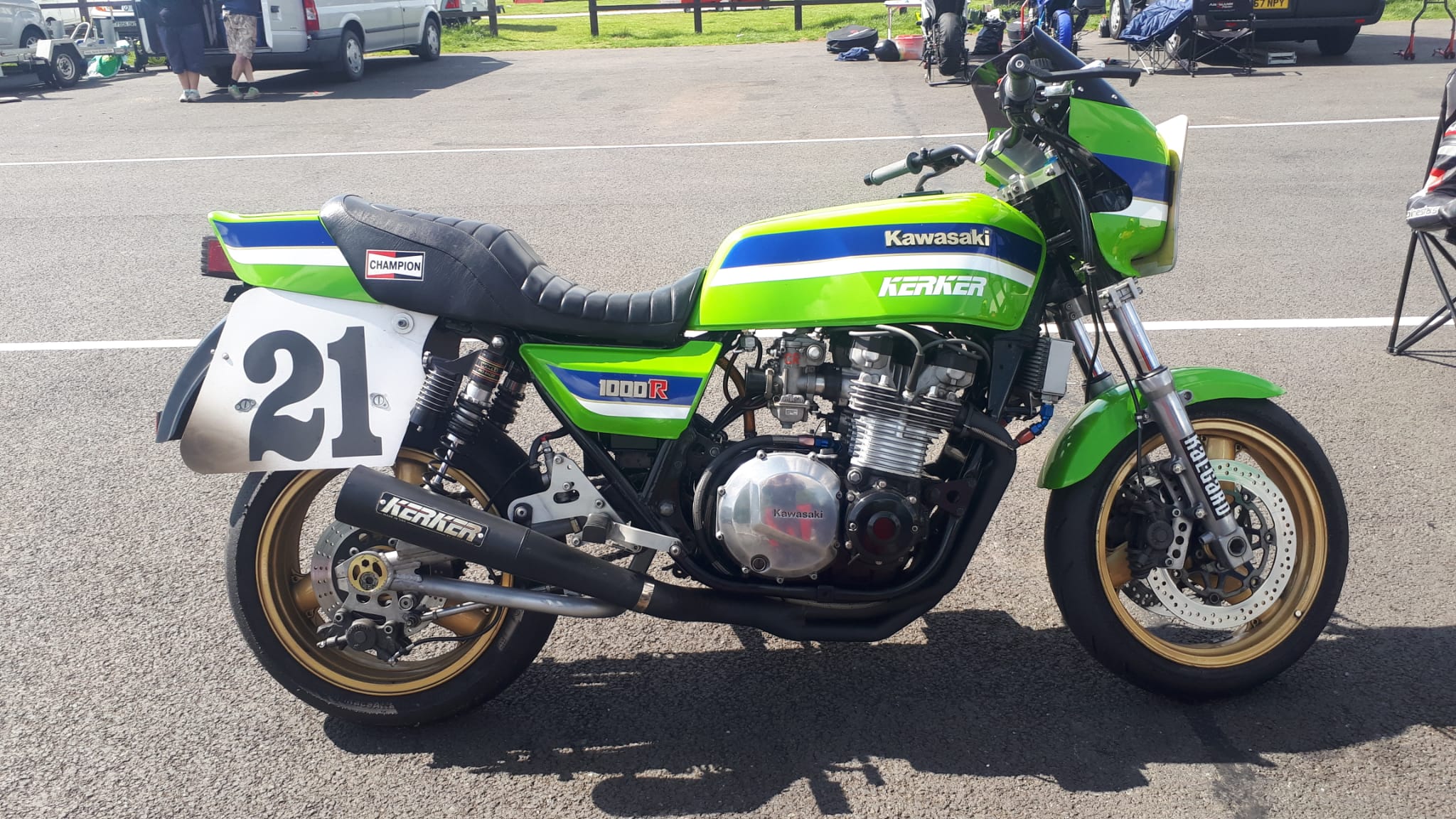

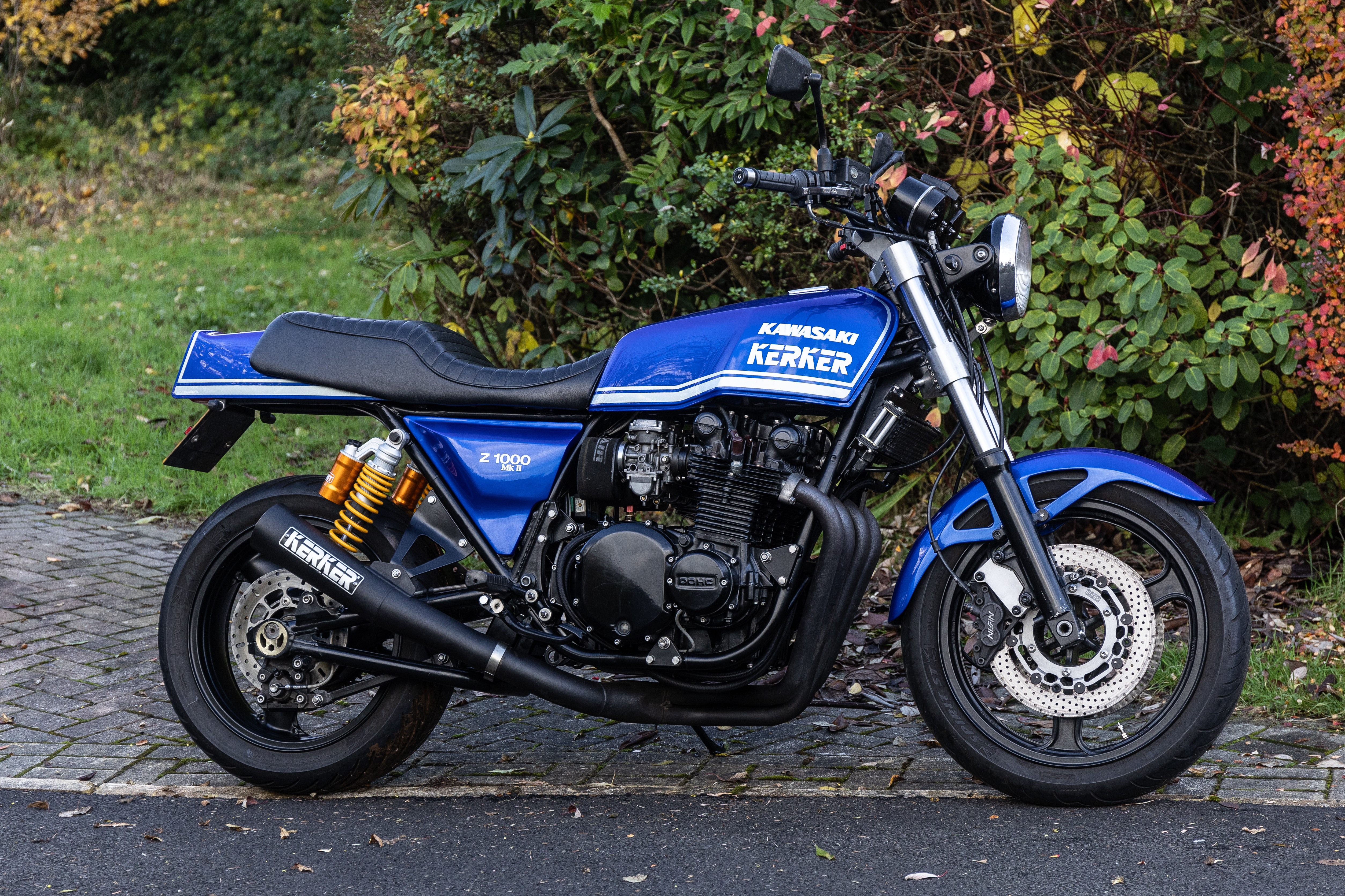

Just measured 3 of our bikes . Top of fork to centre of front wheel spindle .
ZRX1100 29 1/4"
z1000R2. 31 3/8"
z1000 with zx9 forks 29 1/2"
z1000 has a stepped top yoke to allow the forks to drop through to give more ground clearance .
All bike were on the side stand .
